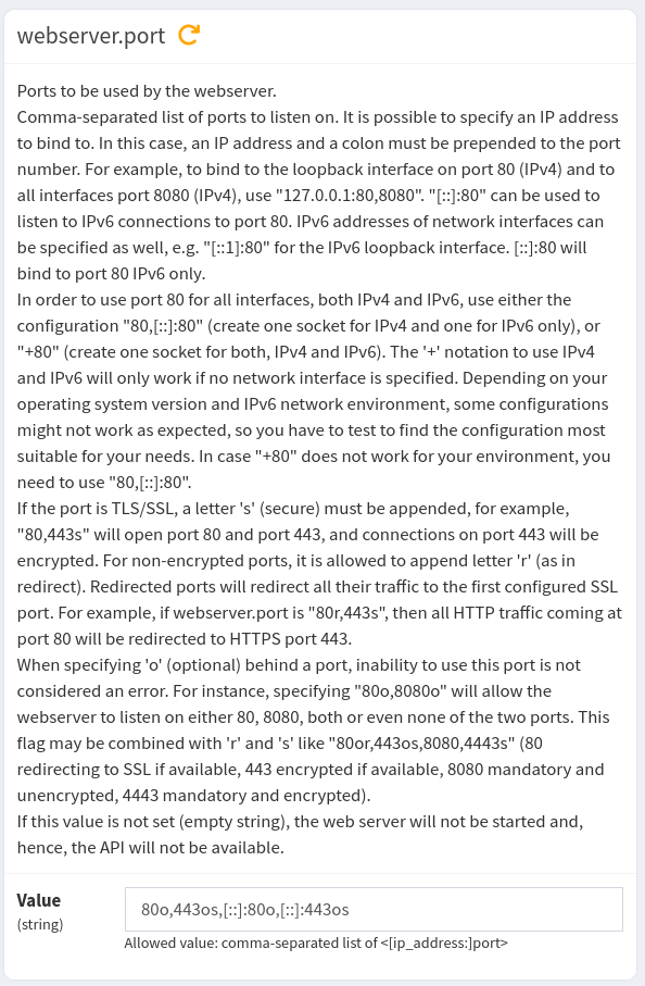

You can do that with Pi-hole. In the UI it's in settings -> expert -> all settings -> webserver and api, webserver.port
It is the default, but is also easily changed:

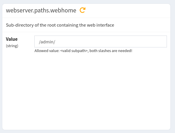

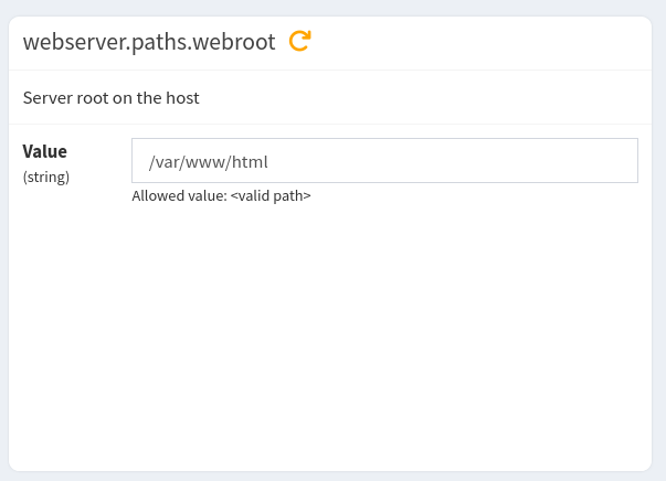

webserver.paths.webroot, and webserver.paths.webhome in the same tab as above.
They can also be set directly in /etc/pihole.toml.
