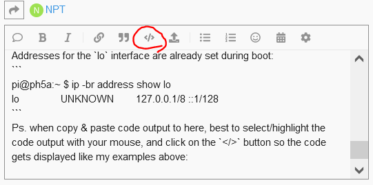

Ps. when copy & paste code output to here, best to select/highlight the code output with your mouse, and click on the </> button so the output gets displayed like in my examples above:
