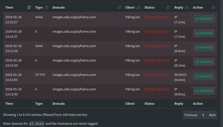

I am seeing queries and blocks on the server:
Jan 19 18:57:35: query[HTTPS] static.narrativ.com from 192.168.4.41 **
Jan 19 18:57:35: gravity blocked static.narrativ.com is NODATA** **
Jan 19 18:57:35: query[A] static.narrativ.com from 192.168.4.41** **
Jan 19 18:57:35: gravity blocked static.narrativ.com is 0.0.0.0**
I have also now installed unbound to run alongside pi-hole. Perhaps I should resolve my issue first?

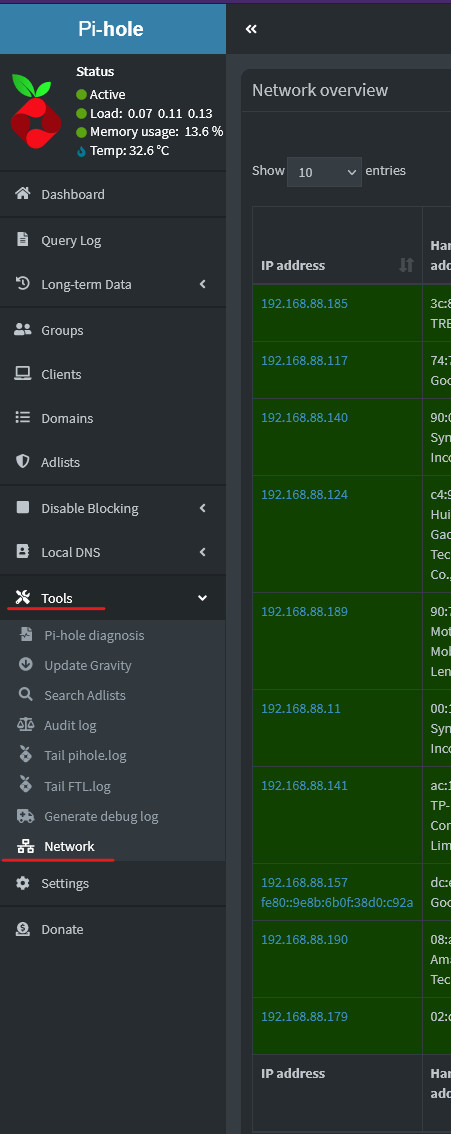

Do you see clients on the admin display now?
How does your Network panel look?

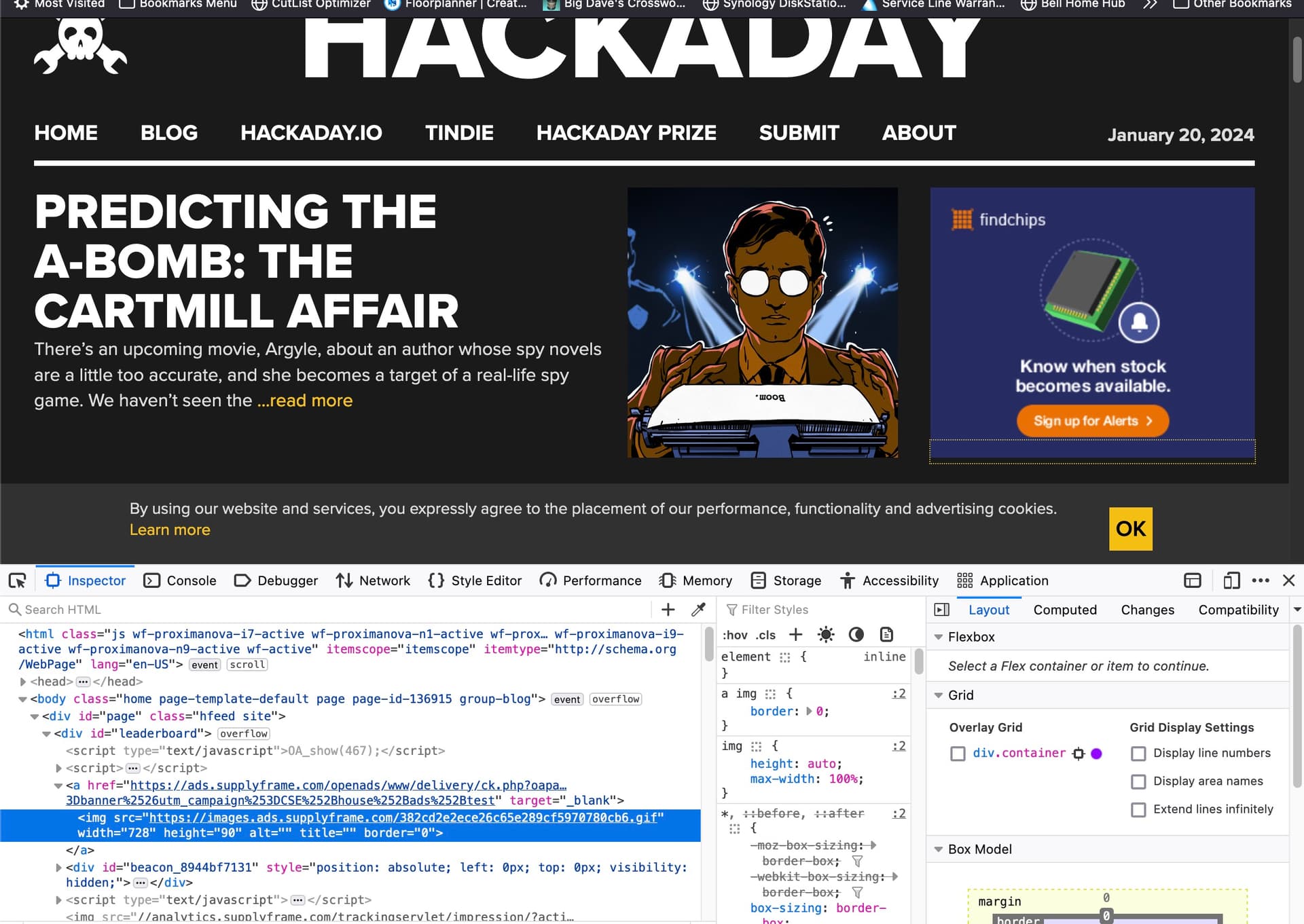

I flushed DNS caches and cleared the cache in my browser (Firefox) then opened up the hackaday.com website. Pi-hole shows it is blocking several urls including images.ads.supplyframe.com but I am still seeing ads on the hackaday.com web page.
Maybe it's a cached image.

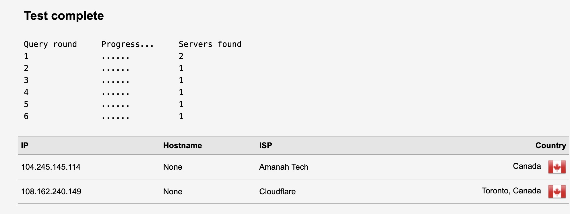

Try running the Extended test at DNS leak test using the same browser and setup. You're not really testing for leaks in this scenario but it's useful for showing which DNS servers are responding from the browser's point of view. It may reveal the presence of a setting somewhere which is allowing the browser to resolve the image domain via another server (if not cached as rdwebdesign points out).
If you're using Pi-hole you should only be seeing the chosen upstream servers. If that is Unbound then you should see your own public IP (since that's how the Internet will see any traffic from your Unbound, same as any other traffic from your LAN).

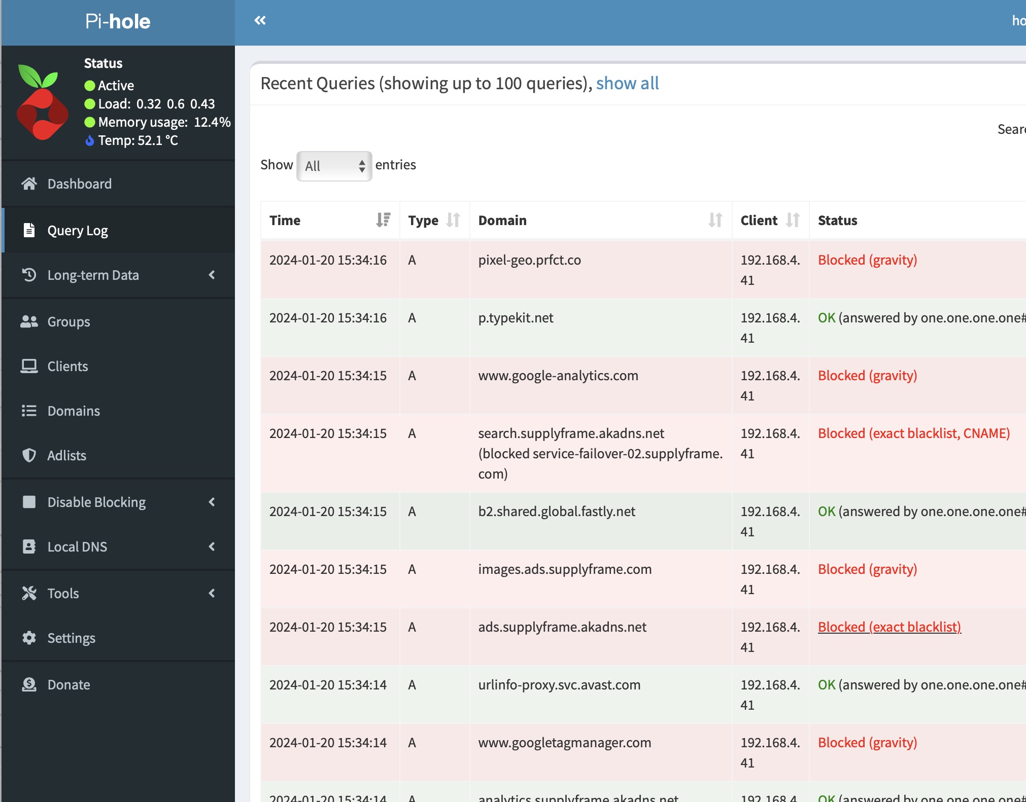

I ran tail on the pihole.log, went to hackaday.com and saw:
Jan 20 17:02:58: query[A] uib.ff.avast.com from 192.168.4.41
Jan 20 17:02:58: gravity blocked uib.ff.avast.com is 0.0.0.0
Jan 20 17:02:58: query[A] analytics.supplyframe.com from 192.168.4.41
Jan 20 17:02:58: gravity blocked analytics.supplyframe.com is 0.0.0.0
Jan 20 17:02:58: query[A] www.googletagmanager.com from 192.168.4.41
Jan 20 17:02:58: gravity blocked www.googletagmanager.com is 0.0.0.0
Jan 20 17:02:58: query[A] stats.wp.com from 192.168.4.41
Jan 20 17:02:58: gravity blocked stats.wp.com is 0.0.0.0
Jan 20 17:02:58: query[A] ads.supplyframe.com from 192.168.4.41
Jan 20 17:02:58: gravity blocked ads.supplyframe.com is 0.0.0.0
Jan 20 17:02:59: query[A] images.ads.supplyframe.com from 192.168.4.41
Jan 20 17:02:59: gravity blocked images.ads.supplyframe.com is 0.0.0.0
Jan 20 17:02:59: query[A] tag.perfectaudience.com from 192.168.4.41
Jan 20 17:02:59: gravity blocked tag.perfectaudience.com is 0.0.0.0
Jan 20 17:02:59: query[A] search.supplyframe.com from 192.168.4.41
Jan 20 17:02:59: gravity blocked search.supplyframe.com is 0.0.0.0
Jan 20 17:02:59: query[A] www.google-analytics.com from 192.168.4.41
Jan 20 17:02:59: gravity blocked www.google-analytics.com is 0.0.0.0
Jan 20 17:02:59: query[A] pixel.wp.com from 192.168.4.41
Jan 20 17:02:59: gravity blocked pixel.wp.com is 0.0.0.0
But I am still seeing the ads on the hackady.com website
I got the following:
Does either of those match your Pi-hole upstream server(s)?
Firefox has DNS over HTTPS enabled as default using Cloudflare. It's in Settings > Privacy & Security > DNS over HTTPS at the bottom (or search for DNS in the Settings). Turn it Off to ensure all DNS is going to your OS-configured resolver, ie Pi-hole.
Was it set on? If so and you're turned it off, try running the leak test again. That Cloudflare entry should be gone (assuming it came from Firefox). Is that other setting your configured upstream (or your IP if you're running Unbound)?
If it's all good then the domain lookup on Hackaday should expire and result in a box saying unable to connect to that *.supplyframe.com domain.
Note you should test using a Private window, or if you've tested using a normal window, clear the cache and cookies and then switch to testing with a Private window, to avoid earlier downloads from tainting current results.

If you run the Leak test again you should be seeing just your Pi-hole upstream servers or your own IP for Unbound, that will confirm no sneaky OS or application settings lingering on.

I ran the leak test again and as you predicted I only saw my own IP.
