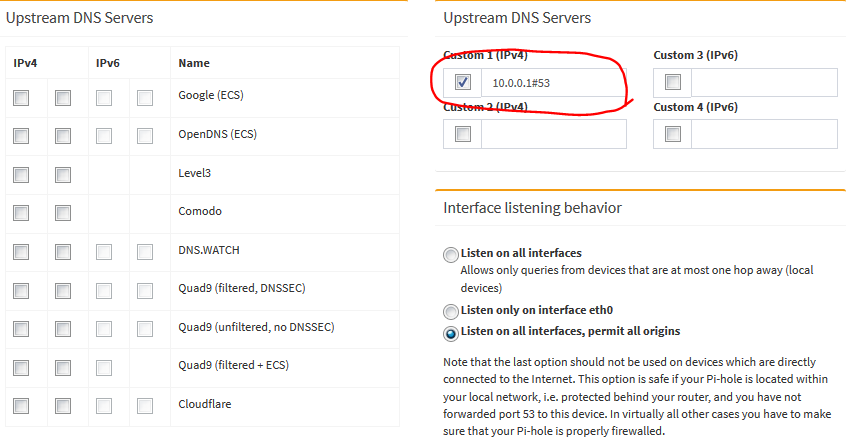

The config points the dnsmasq/pihole-FTL to the unbound port as the upstream nameserver.

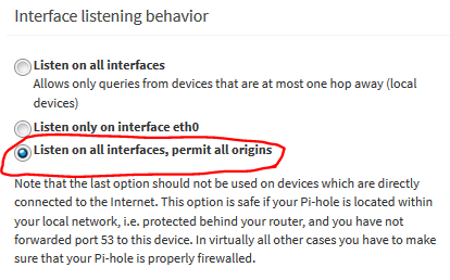

Try set below in Pi-hole settings:
That will change directive interface=XXX into except-interface=nonexisting in the file /etc/dnsmasq.d/01-pihole.conf.
That way you can add interface directive to your own config file eg:
pi@noads:~ $ cat /etc/dnsmasq.d/99-my-settings.conf
bind-interfaces
listen-address=127.0.0.1,::1,10.0.0.2,fe80::2113:xxx:xxx:5fb
interface=dummy0

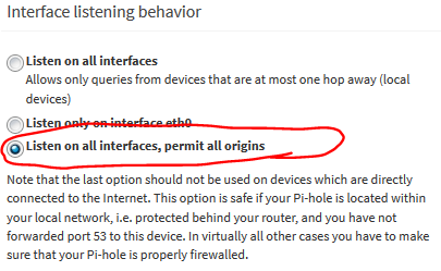

Unfortunately its not a fix. I've tried all three options, none function correctly.
However it points towards the root of the issue I believe.
I have dnsmasq version 2.79, standard distribution of raspbian. It works, as in can co-exist with other name servers on other interfaces on the same box.
I've spent all day building a dnsmasq version 2.80, with the same compile time options as the raspbian stock. It works as well. This is the root of the pihole-FTL fork.
pihole-FTL fails with all the options on that radio button.
So there is diverging code in the pihole-FTL implementation, to make those selection options available from the gui. Presumably that selection overrides the settings in dnsmasq.conf that
set the bind-interfaces directive, which is what is needed to allow co-existance with other name servers.
Can anyone point me to where those options are handled in the pihole-FTL code please?

Are you sure you can't configure a single upstream DNS server ?
pi@noads:~ $ grep PIHOLE_DNS /etc/pihole/setupVars.conf
PIHOLE_DNS_1=10.0.0.1#53
pi@noads:~ $ grep server= /etc/dnsmasq.d/01-pihole.conf
server=10.0.0.1#53

If I set this one to listen to all:
pi@noads:~ $ grep DNSMASQ_LISTENING /etc/pihole/setupVars.conf
DNSMASQ_LISTENING=all
I get what I expected:
pi@noads:~ $ sudo netstat -nltup | grep 'Proto\|:53 '
Proto Recv-Q Send-Q Local Address Foreign Address State
tcp 0 0 127.0.0.1:53 0.0.0.0:* LISTEN 18285/pihole-FTL
tcp 0 0 10.0.0.2:53 0.0.0.0:* LISTEN 18285/pihole-FTL
tcp6 0 0 fe80::2113:33ca:4a85:53 :::* LISTEN 18285/pihole-FTL
udp 0 0 127.0.0.1:53 0.0.0.0:* 18285/pihole-FTL
udp 0 0 10.0.0.2:53 0.0.0.0:* 18285/pihole-FTL
udp6 0 0 fe80::2113:33ca:4a85:53 :::* 18285/pihole-FTL
This DNSMASQ_LISTENING directive can be set in the admin GUI below:
