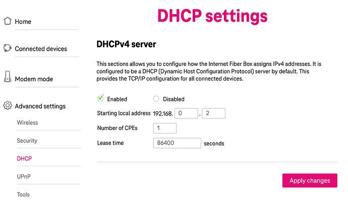

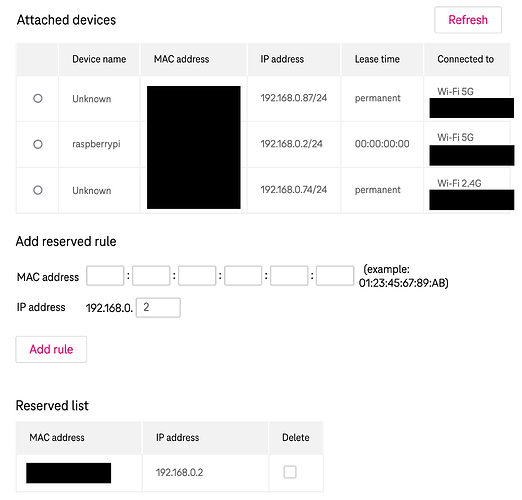

  • Then, I followed some tips from other threads on this forum, set the Pi's IP to 192.168.0.2 (permanently assigned), activated DHCP on the modem/router starting at 192.168.0.2 with a range of 1 (router is 192.168.0.1, as usual). This way, the Pi has its IP handled by the DHCP of the modem/router and all other devices have to rely on the Pi's DHCP. On the screenshot, we see other devices; my guess is that these are devices for whom the lease has not expired (although it says "permanent" and I am not sure why and I can't change it);

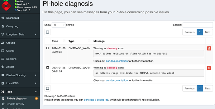

  • I also get two errors in the "Pi-Hole diagnosis":

Configure router DHCP range
You might find it useful to split the 254 addresses between the router and the Pi-hole. That way they won't give out each other's range if you have to switch between them. You'll have around 120 available address if you use this approach. To do this:
  • Ideally take all devices off the network temporarily. This will allow them to pick up fresh addresses shortly and will avoid any potential IP conflicts during this setup.
  • In the router set the start address as 192.168.0.140. Set the number of addresses as 115. This will cause the router to be handing out address from 192.168.0.140 to 192.168.0.254. Once this is saved you can disable the router's DHCP. Presumably if you enable it later on, it remembers these numbers. If not, make a note of them so you can re-enter them.

Regarding those permanent leases, it means they were allocated with no TTL set. There must be some way to delete them from the list. Perhaps changing the DHCP range in the earlier step will flush them. Check the manual for the router. If not, I'd ignore them and see if they ever become a problem.
