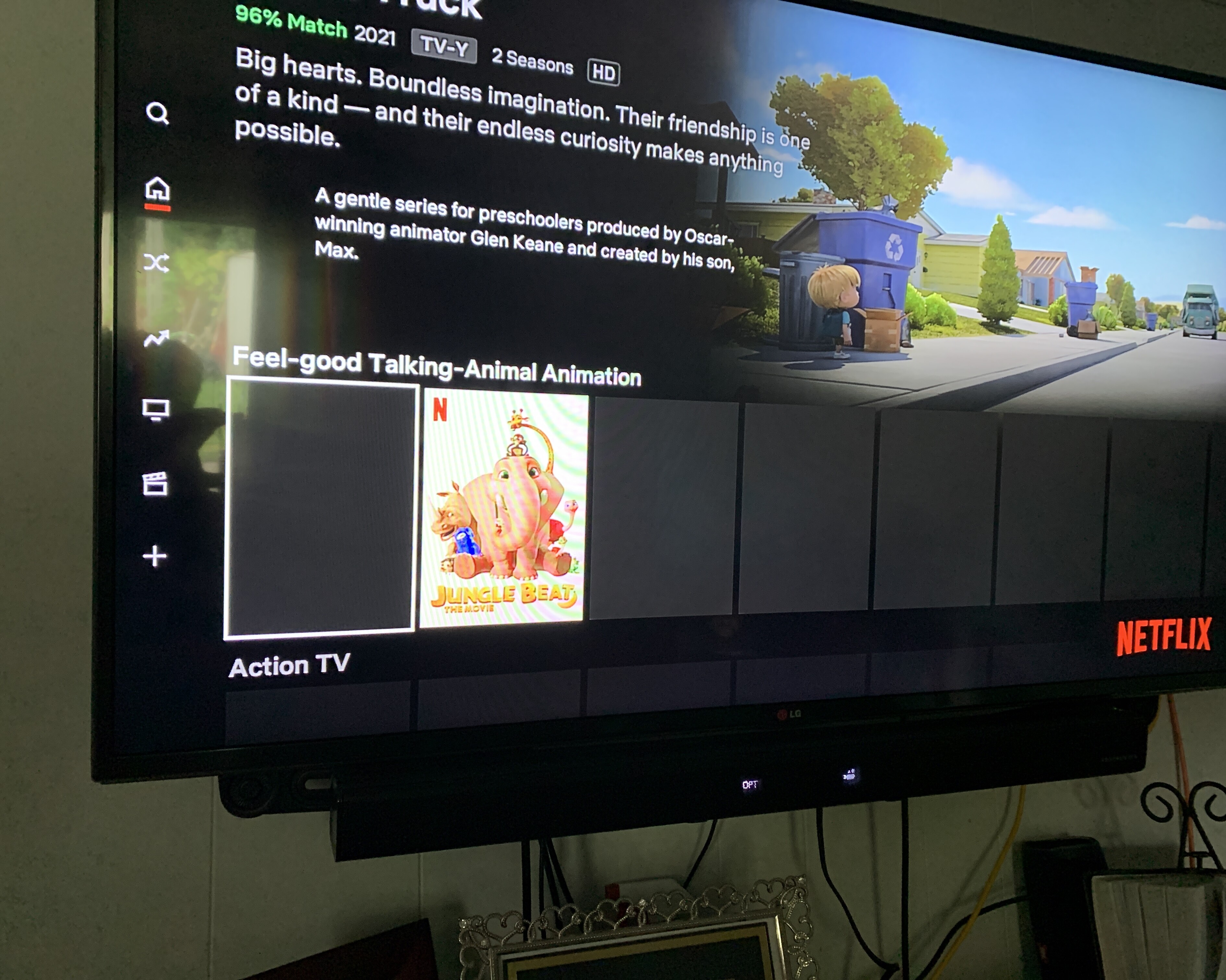

I'm running two PI's with standard ad list running as recursive using unbound. Lan clients use the PI's as DNS. This was a recent change. When I start my Roku device it loads fine no problems. When I start any of the streaming apps like Netflix, HBO Max etc... they load but no movie thumbnails show up and they do not stream any movies if I try and play them. To test all i did was add 8.8.8.8 and primary on the LAN and after I restarted the Roku with the new LAN settings everything started working. Not sure why the PI is blocking these apps from playing content. It is also blocking websites I normally visit or some of the clients visit.

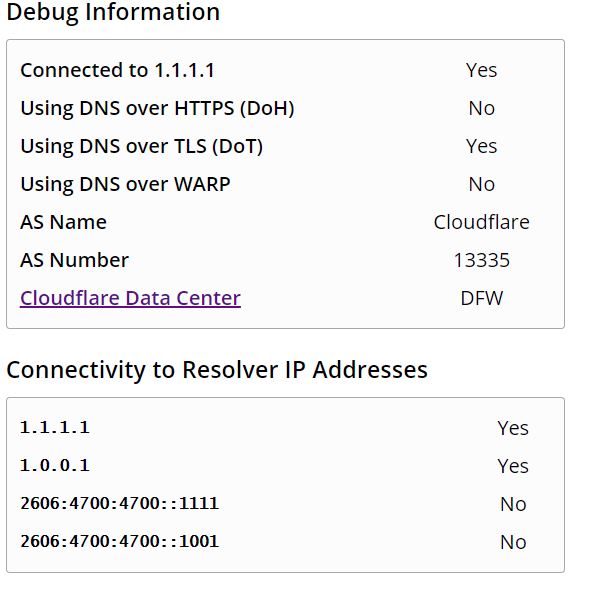

The moment I dig with @1.1.1.1 I am able to go to the website no problems until the record goes stale and I can't reach site. Only other thing is it will not work on subdomains i get same nxdomain error. for example navigating to tabs.ultimate-guitar.com.
