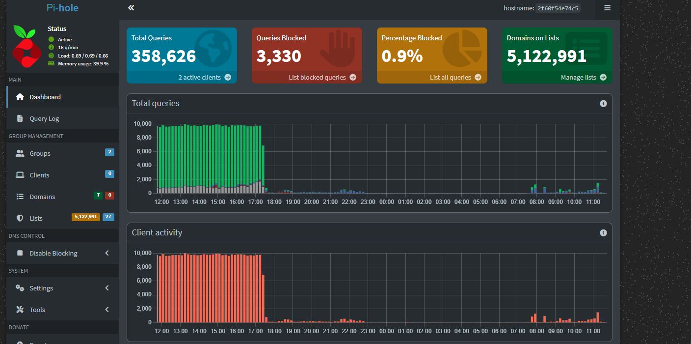

been running pihole on my Nas for a while using the YAML file below. I also run TailScale on the same nas which is set as myexit node, “was told thast would send all inquiries through pihole. Lately I haven’t notice issues other than the blocked percentage is below 1 percent when it was way higher before, like 30-50%. If included the YAML I’m using below along with a screen grab of the pihole dashboard.

That drop from 30-50% to basically nothing suggests your DNS queries probably aren't going through Pi-hole at all. Setting Tailscale as an exit node is different from pointing your clients to Pi-hole as the DNS server — might be worth checking where your queries are actually resolving.
