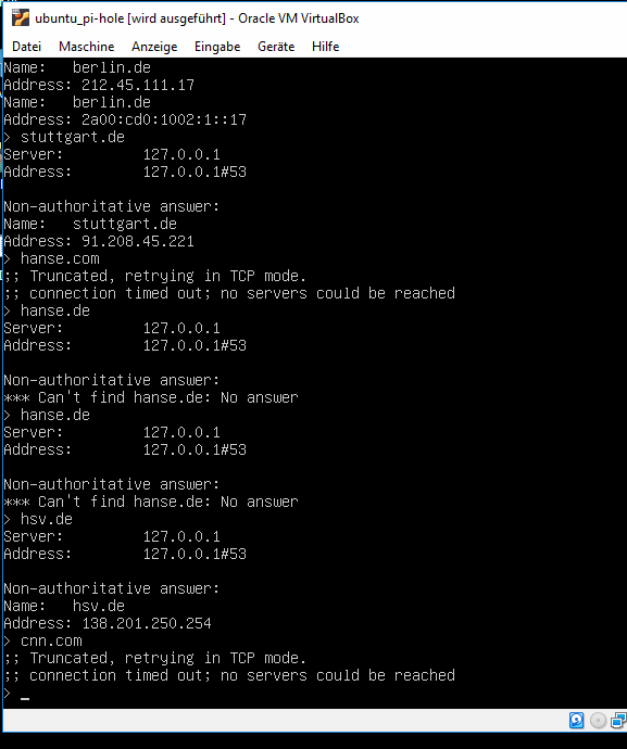

It takes a while but now the problem occurs again... om the pi-hole server himself the delay is unclearl! i test several domains, some (i think cached) answers come fast, others takes seconds or minutes and i have some answers with "truncated, retrying in tcp mode" --> seee the screenshot, the second shows the machine status... i have to repeat the questioin several times to get an answer...
in the query log i can see many NODATA or N/A entries, the webgui needs also minutes to load... i cannot generate debug logs, it takes too long...so i have to reboot the server now... :frowning:

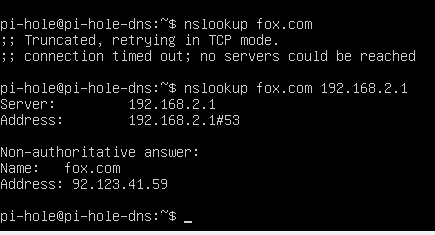

Please also run
nslookup google.de 192.168.2.1
and
nslookup google.de 1.1.1.1
@DL6ER

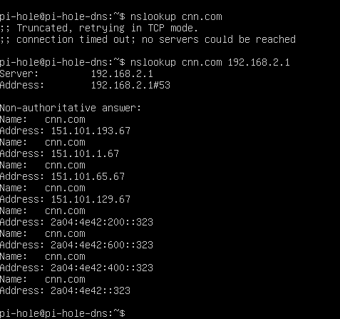

Both answers come fast, i do another test with cnn.com - the first with the fritzbox as dns --> answer come fast, the second with the pi-hole as dns --> timeout --> see the picture...

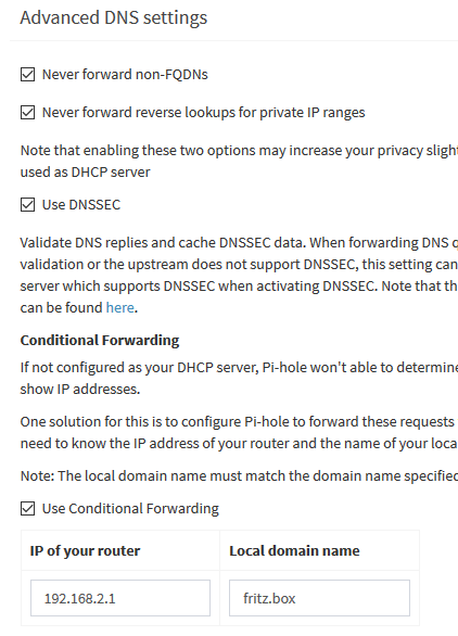

I see you're using DNSSEC. Does the problem persist when you disable this feature in Pi-hole?
After 10 minutes i have also the debug logs..
46j1zagrjy
Also try disabling conditional forwarding as it is not needed when your router is configured as your only upstream destionation.
Disabled both and restart the DNS resolver --> no luck...

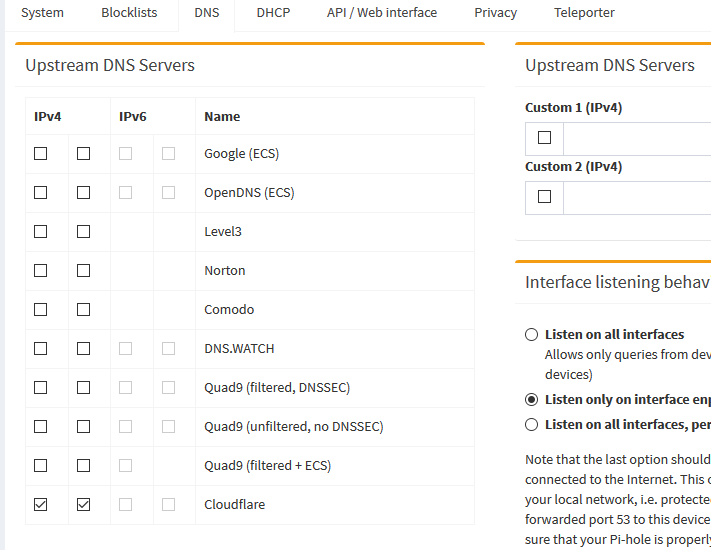

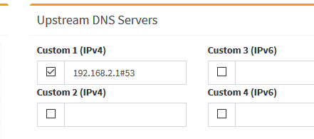

Please try once to configure another DNS server (e.g. Quad9), just not your router, as forward destination just to ensure that it is really a Pi-hole issue and not a Pi-hole<->router issue.
try it and restart the dns resolver... same result... see pictures... by the way... many many thanks for your support!

Jan 6 11:00:52 dnsmasq[31435]: dnssec-query[DS] fox.com to 192.168.2.1
Jan 6 11:01:02 dnsmasq[950]: query[A] fox.com.fritz.box from 192.168.2.42
Jan 6 11:01:02 dnsmasq[950]: forwarded fox.com.fritz.box to 192.168.2.1
Jan 6 11:01:02 dnsmasq[950]: reply fox.com.fritz.box is NXDOMAIN
Jan 6 11:01:02 dnsmasq[950]: query[AAAA] fox.com.fritz.box from 192.168.2.42
Jan 6 11:01:02 dnsmasq[950]: query[A] fox.com from 192.168.2.42
Jan 6 11:01:02 dnsmasq[950]: forwarded fox.com to 192.168.2.1
Jan 6 11:01:02 dnsmasq[950]: reply fox.com is 92.123.41.59
Jan 6 11:01:04 dnsmasq[31441]: dnssec-query[DS] fox.com to 192.168.2.1
Jan 6 11:01:09 dnsmasq[31444]: dnssec-query[DS] fox.com to 192.168.2.1
Jan 6 11:01:22 dnsmasq[31435]: reply fox.com is no DS
Jan 6 11:01:22 dnsmasq[31435]: reply fox.com is 92.123.41.59
Jan 6 11:01:34 dnsmasq[31441]: reply fox.com is no DS
Jan 6 11:01:34 dnsmasq[31441]: reply fox.com is 92.123.41.59
Jan 6 11:01:35 dnsmasq[950]: query[A] fox.com from 127.0.0.1
Jan 6 11:01:35 dnsmasq[950]: forwarded fox.com to 192.168.2.1
Jan 6 11:01:35 dnsmasq[950]: reply fox.com is 92.123.41.59
Jan 6 11:01:39 dnsmasq[31444]: reply fox.com is no DS
Jan 6 11:01:39 dnsmasq[31444]: reply fox.com is 92.123.41.59
Jan 6 11:01:39 dnsmasq[31604]: query[A] fox.com from 127.0.0.1
Jan 6 11:01:39 dnsmasq[31604]: forwarded fox.com to 192.168.2.1
Jan 6 11:01:51 dnsmasq[31615]: query[A] fox.com from 127.0.0.1
Jan 6 11:01:51 dnsmasq[31615]: forwarded fox.com to 192.168.2.1
Jan 6 11:01:56 dnsmasq[31618]: query[A] fox.com from 127.0.0.1
Jan 6 11:01:56 dnsmasq[31618]: forwarded fox.com to 192.168.2.1
Jan 6 11:02:09 dnsmasq[31604]: dnssec-query[DS] fox.com to 192.168.2.1
Jan 6 11:02:12 dnsmasq[31628]: query[A] fox.com from 192.168.2.42
Jan 6 11:02:12 dnsmasq[31628]: forwarded fox.com to 192.168.2.1
Jan 6 11:02:21 dnsmasq[31615]: dnssec-query[DS] fox.com to 192.168.2.1
Jan 6 11:02:26 dnsmasq[31618]: dnssec-query[DS] fox.com to 192.168.2.1
Jan 6 11:02:39 dnsmasq[31604]: reply fox.com is no DS
Jan 6 11:02:39 dnsmasq[31604]: reply fox.com is 92.123.41.59
Jan 6 11:02:42 dnsmasq[31628]: dnssec-query[DS] fox.com to 192.168.2.1
Jan 6 11:02:51 dnsmasq[31615]: reply fox.com is no DS
Jan 6 11:02:51 dnsmasq[31615]: reply fox.com is 92.123.41.59
Jan 6 11:02:56 dnsmasq[31618]: reply fox.com is no DS
Jan 6 11:02:56 dnsmasq[31618]: reply fox.com is 92.123.41.59
Jan 6 11:03:12 dnsmasq[31628]: reply fox.com is no DS
Jan 6 11:03:12 dnsmasq[31628]: reply fox.com is 92.123.41.59
Jan 6 11:03:12 dnsmasq[950]: query[AAAA] fox.com from 192.168.2.42
Jan 6 11:03:12 dnsmasq[950]: forwarded fox.com to 192.168.2.1
Jan 6 11:03:12 dnsmasq[950]: reply fox.com is NODATA-IPv6
Jan 6 11:03:30 dnsmasq[31674]: query[AAAA] fox.com from 192.168.2.42
Jan 6 11:03:30 dnsmasq[31674]: forwarded fox.com to 192.168.2.1
Jan 6 11:04:00 dnsmasq[31674]: dnssec-query[DS] fox.com to 192.168.2.1
Jan 6 11:04:30 dnsmasq[31674]: reply fox.com is no DS
Jan 6 11:04:30 dnsmasq[31674]: reply fox.com is NODATA-IPv6
try to use antoher domain like netflix.com (at the moment we cannot stream from netflix on our tv because of the pi-hole problem)... from the pi-hole or any client in my network... when i ask pi-hole dns --> timeout, no servers could be reached on the pi-hole himself or 2-3 minutes for an answer on a client and when i try to ask my router the answer comes in ms!
And again i can see many NODATA or N/A entries in the query log...
@DL6ER
After reboot all is working now again, dns queries to the pi-hole answered fast - i think it takes between 5-10 hours and the problem occours again... hope it will be a solution for this...
Your computer asks for additional domains that don't exist (pay attention to the fritx.box part):
It is correct for these queries to come back as NXDOMAIN.
Jan 6 11:00:39 dnsmasq[31444]: query[A] fox.com from 127.0.0.1
Jan 6 11:00:39 dnsmasq[31444]: forwarded fox.com to 192.168.2.1
Here, DNSSEC is still being used! Please ensure once again that you disabled it. The log snippet you posted contains only lines where DNSSEC was enabled.
