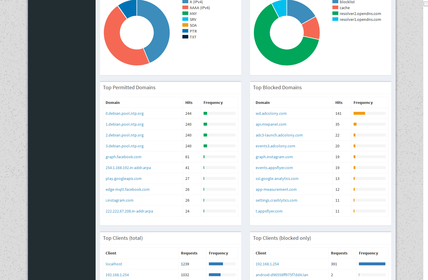

This shows that every query was correctly resolved by the upstream resolvers. If this is an intermittent issue, it may be a problem with the upstream resolvers. My first troubleshooting step would be to switch upstream resolvers.

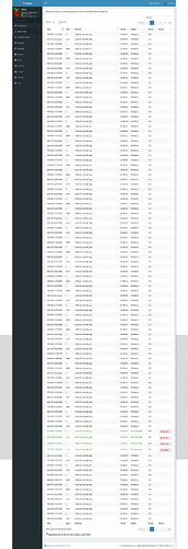

But notice in this screen capture that it resolves 2.debian.pool.ntp.org and 5s later (a dozen NTP resolving requests later) it reports the same tertiary subdomain as unknown.
This image is to show frequency of requests, .254 is my router:
I'm not sure why the query log is showing that. Do you see matching behavior at those times in /var/log/pihole.log and /var/log/pihole.log.1
240 requests to each of the 5 ntp servers in 24 hours isn't excessive.
Don't you think I need to find why pihole and router are hammering out requests for resolution of the same 5 NTP servers at a rate of 500 per hour? Why aren't they cached by the pihole? 5s seems too short for TTL, why would the pihole be going to the upstream server again after such a short time?
Can I force caching of the servers regardless of the TTL DNS reports? Can I make the pihole return the result of pool.ntp.org or uk.pool.ntp.org queries instead of the requested N.debian.pool.ntp.org subdomains?
Sorry, lots of questions, thanks for your help.
[Apologies too if stats aren't consistent with what you're seeing, I'm looking at different time ranges to what are in the specific images shown. I don't have full records.]

The snippet of pihole.log you posted shows a burst of requests every 45 minutes or so.
The image above of the "Recent Queries" page where the status is given as "Unknown" for the query of the N.debian.pool.ntp.org domains corresponds to parts like this in the pihole.log:
