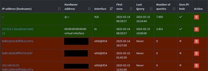

Strange ip and interfaces on pihole network, i don't understand
All device in eth0 and with a visible ip
there are eth0 and eth0@if14 that i don't what is and there is an entry with no ip and no interface
in pihole 6 i don't find that option.
Explanation of doubts:
Hi everyone, if I look at network I find things that I don't understand:
ip pihole is 192.168. 55.55 (in a docker).
eth0 is where all the devices of the network interface to the pihole.
  • What is "eth0@if14"?
  • Why is there an entry of "ip-::" at interface "N/A"?
I don't understand, can you explain to me please?
(I tried to attach the log, but in version 6 I can't find the entry export pihole.log anymore)
Thanks for your attention and for those who will want to answer me and explain to me

eth0@if14 is the name of the interface inside your docker container.
If you execute ip address inside the container you will see only lo and eth0@if14. This is normal when using macvlan.
Try it:
docker exec -it <pihole-container-name-or-id> ip a
Don't see eth0@if14 in your suggest command...
And also what is entry ip-::?
Thanks a lot for giving to me you time and your knowledge
ip a
1: lo: <LOOPBACK,UP,LOWER_UP> mtu 65536 qdisc noqueue state UNKNOWN qlen 1000
    inet6 ::1/128 scope host
2: eth0@if14: <BROADCAST,MULTICAST,UP,LOWER_UP,M-DOWN> mtu 1500 qdisc noqueue state UP qlen 1000
    link/ether 26:90:6d:82:c9:7a brd ff:ff:ff:ff:ff:ff
    inet 192.168.55.55/25 scope global eth0
    inet6 fe80::2490:6dff:fe82:c97a/64 scope link
EDIT:
I see now if14 lol, thanks,
For the other queston?
Nobody can explain me:
Thanks!
:: is the IPv6 loopback address. For all devices for which Pi-hole does not get a MAC address (because there is no entry in the neight cache) it 'creates' a mock hardware address starting withip- and followed by the IP address.
See Understanding DNSSEC validation using Pi-hole's Query Log - #9 by DL6ER
