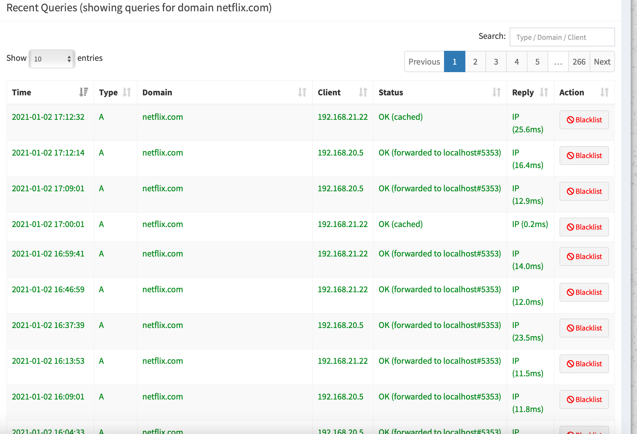

For some reason netflix.com was blacklisted initially (I'm using the pihole-updatelists gibhub repository for my adlists), and I noticed that there were hundreds of calls for netflix.com. It didn't appear to prevent me from accessing the service, but I found it strange that it was happening so frequently (like every 5 mins). Any idea why this is happening and if this is something I should be concerned about?

As to the flood of queries, it seems netflix.com has a TTL of 60 seconds. So the records will only stay in cache for 1 minute and then they will need to be resolved by the upstream.

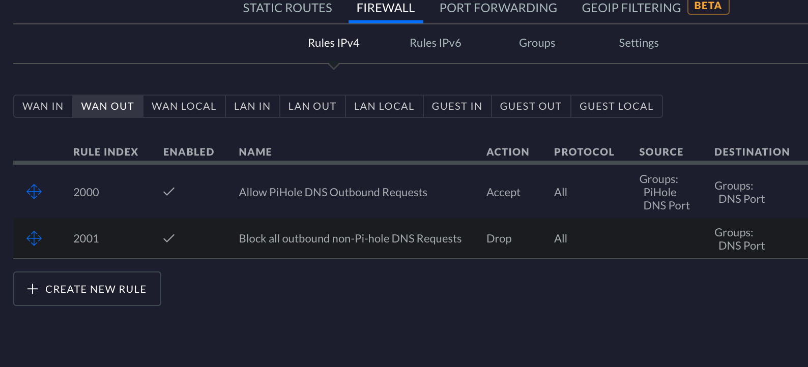

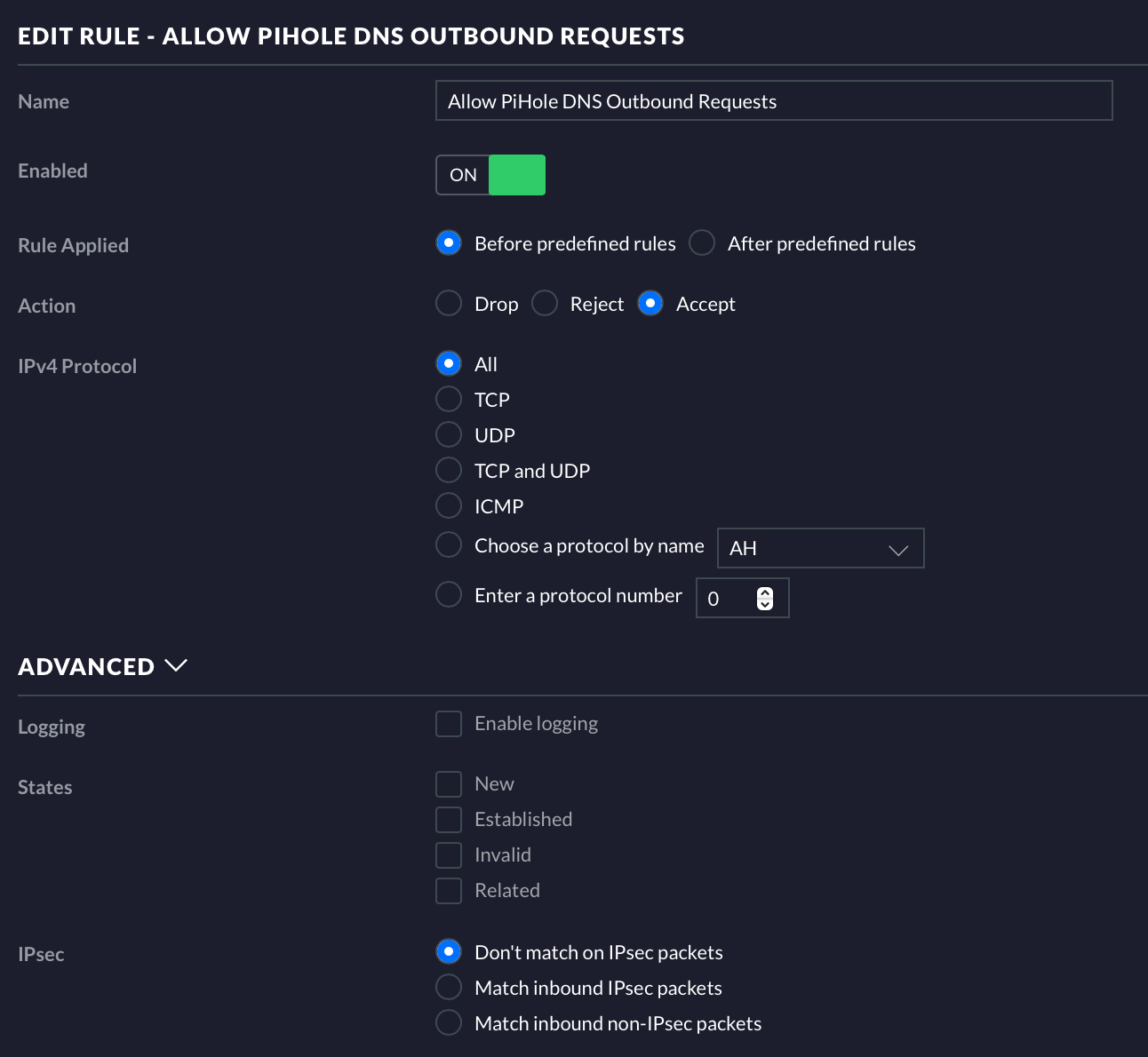

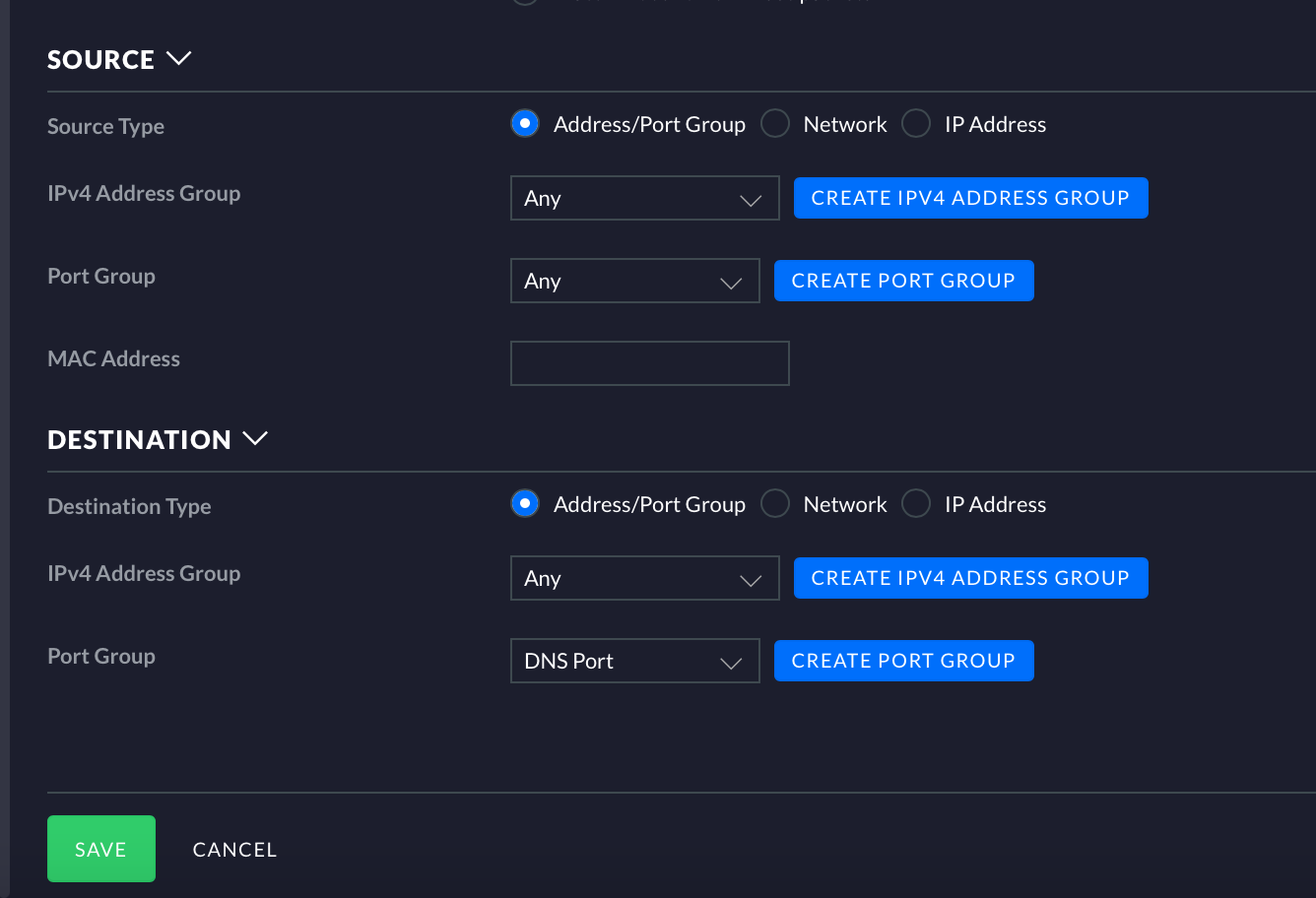

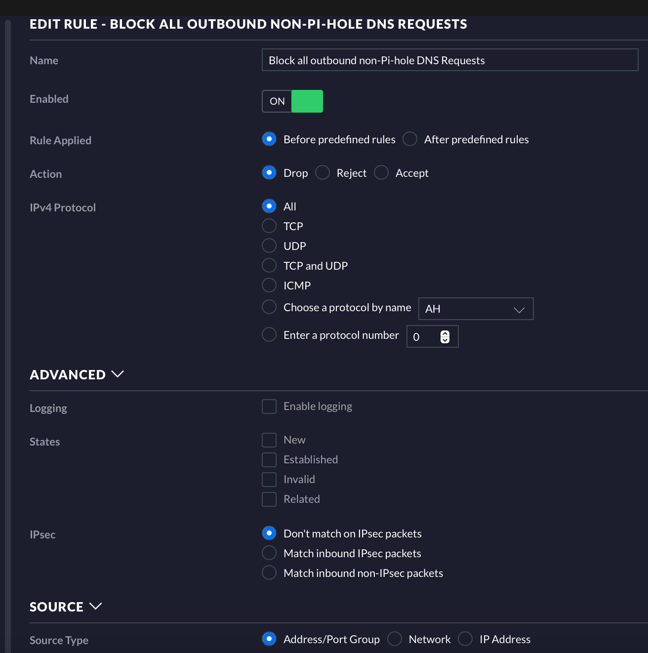

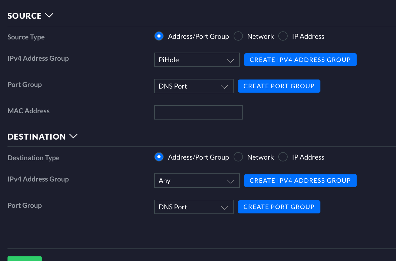

I do have some firewall rules to block all non-pihole DNS traffic:
