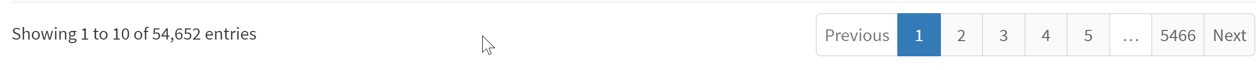

pihole, with MAXDBDAYS=365 (default) with that amount of queries per day, expierence troubles when searching the long term query data. The 365 days default is not a very good choice for a busy pihole, example here (not the only example). Question: anybody checking for a DNS query, dated 27/10/2020, given today is 26/10/2021?

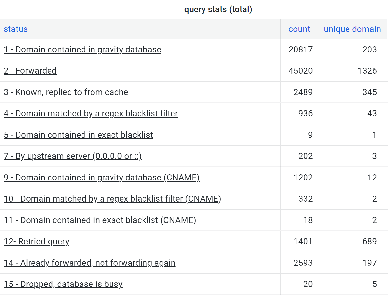

What does "significantly" want to say compared to the 50,000 queries I have seen on many posts here on the forum? More like 5,000 queries a day?

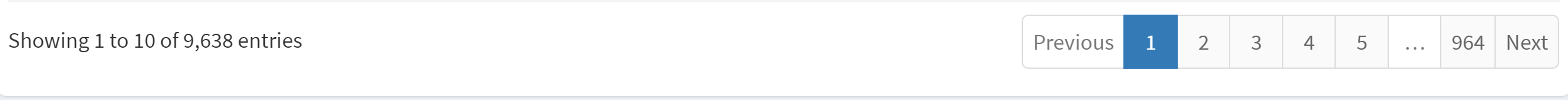

long term data yesterday
long term data last 7 days
  • 4 devices always on (24/7)
  • 2 devices on for about 12 hours / day
MAXDBDAYS= 8 (see what happend last week at the same time)
