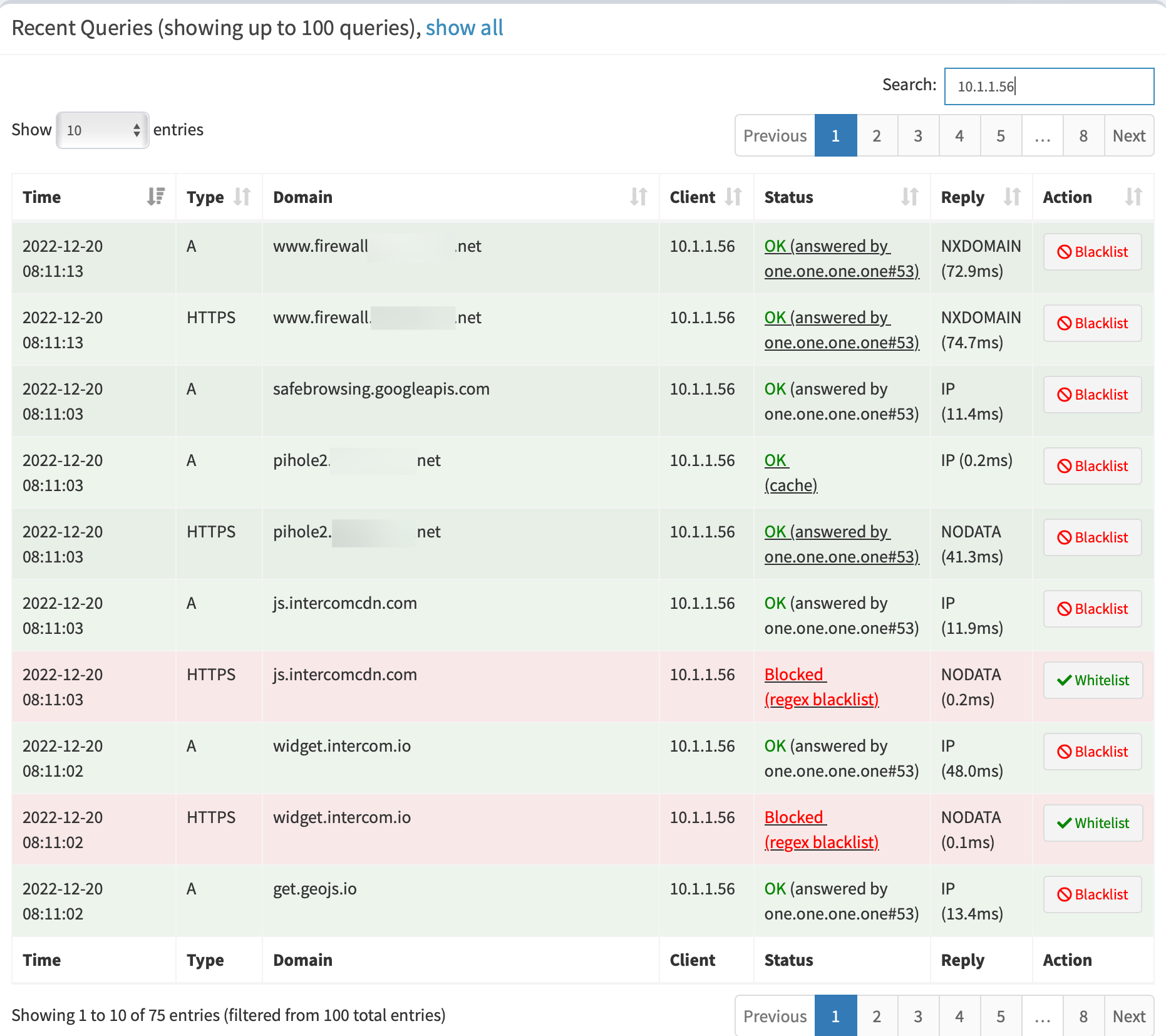

Please post a screen capture of your web admin GUI query log showing https requests from that client.
In this forum, you can directly paste or upload images into a reply.

I've entered the regex expression as shown in the screenshot below, perhaps I somehow typo'd it. I can see that the pi-hole is blocking some HTTPS requests but some are getting through... not sure why unless it's either that it is a subdomain or that since Pi-hole has a local DNS entry for the domain it is then honoring the other requests.
Mac seems to be requesting A AAAA and HTTPS for lots of things on the newer OS releases at least with Safari, terminal and some of the other tools.
