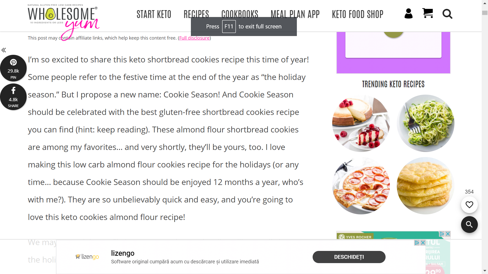

Pi-Hole is reporting 9.7% blocked queries but in practice I still see a lot of ads. In fact I cannot find a site that will display no ads at all - not sure if this is what I should expect?
The computer is reporting the Pi IP as DNS so it seems that the queries are going through Pi Hole.
I attach some screenshots.

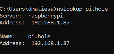

From a client that you believe should be connected to the Pi-Hole for DNS, from the command prompt or terminal on that client (and not via ssh or Putty to the Pi), what is the output of
nslookup pi.hole

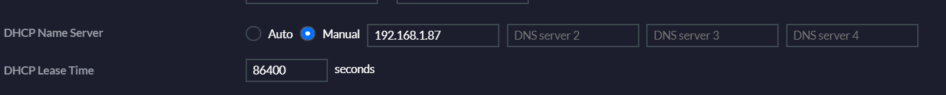

all devices are using the pi hole as DNS server; the pihole dashboard reports 22 devices which is also the number reported by my router.
pihole is the only DNS server
I am not sure if I should set the DNS server to the pihole IP on the WAN as well as the LAN?
