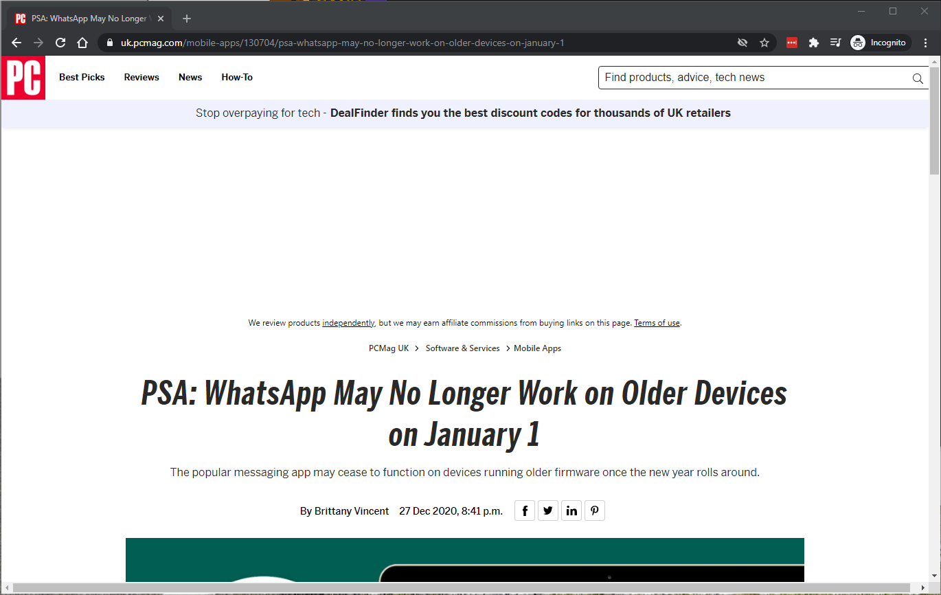

Now no ads

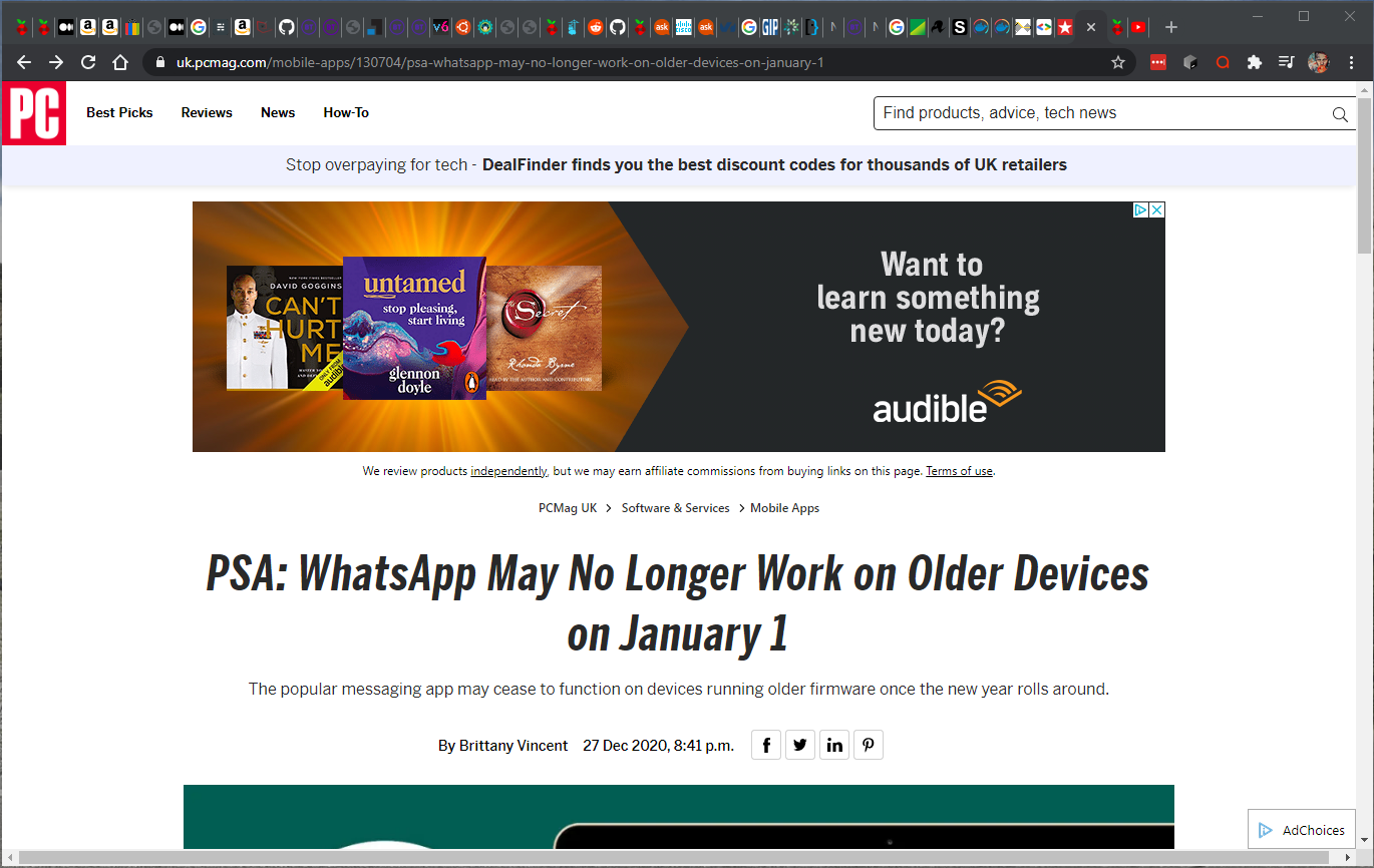

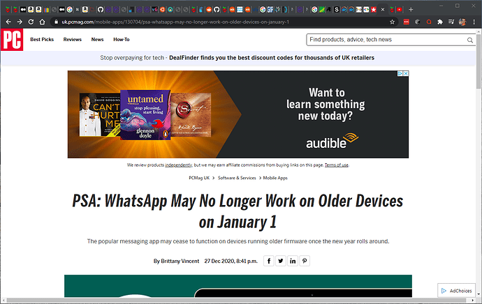

But, if I switch back to the default IPv6 DNS - I start getting ads again in web pages. So I thought I'd ask here for advice. Does this mean that my pihole is being bypassed in my default network setup, where IPv6 is being used to resolve adserver names?
