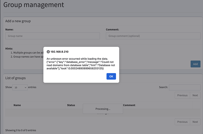

Tried updating gravity list and was receiving statx error and now my blocklists are gone and am not able to add any. Received a database error as well as I was trying to access the Group Management area in pihole. See screen shot below.
Was just logging into pihole to check queries and update gravity. See debug token below. Running the following versions:

You have 2 issues:
  1. statx error message:
    As explained on the other issue, the statx error message is expected and this is already being fixed. Also, this is not a fatal issue. Actually this is a harmless issue.
  2. Your gravity database is broken:
    2025-03-25 21:53:21.039 EDT [1353/T9050] ERROR: SQLite3: no such table: info in "SELECT value FROM info WHERE property = 'updated';" (1)
    2025-03-25 21:53:21.039 EDT [1353/T9050] WARNING: gravity_updated(): SELECT value FROM info WHERE property = 'updated'; - SQL error prepare: SQL logic error
    info table is missing, which probably means the database is corrupted.
    Move your old gravity database to a new file and let Pi-hole rebuild it running these commands (maybe you need to add sudo before both commands):
    mv /etc/pihole/gravity.db /etc/pihole/gravity_backup.db
    pihole -g
