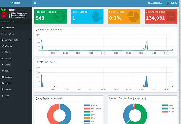

Status - DNS service not running but it actually runs
Status - Active Temp: 33.8 °C
It actually does work because i see all the DNS requests passing through pi-hole.
When I try to enable it from the webpage it does nothing.

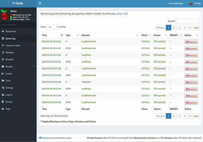

And that, behaved exactly the same:
It installs corectly though.
dnsmasq is dead and FTL is active:
however:
and
the DNS queries DO go through the pihole:

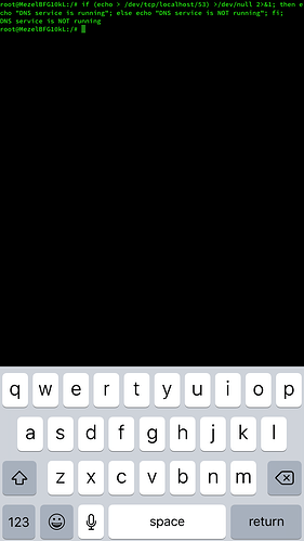

If you run this in your terminal:
if (echo > /dev/tcp/localhost/53) >/dev/null 2>&1; then echo "DNS service is running"; else echo "DNS service is NOT running"; fi;
what does it print?
Thanks @DL6ER, I was just about to ping you for some assistance.
I don’t have /tcp/ under dev so this will return that is NOT running.
53 is open

Have you actually tried it? /dev/{tcp,udp} are only bash internals and do not really exist on the file system... see also
/dev/tcp/host/port
If host is a valid hostname or Internet address, and port is an integer port number or service name, Bash attempts to open the corresponding TCP socket.
/dev/udp/host/port
If host is a valid hostname or Internet address, and port is an integer port number or service name, Bash attempts to open the corresponding UDP socket.
https://www.gnu.org/software/bash/manual/bashref.html#Redirections
I modified /etc/hosts and changed the 127.0.0.1 to the actual hostname and removed “localhost”
I changed it back. All works as expected
I'm not sure why this would solve things...
I run 2 other pi-holes.
/etc/hosts files on both are modifie to have 127.0.01 to translate into the hostname.
But those are raspberries. This one is ubuntu.
Oh yes, if your system doesn't even know how to translate localhost, then it is clear that our test fails. I have not tried this, but would
127.0.0.1 host.name
127.0.0.1 localhost
help? In my imagination this might return the host.name for reverse queries (as it is the first one in the list) while still also describing what localhost should point at.
