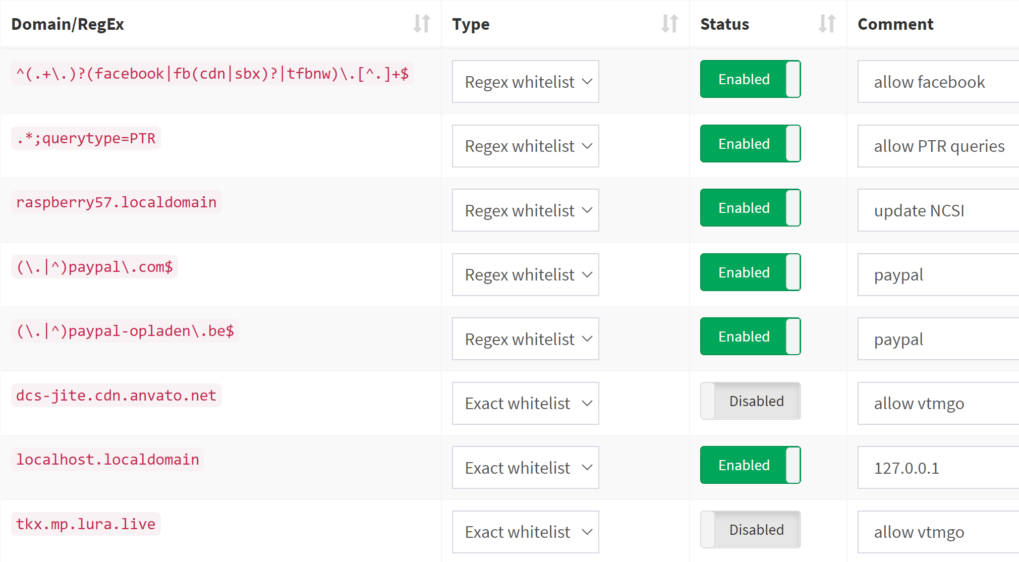

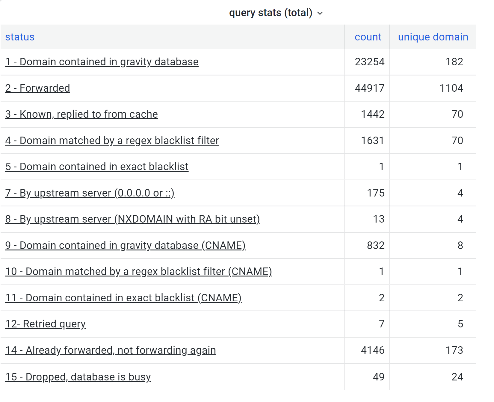

Everybody does it, you run into a blocked web site, search for the domain that causes the problem and whitelist it (hopefully with a comment for future reference). Once whitelisted, you never look back. I was recently made aware of some domains that no longer need whitelisting. but found it to be hard to determine which whitelist entries are actually effective, mainly due to the fact there are no dedicated status entries, indicating a query was forwarded (whitelist always wins) due to a whitelist entry. There are currently 17 status IDs (0-16), the missing entries in the documentation are already addressed by this PR.

Currently, I'm using a grafana dashboard to identify specific queries.

whitelist entries are added as response to specific problems, most users never look back, once the problem is solved. When a whitelist entry is no longer required, there is no easy way to detect this.

We'd need more than these two, at least two more for cached queries or you won't get accurate counts for your whitelist entries. Also, we have status 7 or 8 which would overwrite status 2 so we'd need four more for this, too.
You see, we first have to find a compromise here as adding eight new status codes (+50%) seems a bit extreme for what we want to achieve here.
