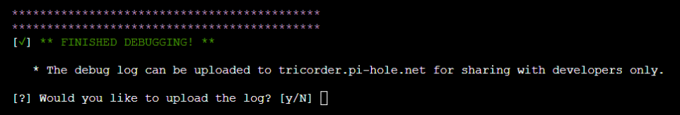

Just a note about the debug log:
You don't need to paste the contents of your log on pastebin (or here, or anywhere).
You just need to post the debug token shown after you upload the log.
Steps:
  1. execute pihole -d;
  2. wait for the log to be generated;
  3. when asked if you want to upload the log, answer YES;
  4. copy the Debug Token and paste it here.
It's faster and keeps all your data private.
(only a small number of pi-hole devs will have access to your log content. It will be automatically deleted after 48 hours).
