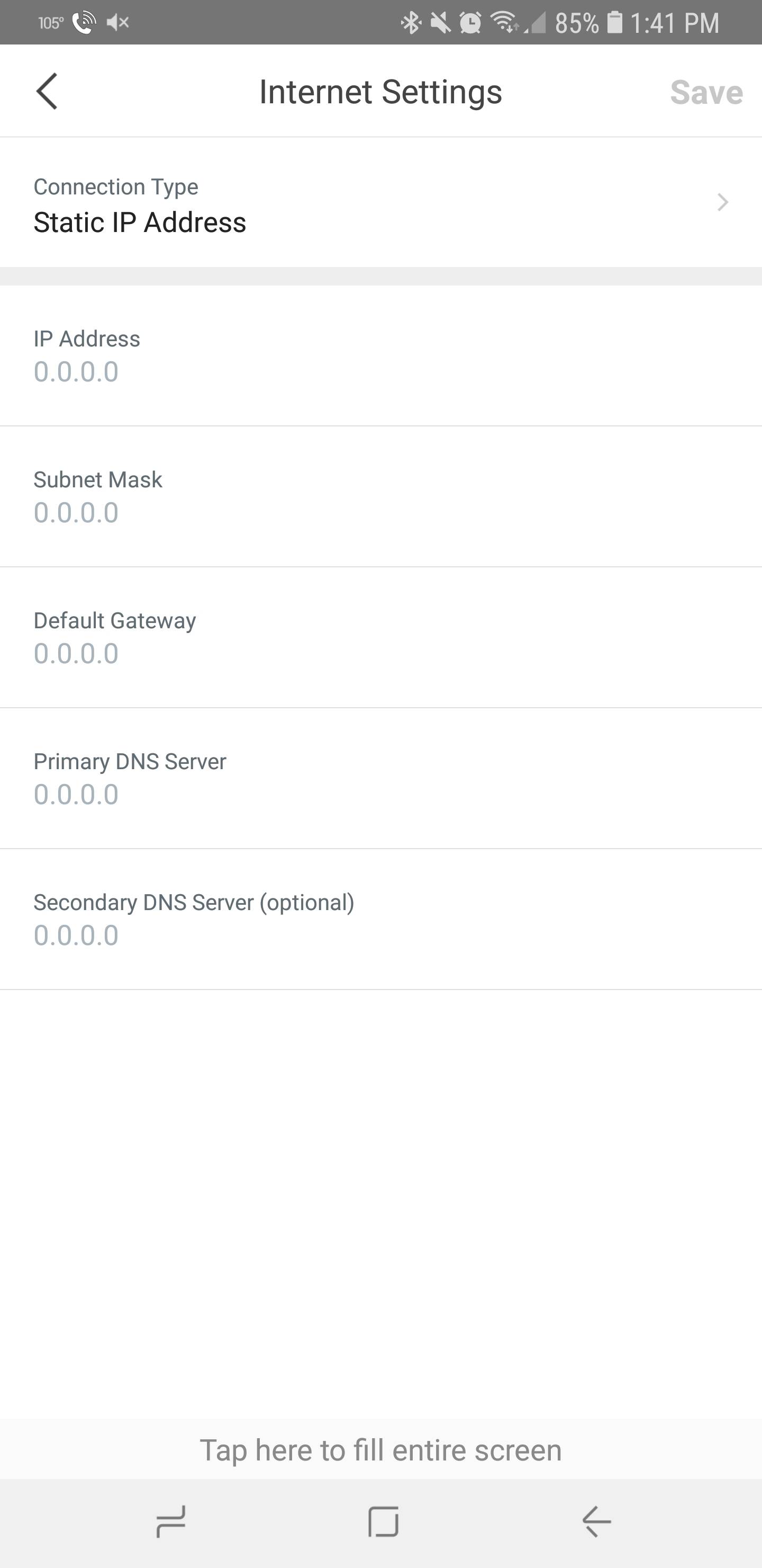

I'm unable to make any changes to DHCP. Can't view any of the DHCP settings, let alone edit them.
Trying to point the Nova to Pi Hole using the "Static IP Address" option
Entered into the IP Address field: 192.168.5.241 but in order to accept the IP address it also requires a:
Subnet Mask
Default Gateway
Primary DNS Server
Secondary DNS Server
This is where I'm stuck. All fields need a value in order for the settings to be saved.
It has a bridge option too but says no configuration is needed just like DHCP.
Thoughts? TIA

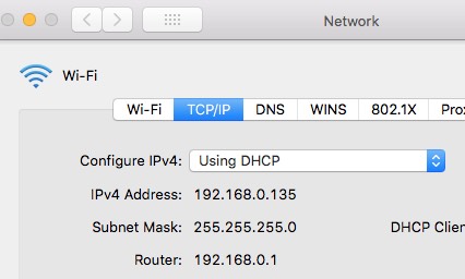

From any network connected device, you can look at its network configuration (how depends on the device), and this will give you the subnet mask and the default gateway (the values depend how you have your router set up).
The primary DNS server is the IP of the Pi-Hole, and the secondary should be blank. If it absolutely requires a secondary DNS server, put the Pi-Hole IP in this space as well.
For example, on my Mac, this is the network information displayed - it has IP address 135 in the indicated range, the router is at address 1, etc.

All fields need to be populated in order to switch from DHCP to Static IP on my mesh system. I have no option to edit the DHCP settings. If I enter the Pi Hole as the connection I'm assuming it should work.
It looks like that setting will only affect the Pi-hole device. Is there any setting that will affect all clients?
It looks like you are on the settings page for connecting your mesh router to the internet, not the screen for assigning IP's to your internal network. Most internet providers connect you via DHCP, and that would auto-populate this if the "Connection Type" were switched to DHCP. Given that you are on the internet, that appears to be already set up.
Settings for your local network should be titled "network" or something similar - on a different screen.
