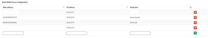

I have configured pihole as my DHCP server, All my clients successfully receiving a DHCP address from 10.31.27.1/24. I have a few Static IP`s for machines on my network. pihole is not assigning my PC the correct staticIP I require but is instead assigning an IP address from the DHCP pool. I have checked, double checked and triple checked the MAC address is correct. If i delete the DHCP lease, unplug and re-plug in my network cable pihole assigns me the same IP address from the pool over and and over.
If i run tail -f /var/log/pihole.log | grep DHCP from putty i can see pihole assigning my pc 10.31.27.19 which is incorrect as i have a static reservation for 10.31.27.5 configured.
Jan 22 13:57:52 dnsmasq-dhcp[916053]: DHCPACK(eno1) 10.31.27.19 04:d4:c4:4c:b4:42 danny-pc
Jan 22 13:57:52 dnsmasq-dhcp[916053]: DHCPDISCOVER(eno1) 04:d4:c4:4c:b4:42
Jan 22 13:57:52 dnsmasq-dhcp[916053]: DHCPOFFER(eno1) 10.31.27.19 04:d4:c4:4c:b4:42
Jan 22 13:57:52 dnsmasq-dhcp[916053]: DHCPREQUEST(eno1) 10.31.27.19 04:d4:c4:4c:b4:42
I am running Linux Mint Debian Edition with Unbound on Pihole v5.2.4. Apart from the OS unsupported messages when updating pihole, everything is working as intended, just static dhcp assignment is not.
The Cisco Aironet Access Point in the screenshot is working on 10.31.27.3 as expected and is configured to use DHCP. This issue only seems to affect Windows 10 device assignment at this stage.

Thanks JFB, I am technically using 2 DHCP servers. I have a Google Wi-Fi system and the DHCP service cannot be turned off on that device so on the GWi-Fi ive set the DHCP address pool as 10.31.27.2 so all DHCP requests get routed into pihole. 10.31.27.2 is the pihole server. It`s IP is statically set on the server itself. The NIC on the server is eno1. From the log if im understanding it correctly, eno1 is offering up 2 IP addresses. One is the router of 10.31.27.1 and the other is 10.31.27.2 (pihole). I cant see an explanation from the debug log of why pihole isnt assigning my pc the static address. From the DHCP Pool everything is working a treat.
How did you accomplish deleting the lease?
Theres a delete button within the DHCP leases. I`d assume this deletes the current lease so that the next time the machine connects, DHCP will assign a lease from the pool. Screenshot 2021-01-22 190854
Ok i think i`m getting closer to the issue. When i check /etc/pihole/dhcp.leases, my PC does not appear in the list but all my other devices are there. the DNS Suffix im receiving is servehalflife which is configured by pihole. Somethings amiss here.
Ive now got it working. I do not know if it was luck, I set the PC NIC to a static address manually. After i did that i didn't appear to have internet, so i reverted back to automatically assign and my PC got 10.31.27.5 which is the static address pihole dishes out I`m starting to think this isn't a pihole DHCP but a Windows issue. I can see now in the pihole leases window that my pc has successfully been assigned 10.31.27.5

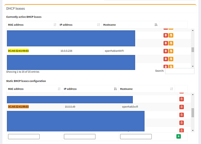

I have a similar issue and hope someone can help me please.
I have a raspberry pi 4 (debian buster) that does always get an IP out of the DHCP pool although I have set static DHCP leases for the WIFI and Ethernet MAC Addresses. I flushed / cleared all arp and dns cache and rebooted pi-hole several times but it is still not working.
I am running the Pi-Hole on:
Release = Raspbian GNU/Linux 10 (buster)
Kernel = Linux 5.4.83-v7+
Platform = Raspberry Pi 2 Model B Rev 1.1
Here is the support token:
https://tricorder.pi-hole.net/mzpy3aafzw
Hope this is all the information you would need.
