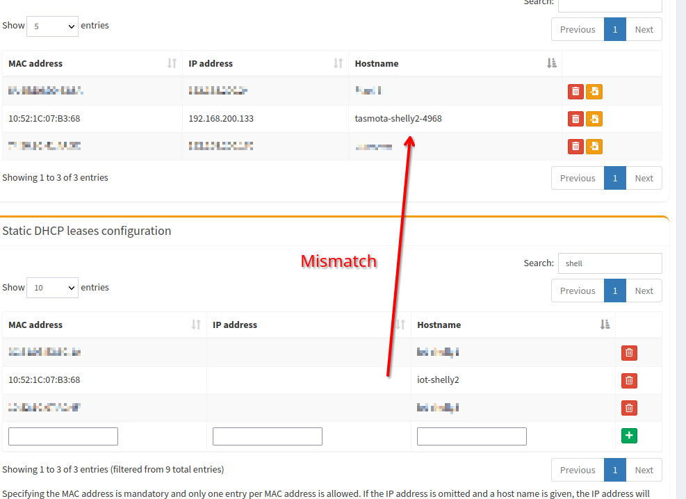

I installed pihole on a bare metal debian 12 host. I configured a static DHCP lease configuration. When the hosts requests it's ip the hostname is set wrong. The setting from the static lease config is ignored. Do i miss something?
Host gets the hostname as configured in the dhcp leases section and not it's self generated one
Take the Shelly device off the network, hit the bin icon to delete the tasmota-shelly2-4968 entry, then rejoin the Shelly device to network so the DHCP server can respond to it with no existing dormant lease in the table. Does that fix the entry?

Thats not a "self generated one" I believe.
Thats most likely the hostname thats advertised by the client (set on the client itself) during the DHCP lease transaction.
You can see what names are advertised by your DHCP clients with below (hakpc in below example):
