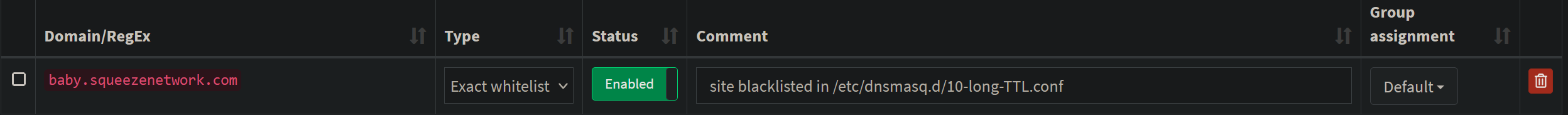

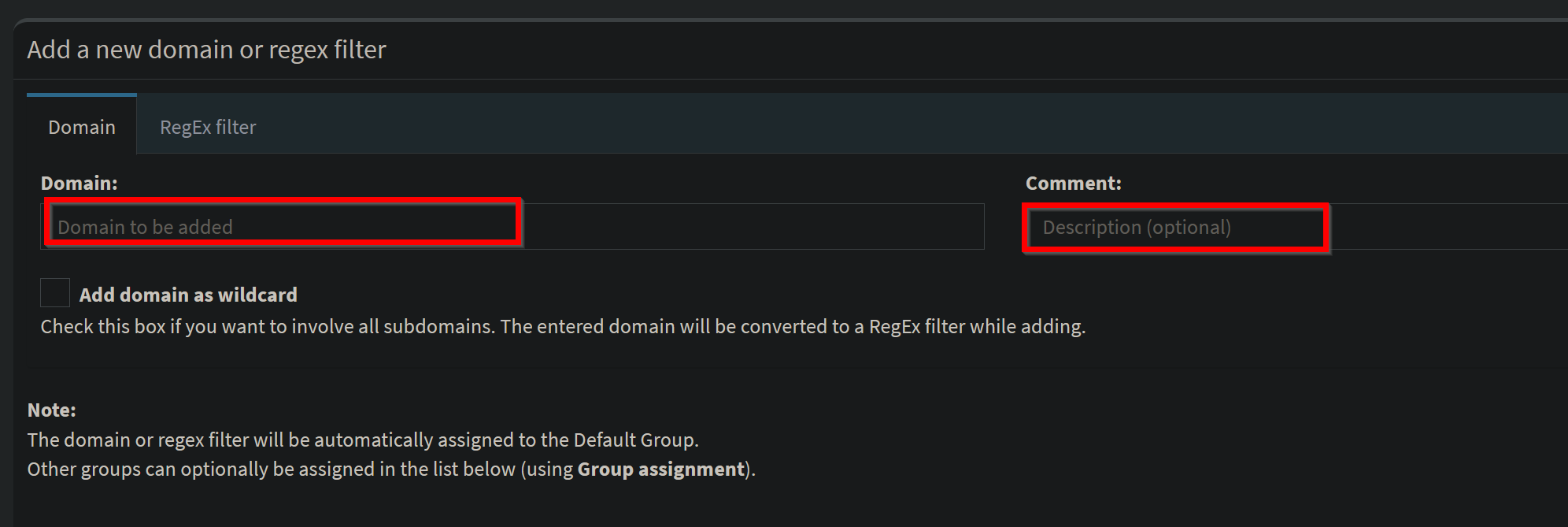

@altstadt Thanks for the provided informations, I will try out, one question, anything special you mean with " Plug the site name into the Domain: box." <= "box."?
Or just that marked here?
@altstadt
seems not working:
grafik
You have outlined the correct two textboxes.
In the textbox labeled "Domain", put in the text "baby.squeezenetwork.com".
In the textbox labeled "Comment", put in text that reminds you why you whitelisted this domain. In my example, I chose to say that the whitelisted domain was being blacklisted in the dnsmasq config file.
It looks like everything was entered correctly.
Either the squeezebox's IP stack is ignoring the TTL, or else the DNS service was not restarted on the Pihole.
I often have problems with network services after fiddling. Rebooting seems to clean up any issues. Have you tried rebooting your Pihole?

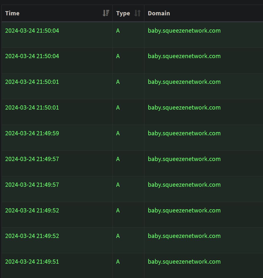

even with a completed pihole server reboot:
I forgot your original conditions.
Have you removed "baby.squeezenetwork.com" from /etc/hosts in all devices?
I do not know the precedence order when searching for an address. I suspect that /etc/hosts is the first place checked, so the dnsmasq entry was never reached.
yes, tried with commenting the entry in /etc/hosts, still yet not active in hosts ...
"# 0.0.0.0 baby.squeezenetwork.com"

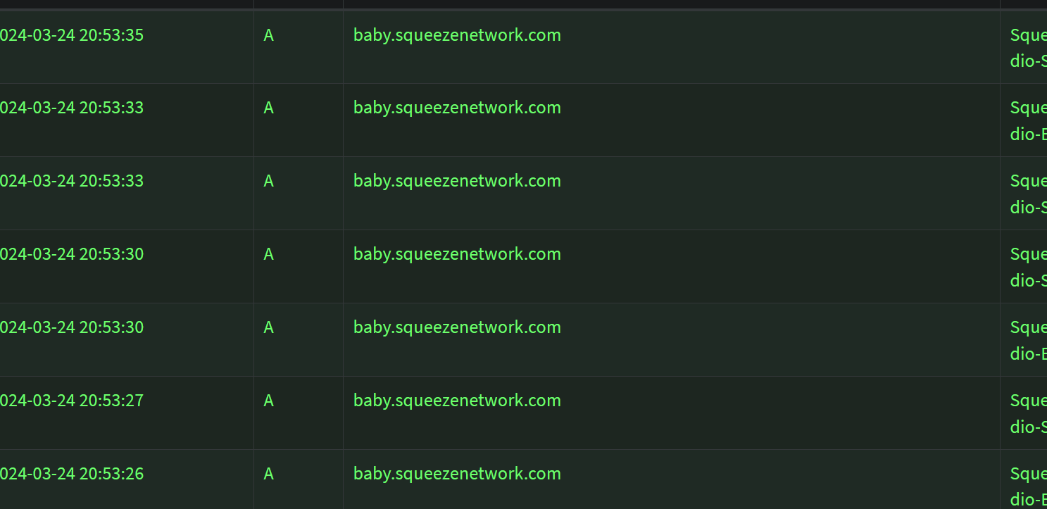

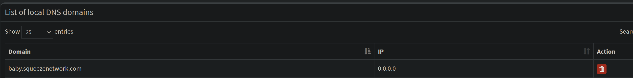

@rdwebdesign @altstadt Yes, I am using the latest version of LMS (just installed the latest nightly),
I also have setup baby.squeezenetwork.com 0.0.0.0 in /etc/hosts/, I have BLOCKED in domain-mgmt and I have setup in Local DNS:
NOTHING prevents the boxes from spamming ....
In addtion there is fw patch underway, as of now my preferred way would be to do it via pihhole if possible, alternative fw is always a risk :slight_smile:
https://forums.slimdevices.com/forum/user-forums/squeezebox-radio/1687640-a-lot-off-networktraffic-to-baby-squeezenetwork-com seems that helped
