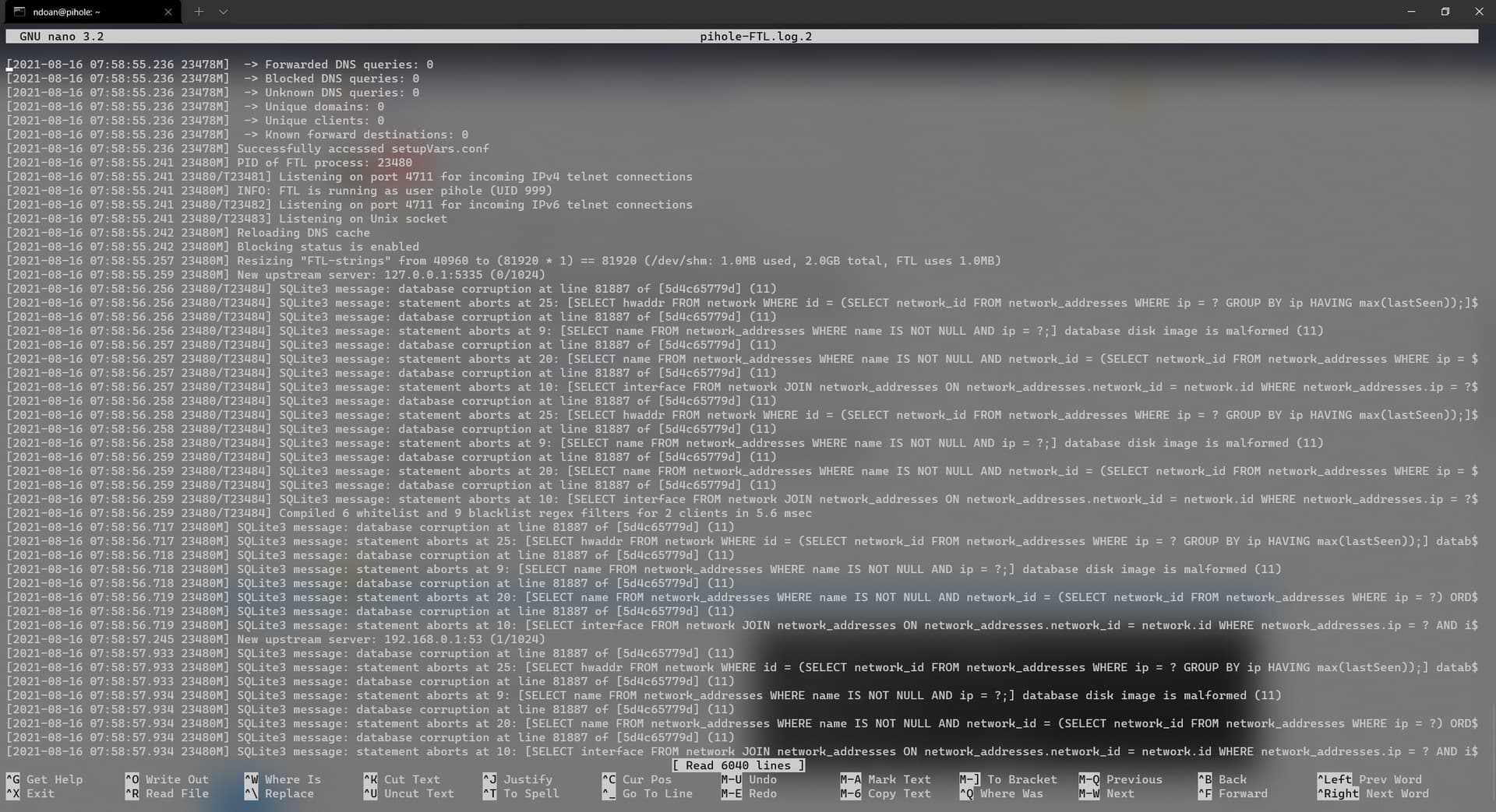

   [2021-08-17 21:26:25.804 621M] SQLite3 message: database corruption at line 81887 of [5d4c65779d] (11)
   [2021-08-17 21:26:25.804 621M] SQLite3 message: statement aborts at 10: [SELECT interface FROM network JOIN network_addresses ON network_addresses.network_id = network.id WHERE network_addresses.ip = ? AND interface != 'N/A' AND interface IS NOT NULL;] data (11)

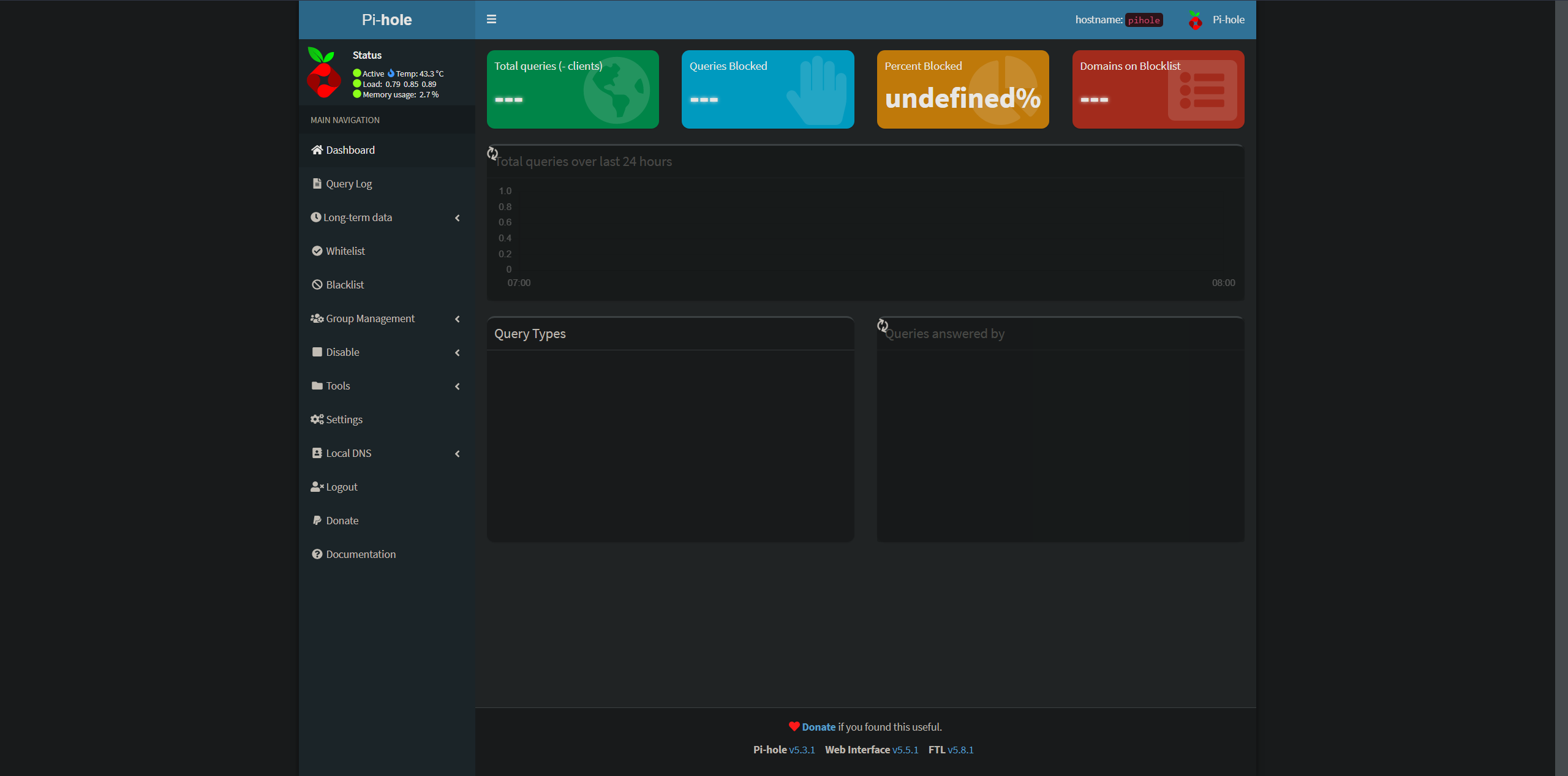

I am currently experiencing the issue again. I do see a "client denied (at max capacity of 255)" in there. I have uploaded another debug log. I will check in to the logs and rotated logs and let you know what I see shortly.
I also see the counters as blank and percent blocked as "undefined".

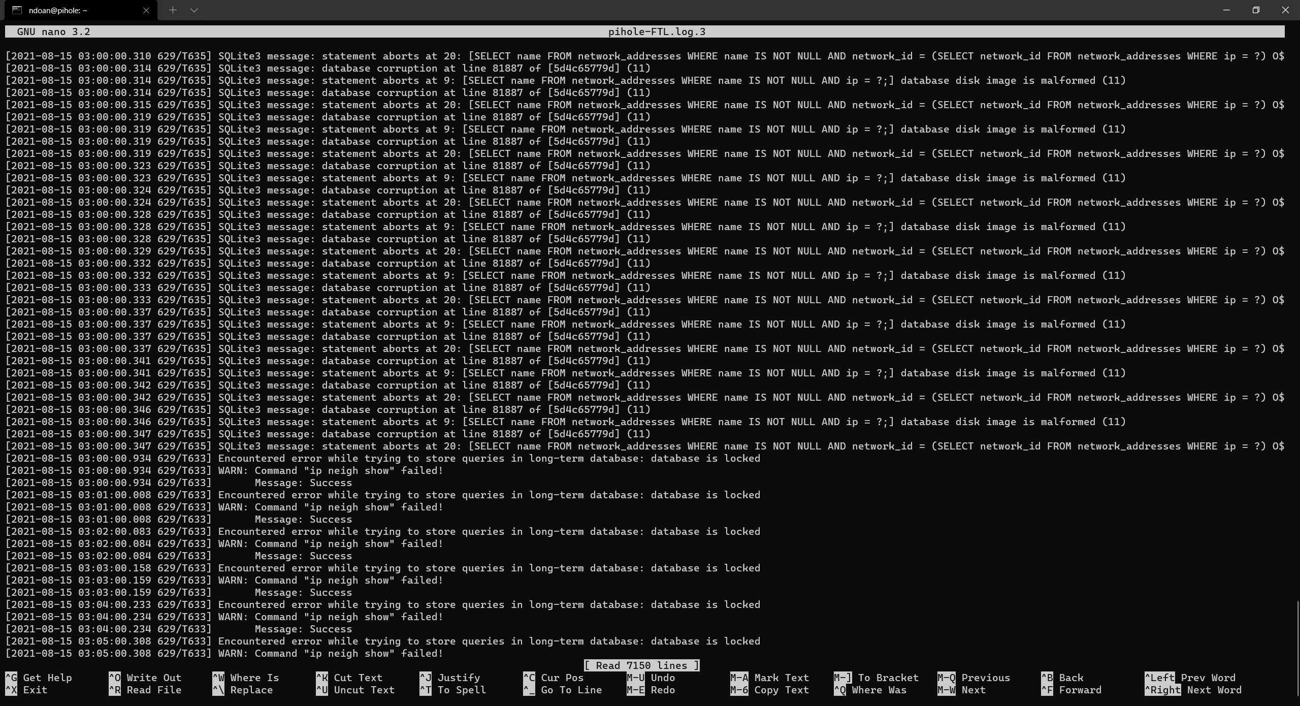

Here is a view of pihole-FTL.log.3 and 2, respectively. Seems there were issues for a few days. I'm thinking at this point the DB being corrupt was the issue. The FTL logs have calmed down dramatically.

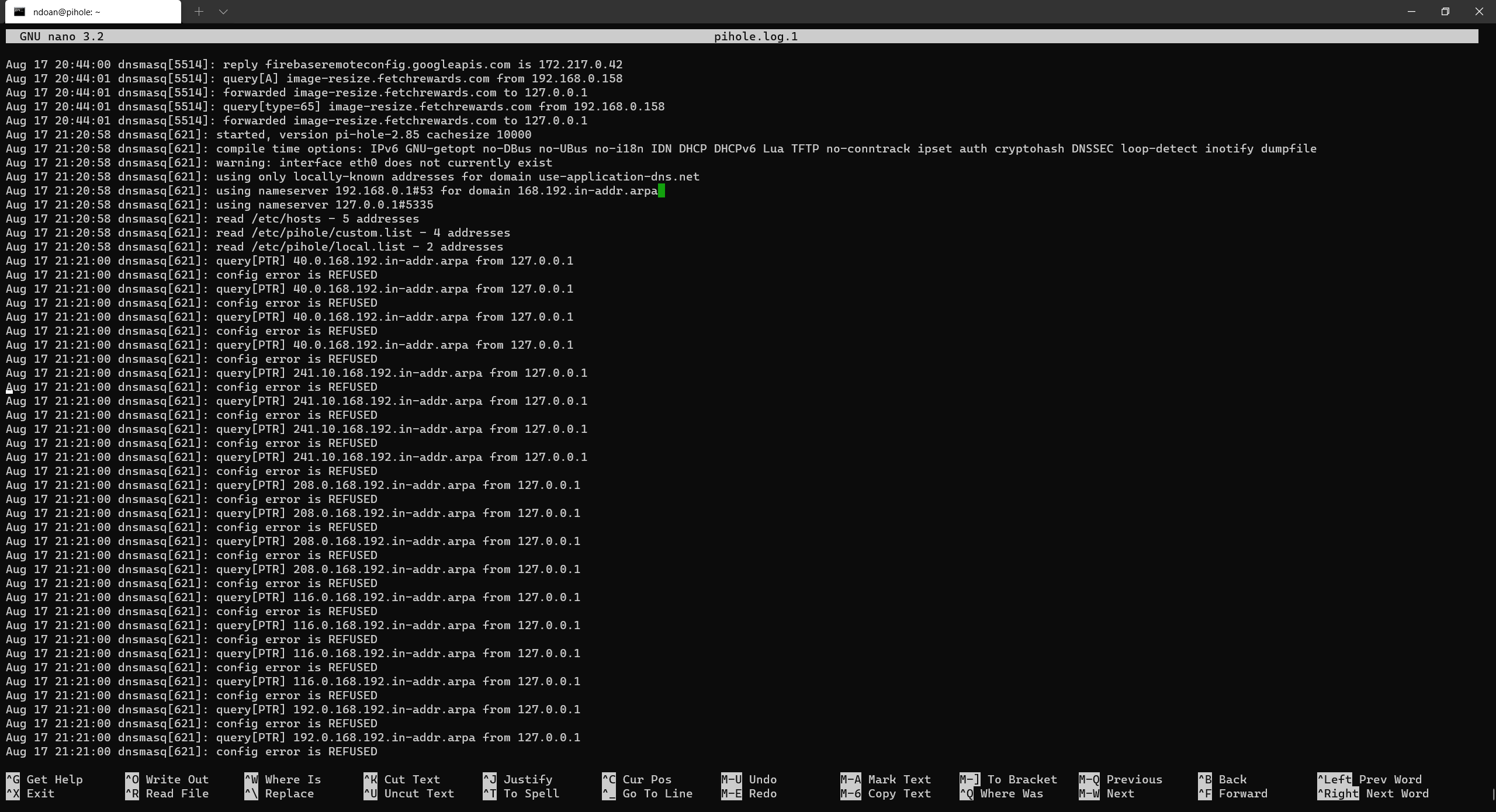

Your second screenshot is interesting because time jumps forward and backwards again in the same log file. Maybe your clock is unstable and gets corrected very often...
Hmm, yes, maybe. We just haven't seen this before but I set up a testing Pi-hole yesterday whose database I corrupted manually. We'll see if it stops working at some point too.

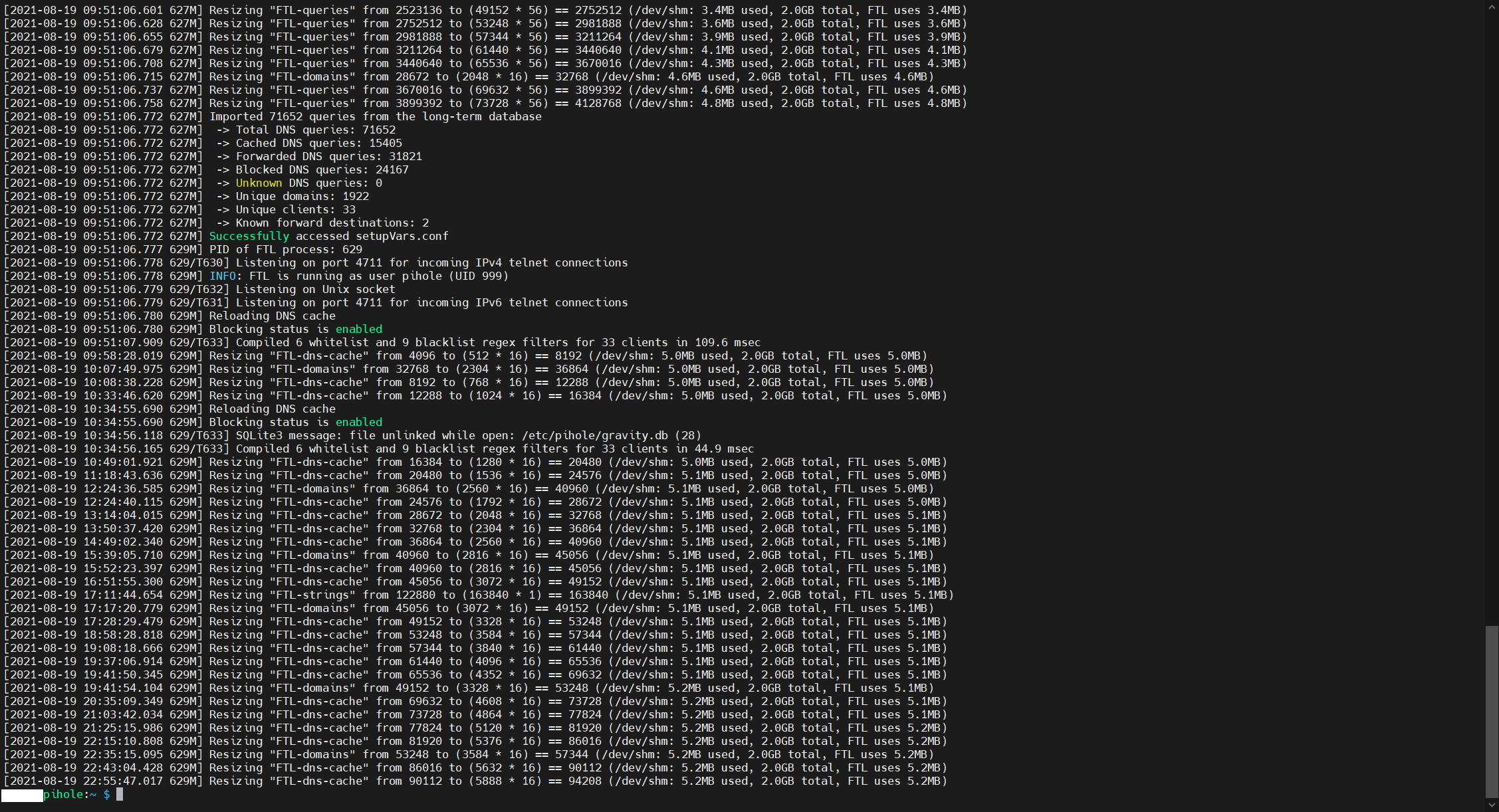

It looks like FTL is having issues again. I haven't had a down scenario, but the logs show DB locked and issues again.
pihole-FTL.log.1.targz (24.8 KB)
The database is locked (but not corrupted) and there are too many clients trying to access the API at once. Do you have any scripts accessing the Pi-hole API and maybe gathering data? Also, could you check if you have (zombie) PHP processes running? The PHP API processes should exit immediately after serving the content. If they don't, this could explain what you are seeing here.
