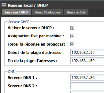

May be it's related: The Pi-hole is attached to my freebox (french internet provider) and I configured the wifi router to use it as main DNS (because I can't switch DHCP to the Pi-hole without breaking the whole network, freebox issue):
But I tried to access a blocked domain and still can access it. So I wonder if there's any stat to show, hence the spinning wheels.
Did I miss something?
