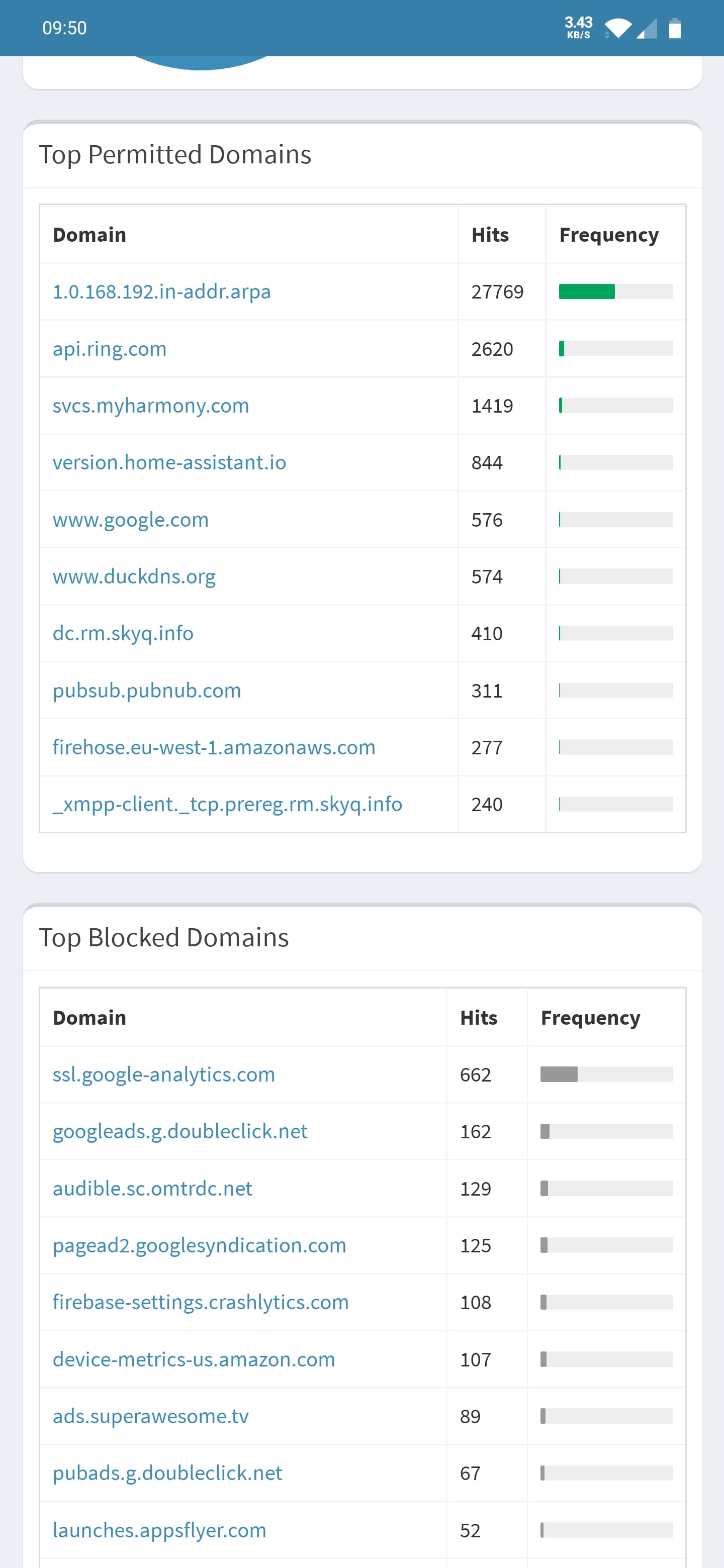

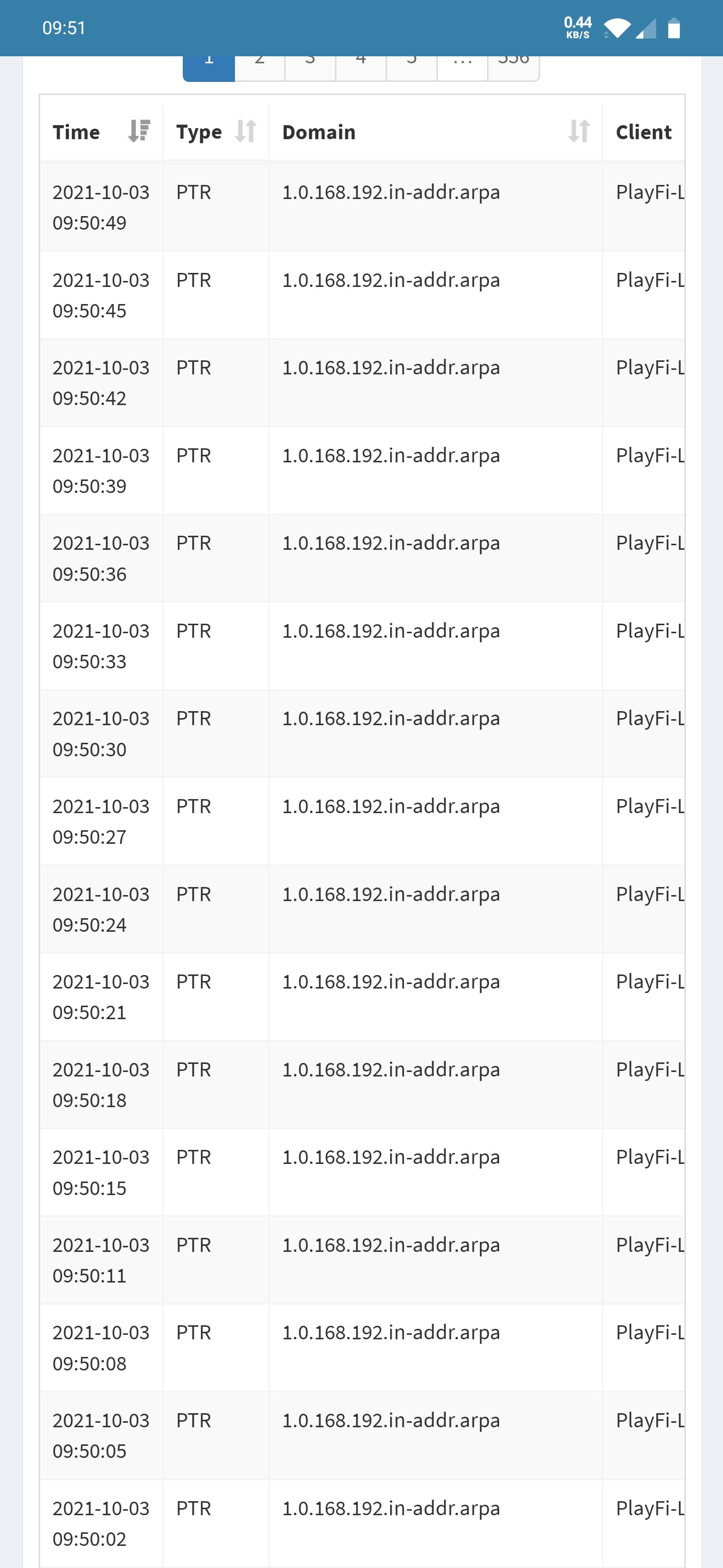

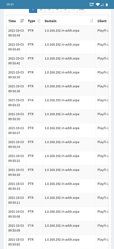

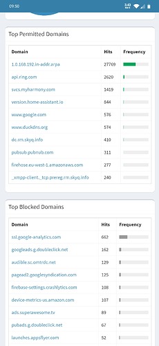

Soundbar making tens of thousands of PTR requests
Would anyone have any idea why a Philips soundbar is making this many PTR requests?
Literally none stop.
It's a Philips TAB8405/10, Play Fi enabled.
192.168.0.1 is my ISP provided router.
Pihole is my DHCP server, which is disabled on the router.
