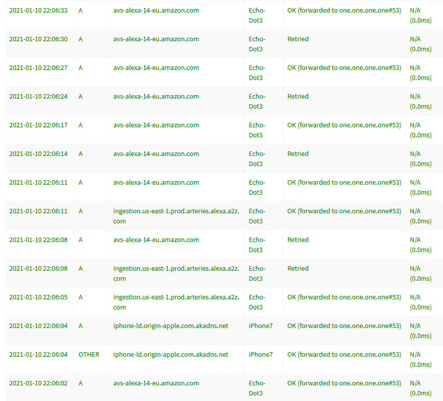

I have switched to Cloudflare DNS for 3 days now. The time for a successful forwarding to Cloudflare takes not so long most of the time, but the problem stays the same:
Any ideas? If you need a debug token pleaase let me know!

After using Cloudflare DNS without big problems I switched back to my providers DNS after some days to compare both settings.
There is no problem with internet anymore but with both settings the retried status still appears 80-100 times a day. The time between retried and forwarded is mostly 0 sec. now.
Are there any changes made in the recent update which affects this behaviour?
