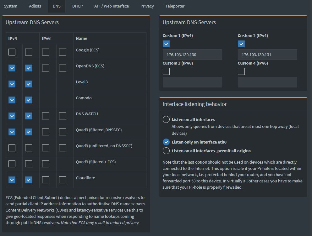

I had a pihole set up a few years ago while living alone and was very happy with it. Now trying to set it up again and I am doing something wrong - I don't notice a difference at ALL in my devices. Well, sometimes a Youtube video will not continue to load after I hit 'Skip Ad.' That's all. I remembered pihole being an obvious and positive change, so the problem must be something I did.
Am I checking too many DNS lists?

No, this is perfectly fine. I have seen a lot more on other users. As long as it does not block stuff you don't want to see blocked, I wouldn't worry about this.

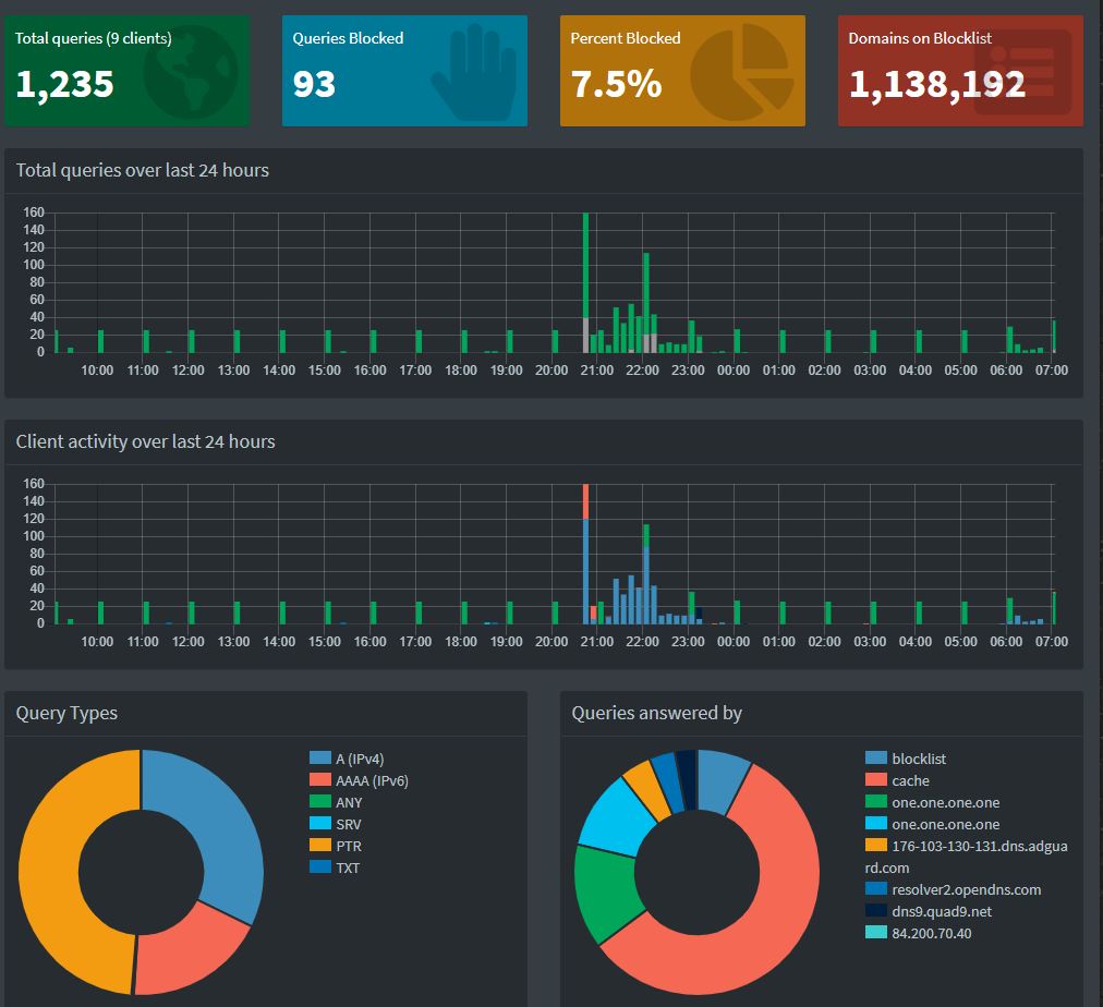

A few notes from your debug log (and looking at your dashboard snap):
(1) The snippet of the pihole.log in your debug log shows queries only from localhost (expected - this is the hourly pulse to resolve local IP names) and client 10.0.0.79. If there are other active clients, they don't appear to be using Pi-hole.

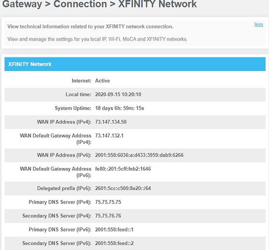

My router is from Xfinity and I don't think it lets me change the DNS forwarding. Here is a pic of the settings.

This is the XFINITY network. Can you also provide screenshots of the local IP and Wi-Fi settings?
