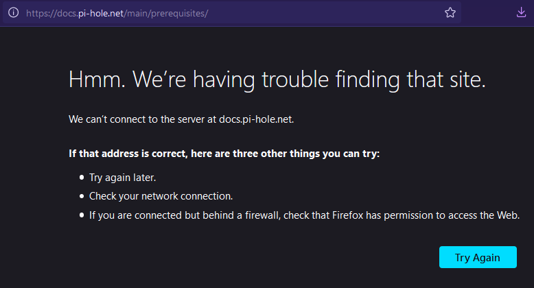

I have been using my Pi-hole + Unbound for a couple weeks without issue, when I suddenly started having this error randomly pop up in Firefox (with its DoH disabled) for a bunch of different pages:

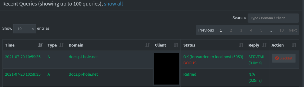

It is "fixed" each time by simply refreshing the page once or twice. I was wondering what might be causing it, so I went to my Pi-hole query log and saw entries that look like this:
There is usually a Retried status immediately followed by a BOGUS / SERVFAIL. I did a query log over the past seven days and saw that there were over 3000 Retried entries across several different devices, not just this one.

A BOGUS reply for a DNSSEC signed record indicates that a signed record was found, and the signature was bad.
If you are seeing this randomly, it may indicate that the date/time on the Pi are not accurate. Accurate time is required for the DNSSEC algorithm.
You can also check the unbound anchor.
docs.pi-hole.net isn't a DNSSEC signed domain.

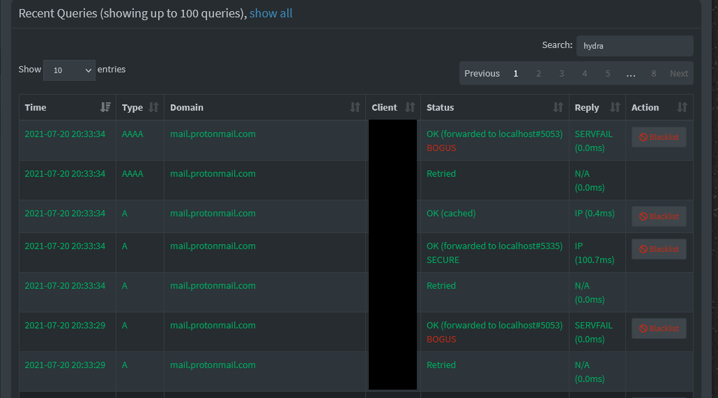

You'd likely be unable to resolve any domain if your anchor was incorrect.
Assuming that you are just seeing those SERVFAILs for certain domains, your issue seems to be upstream.
SERVFAIL indicates one of Pi-hole's and in turn unbound's upstreams returned an error.
Intermittent SERVFAILs are not uncommon, and you'll hardly ever notice them.
Unfortunately, they are somewhat hard to troubleshoot if they persist over a longer period.
They may indicate a DNS server authoritative for that domain may be down, or something is interfering with DNS resolution (outside of your network) - see Pi-hole unbound servfail where an ISP was filtering DNS requests.
(Some) domains returning "SERVFAIL" but no DNSSEC enabled - #9 by deHakkelaar also may have some leads on troubleshooting issues with resolving mail.protonmail.com.

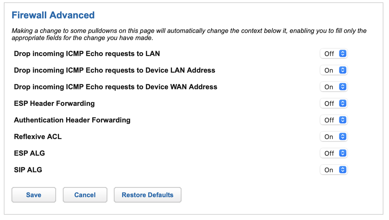

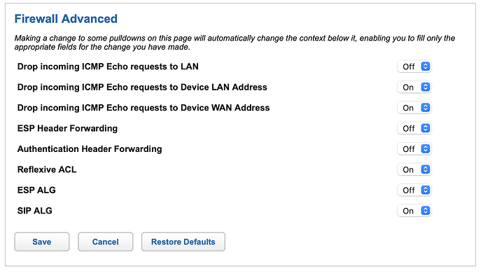

That's an interesting point about the ISP. I checked AT&T's ARRIS BGW210's settings and noticed packet filtering was turned on, so I disabled it since I have a downstream router to handle it. I'll keep an eye out and see if this helps going forward. If it doesn't help, I'll turn on the unbound-remote and see if I can get some additional insight there.
I did notice some additional firewall settings, but I'm not certain which, if any, I should change from their defaults:
