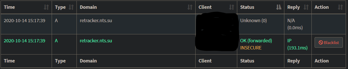

Some websites are showing up as unknown in status while others work

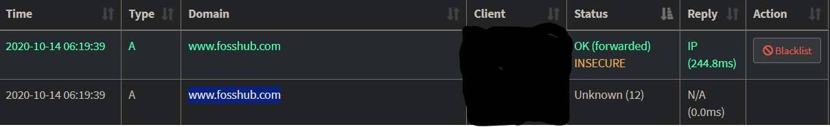

just noticed something strange, there's another type of unknown entry, not 0 but 12. here's a screenshot:
/var/log/pihole.log:16747:Oct 14 06:19:39 dnsmasq[653]: 50855 192.168.55.100/57402 query[A] www.fosshub.com from 192.168.55.100
/var/log/pihole.log:16748:Oct 14 06:19:39 dnsmasq[653]: 50855 192.168.55.100/57402 forwarded www.fosshub.com to 208.67.222.123
/var/log/pihole.log:16749:Oct 14 06:19:39 dnsmasq[653]: 50856 192.168.55.100/57402 query[A] www.fosshub.com from 192.168.55.100
/var/log/pihole.log:16750:Oct 14 06:19:39 dnsmasq[653]: 50856 192.168.55.100/57402 forwarded www.fosshub.com to 1.1.1.3
/var/log/pihole.log:16751:Oct 14 06:19:39 dnsmasq[653]: 50856 192.168.55.100/57402 forwarded www.fosshub.com to 208.67.222.123
/var/log/pihole.log:16753:Oct 14 06:19:39 dnsmasq[653]: 50856 192.168.55.100/57402 reply www.fosshub.com is 104.20.136.9
/var/log/pihole.log:16754:Oct 14 06:19:39 dnsmasq[653]: 50856 192.168.55.100/57402 reply www.fosshub.com is 172.67.32.78
/var/log/pihole.log:16755:Oct 14 06:19:39 dnsmasq[653]: 50856 192.168.55.100/57402 reply www.fosshub.com is 104.20.137.9
you'll notice, it's less than 300ms, so at least this kind of unknown is not related to the delayed response.
From this I cannot see that it is less than 300msec. This new 12 is actually what I added. I'll need to update the web interface so it shows forwarded (retried later) here.
so it is new, I just almost never scroll down. anyway in the screenshot the green query shows 244.8ms
same thing, less than 200ms, so I'm guessing there's another cause for this.
Okay, can you run the tcpdump and generate a pcap once again? May just have been a coincidence that last time we picked up the retried scenario which we can now distinguish from this one.
sent it to you in a pm.
I did the required low-level DNS traffic inspection of your data sent via PM now. Thank you very much for the traffic snippet. Apparently, it is a specific timing issue we're facing here. One that was, admittedly, quite hard to extract from the wirecapture. I will put up the exact sequence that lead to what you're seeing (anonymized) below for later reference:
Delay Sender <--> Destination Activity
0 ms Windows --> Pi-hole Query A a.b.c is made *
1 ms Pi-hole --> upstream Query A a.b.c is sent upstream
60 ms Pi-hole <-- upstream Upstream reply arrives for A a.b.c
60 ms Pi-hole --> upstream DNSSEC query: DS c
118 ms Pi-hole <-- upstream Upstream reply arrives for DS c
119 ms Pi-hole --> upstream DNSSEC query: DS b.c
187 ms Pi-hole <-- upstream Upstream reply arrives for DS b.c
188 ms Pi-hole --> upstream DNSSEC query: DNSKEY c
219 ms Windows --> Pi-hole Query A a.b.c is retried **
220 ms Pi-hole --> upstream DNSSEC query: DNSKEY c is retried by Pi-hole ***
264 ms Pi-hole <-- upstream Upstream reply arrives for DNSKEY c
270 ms Pi-hole --> Windows Reply to the original request
282 ms Pi-hole <-- upstream Upstream reply arrives for retried DNSKEY c ****
(delay is relative time from first query)
Extra comments:
  • * This query is shown as green OK (forwarded) in the Query Log.
  • ** This is the query that is shown as Unknown (0). FTL is ignoring a retired query here because it already has the reply, however, it is not ready to send it to the requestor because DNSSEC verification is still ongoing.
  • *** The too-soon retry of the query leads FTL to the (somwhat wrong) assumption that the DNSSEC verification took to long. As a result, the DNSKEY c query is retried. This is without any consequences otherwise, so I won't change this minor bit.
  • **** This is the reply to the retried DNSKEY query. It is silently ignored as we already have the answer.
Result of this analysis: Reproducing this exact chain of things is a bit tricky, however, you seem to be able to routinely get into this scenario due to your specific tuning settings.
@Scepterus Please update your Pi-hole to get the latest version and verify that there are no Unknown (0) queries any longer. Instead, there should be only Unknown (12) (retried queries) and Unknown (13) (retried during DNSSEC verification).

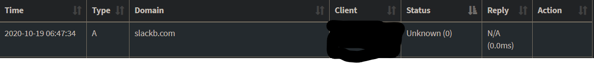

EDIT: ah sadly the saga is not over, see screenshots.
My bad, I told FTL to add the 13 status to the original instead of the retried query. While this is correct for the "regular" retried queries (the new ones take over, we flag the original query as being ignored), it is wrong in this case (the new query is simply ignored, the old one survives).
