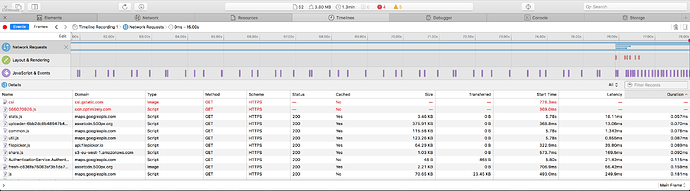

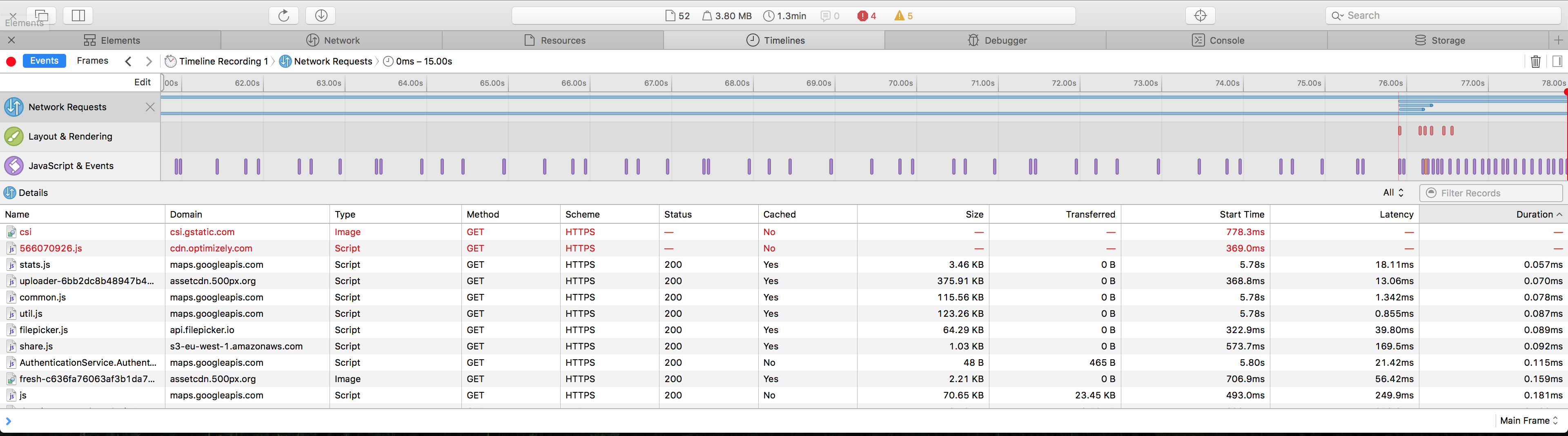

I didn't start noticing this until after I upgraded from 1.9.5 to 2.10.2, a couple days ago.
What I'm seeing, on all devices on my network, is some sites start loading, the page starts rendering partially, and and gets held up while the blocked assets time out. This didn't use to happen, they were just actively refused. I'm wondering what might have changed to prevent blocked URLs time out instead of be refused outright.
These slow loading pages are only appearing in cases where there are blocking javascript assets are being blocked. Non-blocking assets don't hold up the page load.
Debug token: lrtk735p6u
Here's a visual example of these long loads/eventual timeouts featuring assets expected to be blocked (not timed out).
