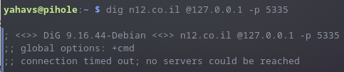

Some sites cant be reached with unbound upstream
Expected behavior would be managing to resolve the site, like:
Actual behavior is like this:
This seems to happen to some but not all co.il sites.
Im using pi zero 2w with the latest 64bit official lite os.

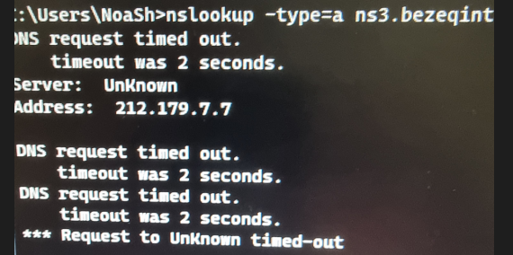

If you connect your PC directly to your ISP's fiber converter (bypass your router and bypass your Pi), then launch CMD and type:
nslookup -type=a ns3.bezeqint.net. 212.179.7.7
What do you get?
I dont have a fiber converter, its built in to the ISPs router.
I tried to check from it anyway (bypassing the pi hole and my regular router)
Here:

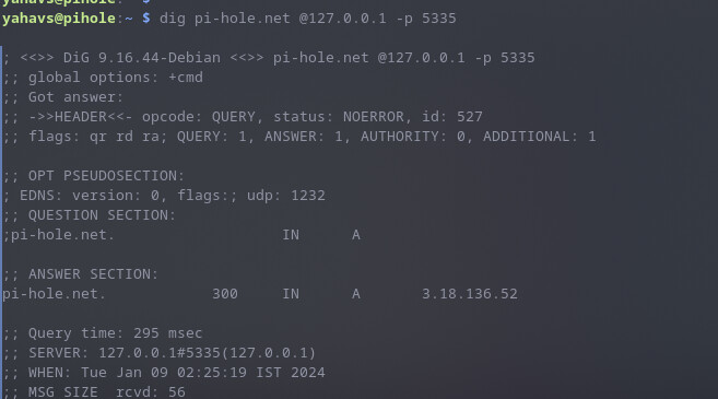

Unbound log would be useful to know what happen there as everything seems to work when using 8.8.8.8 instead of pihole, which rely on Unbound.
No problem with this site.
n12.co.il is reachable w. Pihole/Unbound setup.
That's exactly what I'm getting and this is why you have issues with sites when you're using Unbound.
Any site that has in its route Bezeq's name server, will fail when using recursive DNS.
If you switch to 8.8.8.8 (iterative DNS) you won't have issues reaching sites that have Bezeq name servers in their route.
@Yahavsh this issue only happened to me since I moved to a different city (northern part of Israel). I don't know if it's a geographical issue, but you just helped me to verify that there's an issue with using recursive DNS and Bezeq name servers.
