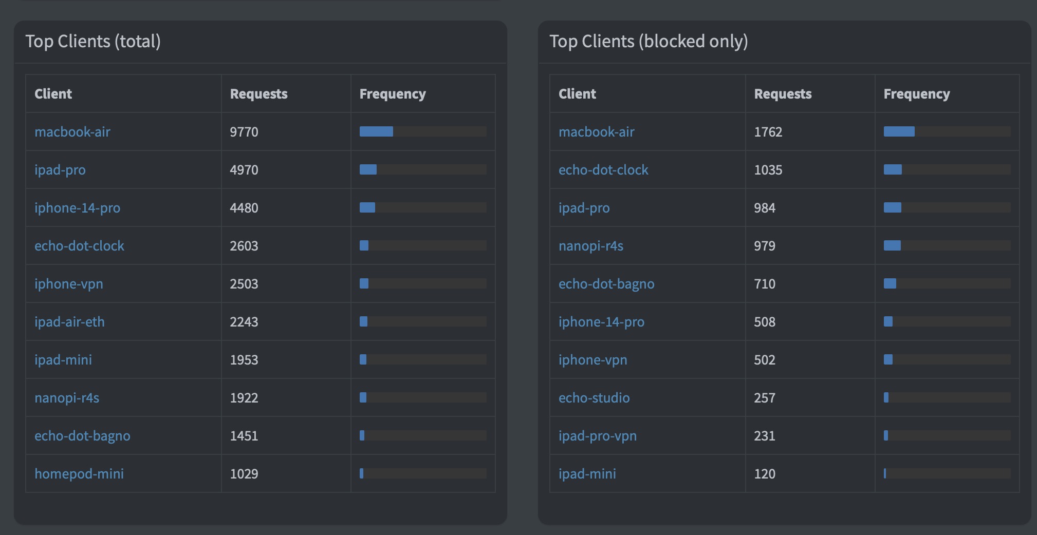

Hi!
Thanks for the reply, I found the solution, something was changed when I switched from snapshot to stable OpenWrt build. I had to restart the dnsmasq service, and -most important- the echo devices, now they are correctly reported as separated clients
You can read more in this OpenWrt post: Clients without custom DNS queries listed as coming from router (and not the clients) - #5 by giuliomagnifico - Network and Wireless Configuration - OpenWrt Forum
