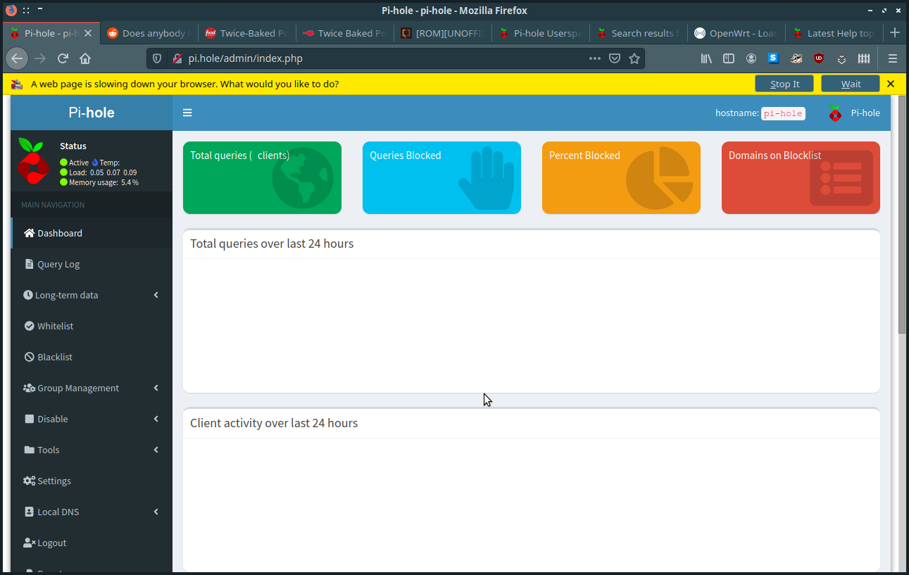

The web interface should work as it did before. Running on a Zotac AD-12 with 4GB ram and 750GB HD. OS is Debian Buster.

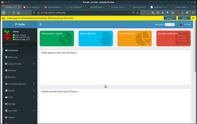

Interface frozen.
One time, it was able to partially load and there were a lot of allowed queries to scamcoin.ru. My guess is that the web interface is overloaded by all the queries. Is there some way to do some sort of partial reset?

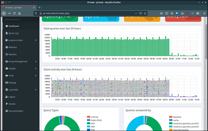

After waiting long enough, it does load:
I looked at the logs and I can see scamcoin.ru showing up frequently. Is the client information also there? I was unable to find it. It would be nice to identify the offending device.
