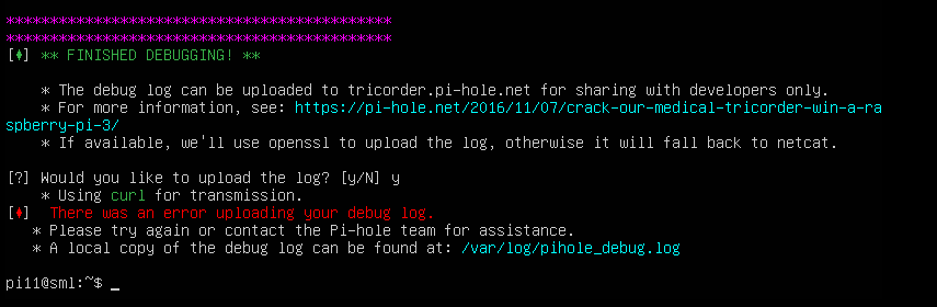

I noticed a few posts that some users were getting a failure upon trying to upload the token I captured a pick of it on my Beta 5 today, Thought you might want to look at the error message.

Can you ping tricorder.pi-hole.net?
traceroute to tricorder.pi-hole.net (107.170.224.181), 30 hops max, 60 byte pack                                                                                                                                                     ets
 1  192.168.1.1 (192.168.1.1)  0.707 ms  0.487 ms  0.421 ms
 2  [REDACTED] ([REDACTED])  1.631 ms  1.505 ms  1.511                                                                                                                                                      ms
 3  [REDACTED] ([REDACTED])  2.418 ms  2.281 ms  1.113 ms
 4  [REDACTED].net ([REDACTED])  5.064 ms  5.164 ms  5.4                                                                                                                                                     41 ms
 5  ae4---0.cor01.sttl.wa.frontiernet.net (50.46.176.7)  6.882 ms  5.597 ms  5.4                                                                                                                                                     85 ms
 6  ae0---0.cbr01.sttl.wa.frontiernet.net (50.46.176.41)  4.773 ms  5.672 ms  5.                                                                                                                                                     541 ms
 7  ae51.edge6.Seattle1.Level3.net (4.35.242.37)  5.739 ms  5.591 ms  5.449 ms
 8  * * *
 9  4.14.33.54 (4.14.33.54)  21.916 ms 4.14.33.70 (4.14.33.70)  22.401 ms  22.27                                                                                                                                                     5 ms
10  * * *
11  * * *
12  * * *
13  * * *
14  * * *
15  * * *
16  * * *
17  * * *
18  * * *
19  * * *
20  * * *
21  * * *
22  * * *
23  * * *
24  * * *
25  * * *
26  * * *
27  * * *
28  * * *
29  * * *
30  * * *
No I can't.
I added 1.1.1.1 to /etc/resolv.conf and still did not work.
I did a nslookup and pinged both IPv4 and IPv6 addresses and it still did not work
Address: 107.170.224.181
Address: 2604:a880:1:20::1449:8001
I pinged google.com and 1.1.1.1 both worked.
EDIT:
I visited tricorder.pi-hole.net using Firefox and got a page that wanted me to sing in, so I guess the site works.
EDIT 2:
I tried to visit the site again in Firefox and got "502 Bad Gateway"
EDIT 3:
Tried to send a debug log using my other PiHole running " Pi-hole Version v4.3.2 Web Interface Version v4.3.2 FTL Version v4.3.1 " and that did not work either.
Can you try again?

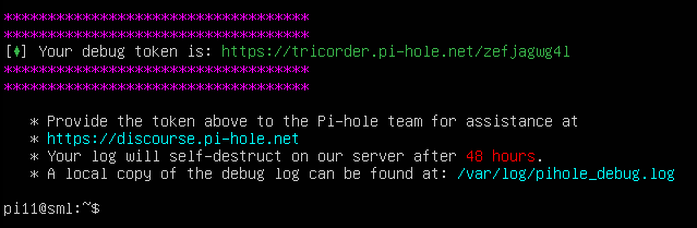

Worked Thanks
zefjagwg31
Just a FYI -- I don't think that tricorder.pi-hole.net responds to ping's even when working properly.
Thanks for the note, I don't remember disabling that ability, but it looks like you are correct.
Success!
