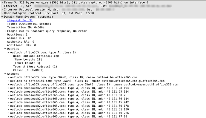

Screenshot of a working response:

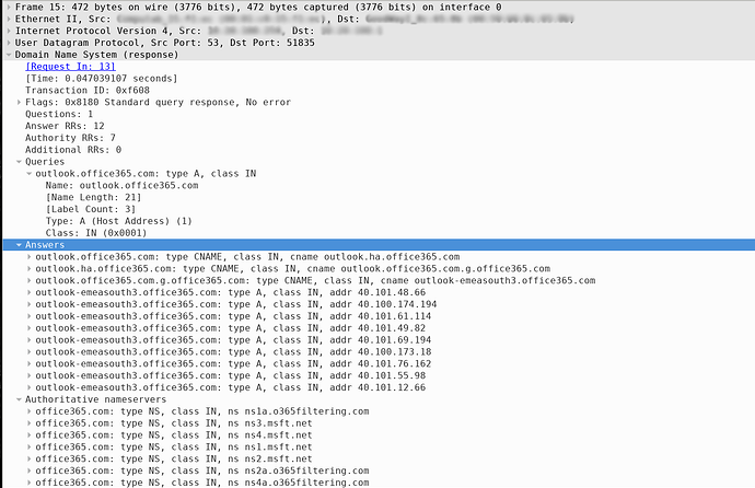

Screenshot of a non-working response: (working, but where my client is trying to initiate a DNS over TCP/53 to Pi-hole straight after receiving it, which is a little bit bigger than the first one) :slight_smile:

Thanks everyone, I found the issue!
Simply my iptables rules on my server not allowed to OUTPUT to TCP/53!
So I was right regarding the fact that the request/response was too large and so the client was trying TCP instead of UDP but my pi-hole server simply not forwarded it as iptables was blocked it!
