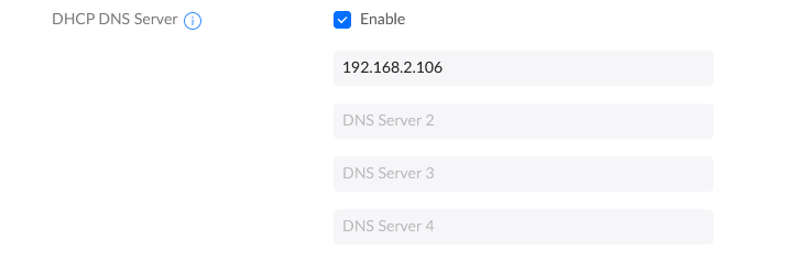

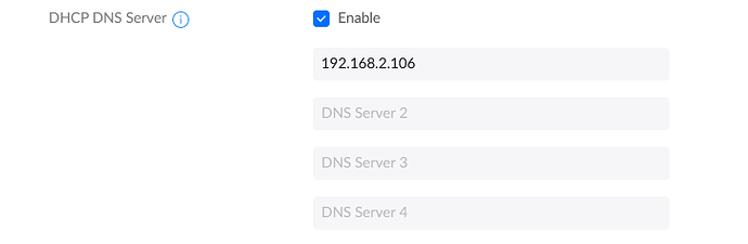

I am running pihole (version 2023.01.3) on a kubernetes cluster on a raspberry pi with a unifi dream router. In the unifi router I have set the pi as my DHCP DNS Server:

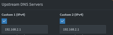

On my pihole I have set the router's IP as the upstream DNS server:

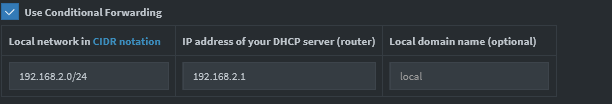

With local DNS forwarding activated:

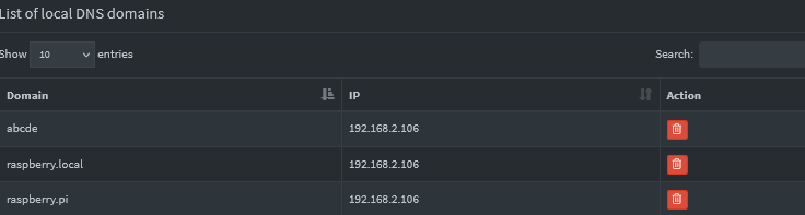

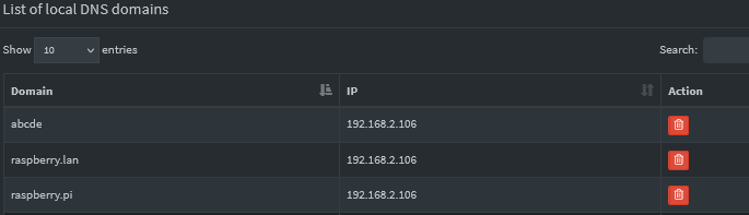

So I tried out local DNS config and set up a couple of DNS records like:
raspberry.local
However I cannot reach the pihole's site with the local DNS record. I can however reach it via the raspberry's IP address 192.168.2.106:6969/admin (yeah - changed the port to 6969).

Your debug log shows your DHCP server to correctly distribute your Pi-hole host's IP as DNS server:
   * Received 300 bytes from eth0:192.168.2.1
     Offered IP address: 192.168.2.223
     DHCP options:
      Message type: DHCPOFFER (2)
      dns-server: 192.168.2.106
      router: 192.168.2.1
Together, this would suggest that you've perhaps manually configured your aforementioned machine to use your router as DNS. Or that machine did not renew its DHCP lease yet to receive the updated DNS server information.
Revert your manual changes on that machine and/or get it to acquire a new DHCP lease from your router's DHCP server.

Conditional Forwarding is not required when you are using your router as Pi-hole's only upstream. All DNS requests will go through your router anyway. Just make sure you've unticked Never forward non-FQDN and also Never forward reverse lookups for private IP ranges in that setup.

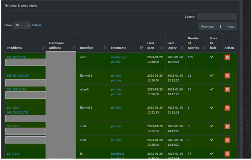

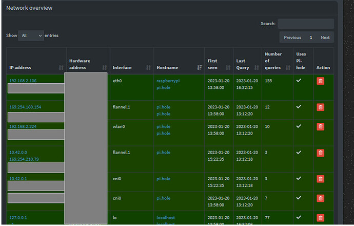

Even more irritating is that I would have guessed that my computer's / phones IP address would appear in the list of network which is not the case at the moment:
That is why I initially activated conditional forwarding...

Looks alright
nslookup raspberry.pi
Server:		192.168.2.106
Address:	192.168.2.106#53
nslookup raspberry.lan
Yes - and we won't need the log lines with that positive result. :wink:

Your redirecting idea made me thinking and I actually found a setting in the router where it said "adblocking" which was enabled :facepalm:
It is in the settings near traffic management.

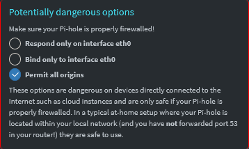

Deactivating it made it worse, at first. Then I realized, because of the different VLANs, I have to permit all origins.
Works now and can see the computer in networks tab...
Thanks for your help :+1:
