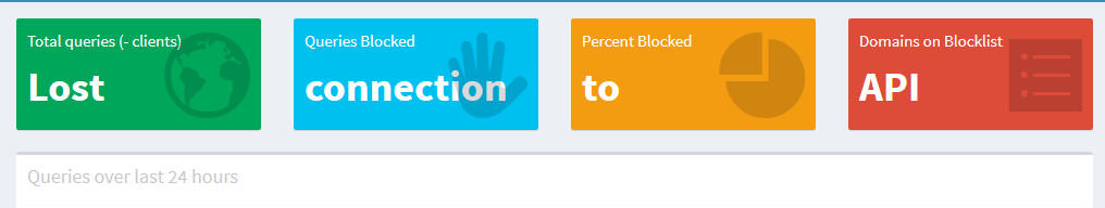

[i] Starting pihole-FTL service...pi@raspberrypi:~ $
It just stopped at the prompt. I can open a web browser and navigate to the IP or my Pi-hole install, but it shows me a "Lost connection to API" message:
