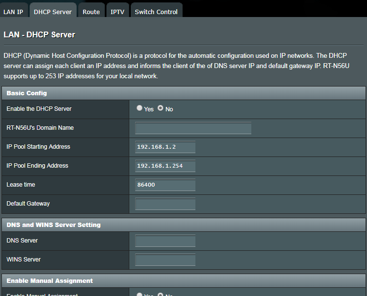

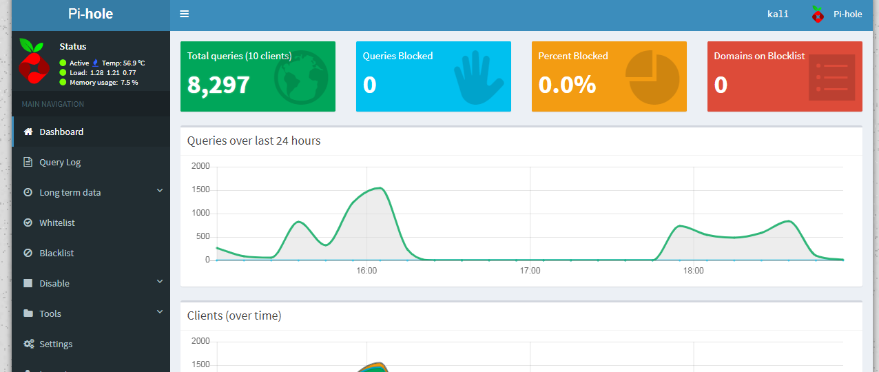

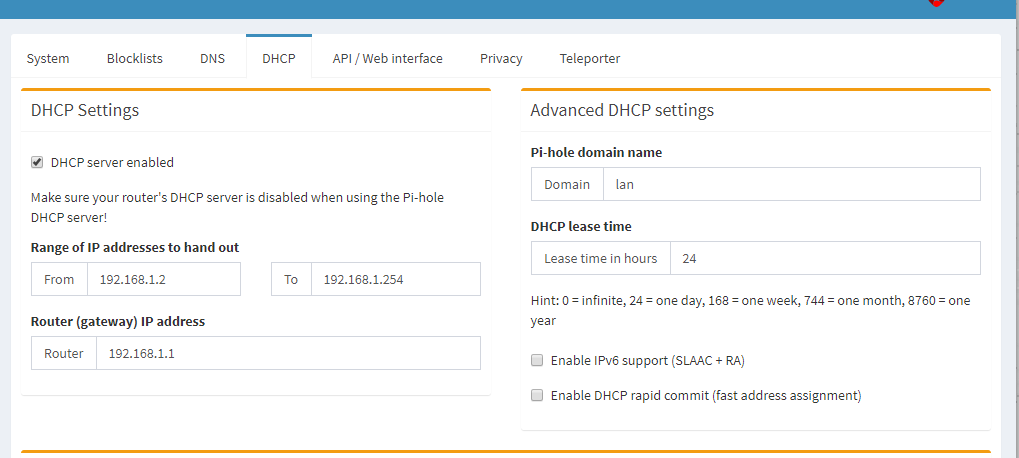

[But atually I can see 8.000 total queries and none of which is blocked. DHCP on pi-hole enabled, on router - disabled]
PFA screenshots attached

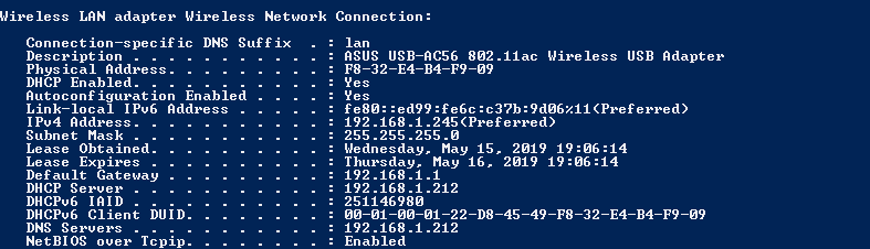

ipconfig shows the only DNS server and it's correct (PI's IP)

Take a look at the top-right of your first screenshot: you have zero domains on your blocklist.

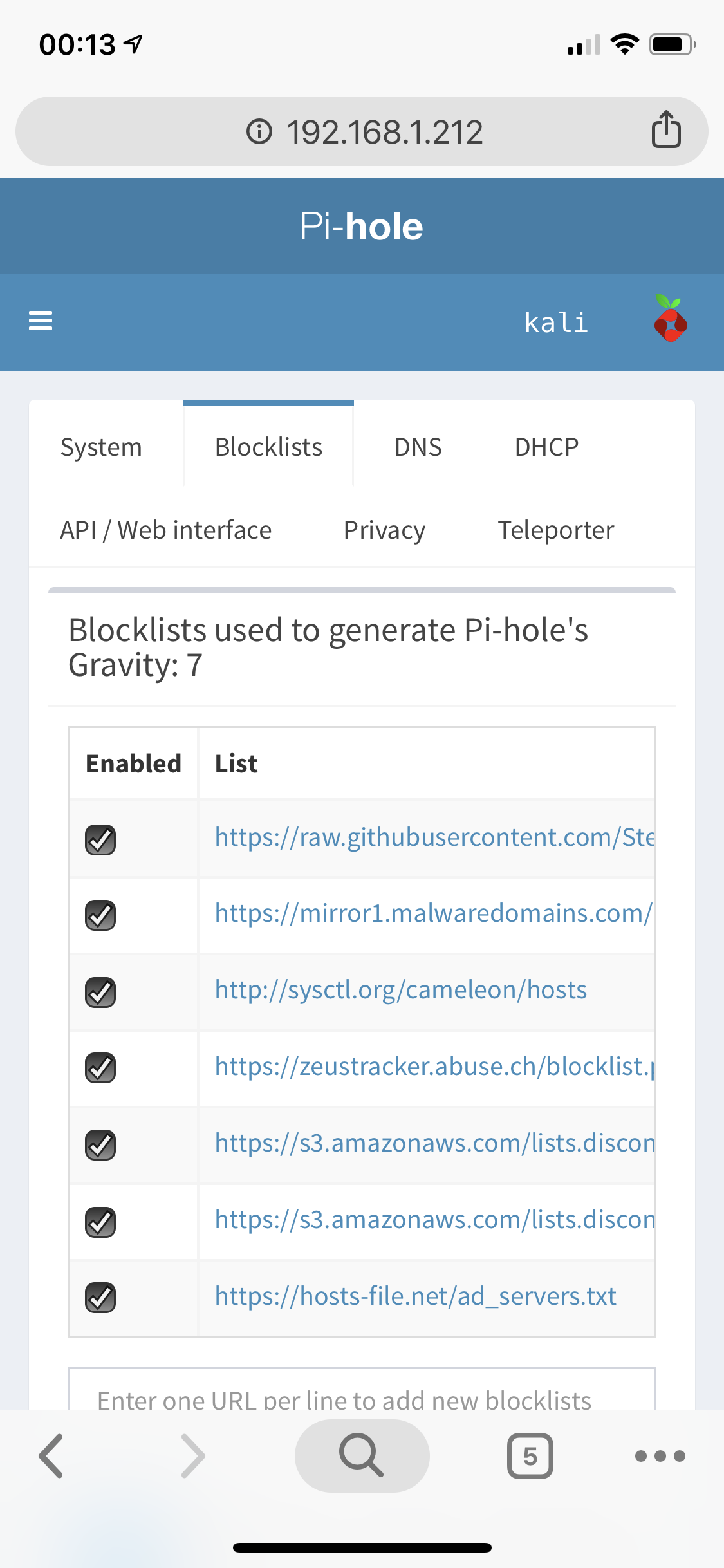

I guess if you visit http://pi.hole/admin/settings.php?tab=blocklists there are no entries, or the lists are unchecked.
If you have no entries add these lists to your blocklist.

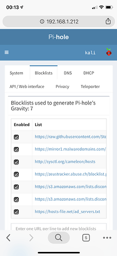

There are entries and all are checked
Eh, uncheck all -> check all solved everything. Thanks mibere.
