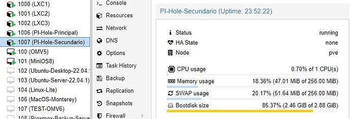

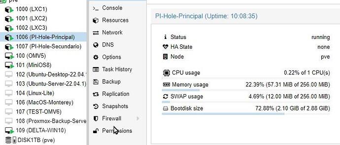

pihole´s proxmox instances
main pihole
secundary pihole

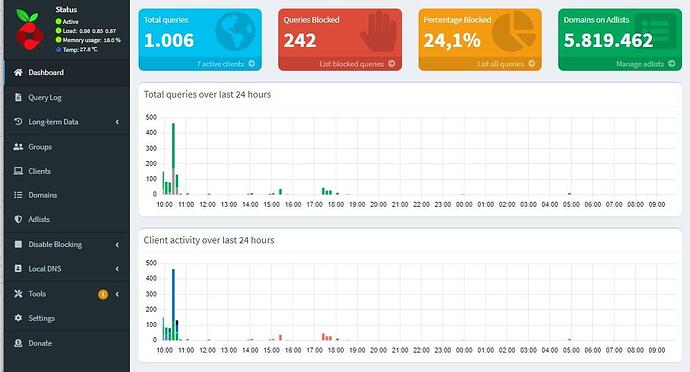

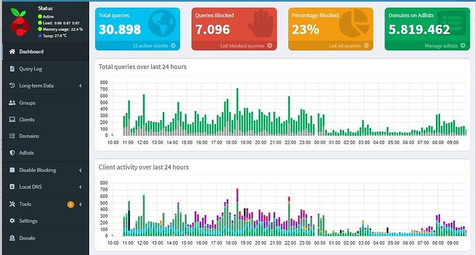

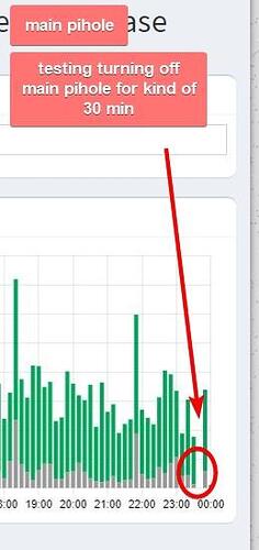

pihole´s stats
main pihole
secundary pihole

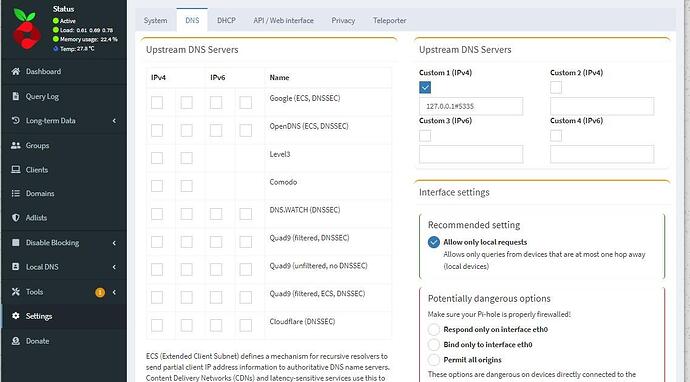

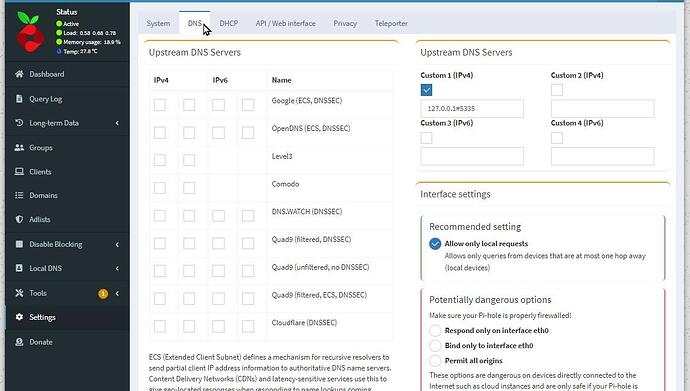

pihole config´s
main pihole
secundary pihole

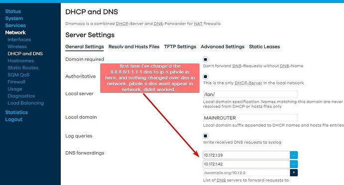

openwrt config: DHCP and DNS > General Settings > DNS Forwardings

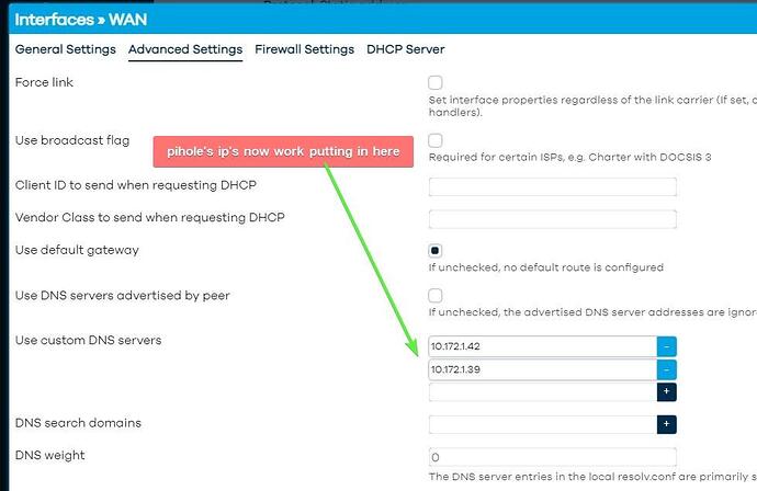

openwrt config: Interfaces > WAN 1 > Edit > advanced settings > Used DNS server advertised by peer and Use custom DNS server
(note: something strange happens here, the fisrt time when i put the pihole ip x.x.x.39 at the beginning and the secundary pihole x.x.x.42, the network took the ip x.x.x.42 as the main dns server and the x.x.x.39 as the secundary)

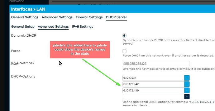

openwrt config: Iterfaces > LAN > Edit > DHCP server > Advanced settings > DHCP options

in case someone has this problem the answer and solution is here
