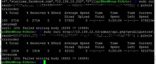

Another success brings another failure:
not sure if you got that tricorder upload or not, I'm not familiar with the curl error that occurred.
Yes, it uploaded partially. We apply a certain (not too high) limit on the amount of data users can put to our Tricorder server to protect ourselves from a few possible attack vectors. Hence, your data was cut off at some point and this is how curl reacted to this.

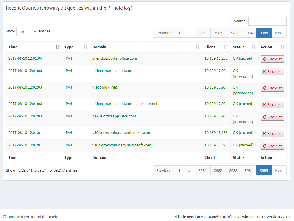

I'll now look at your data. Can you please also send a screenshot of your Query Log (possibly the last or second to last page you can see)?
I hope this is what you're looking for. I went to query log, enabled Show All, then went to the last page available.
Let me know if you need anything else, I'm standing by.
Thanks. What I can see here matches your uploaded API data perfectly. Any chance that you see somewhere the problem you have?
If the api.php?getAllQueries is showing exactly what the Query Log shows, then I have an example above (00:54:08)

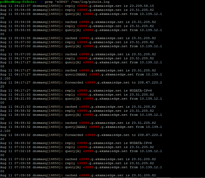

One other odd thing is, though, that your screenshot shows a domain e3843.g.akamaiedge.net which does not seem to exist in either of your uploaded files (pihole.log / pihole.log.1). It is possible that it was cut off during upload.
Could you please run
grep 'e3843' /var/log/pihole.log
grep 'e3843' /var/log/pihole.log.1
Okay, the problem so far was just that you grepped for the wrong time in the log. The time zone of your Pi-hole device is not correctly set up (or at least it is not the same as your local time zone). Hence, it logged the queries at 05:54:08 of its time which the Pi-hole dashboard (correctly) translated into 00:54:08 in your local time.

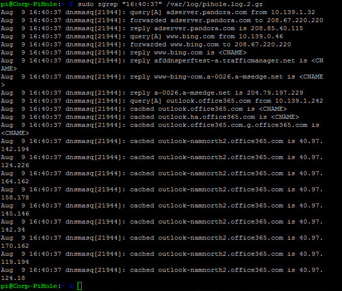

Back to the matter at hand... I tried to sudo cat /var/log/pihole.log.2.gz | grep "11:40" and got no results. I tried without grep: sudo cat /var/log/pihole.log.2.gz and the output was absolutely haywire. The bash went psycho and then ended up printing "PuTTyPuTTyPuTTy" over and over again in the prompt, so I closed out. Can you help me out with a command to handle this .gz file?
No worries :slight_smile:
I really enjoyed a laugh when reading the rest of your post. The file has been compressed, so we cannot expect readable output. Try using zgrep for compressed files.

So to be clear, this is relevant to the very first post on the thread. Remember, the first picture is the Query Log with Show All, searching for the phrase "ad" and sorted by URL. This screenshot does seem to show forwarding the query, though.
Are there any other ad domains being forwarded around that time?
Repeat the zgrep for adserver.pandora.com and hope for the best (that there are not too many results).
I've uploaded the result of "16:40:" to tricorder: kfj8pgiis
