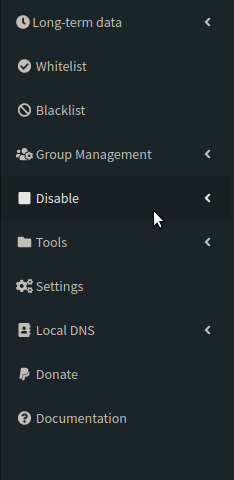

Side note: Blocking is disabled on purpose?
    BLOCKING_ENABLED=false

How/where do I disable this?
Oh- that was just me testing to see if it sped things up.
