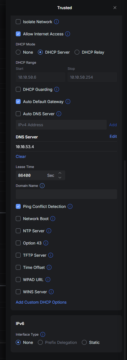

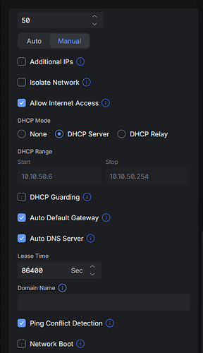

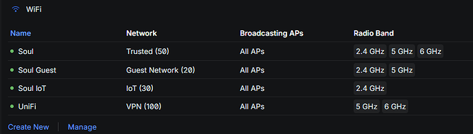

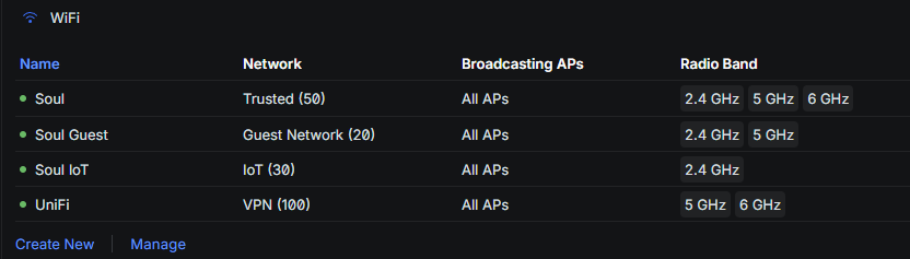

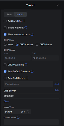

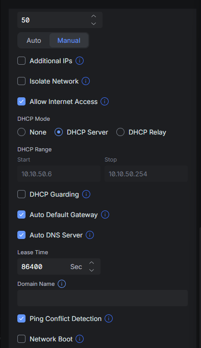

When I connect to the dedicated SSID which uses the VLAN 50 (Trusted).

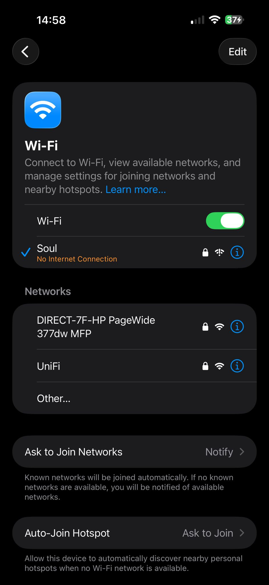

The DNS resolution is very slow or does not load anything at all. For example, when I click Youtube video, nothing in the apps load or when I search for something in Safari.

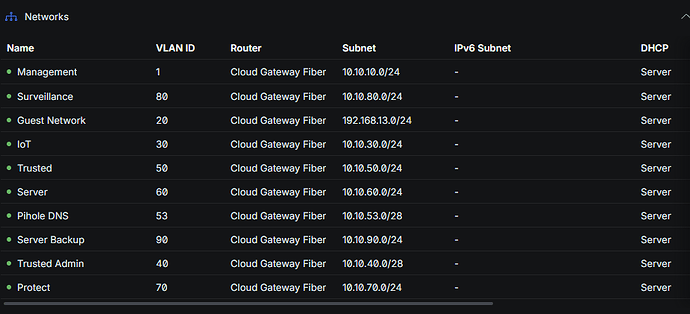

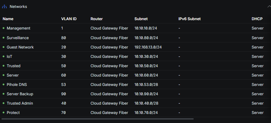

All the network are segregated so none of the subnets are linked.
The fix is to turn off Wi-Fi and reconnect, but after a while, the same thing happens.
When I disconnect from the Wifi and use 5G, everything works.
When I change the DNS on the iPhone to point to another DNS such as 1.1.1.1, it is back to full speed. When I revert it back to pihole IP 10.10.53.4, everything is at snail pace.

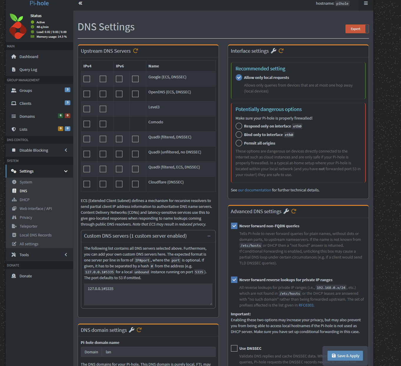

Within pihole, I have set the interface setting to “Permit all origin” to talk to all the subnets.

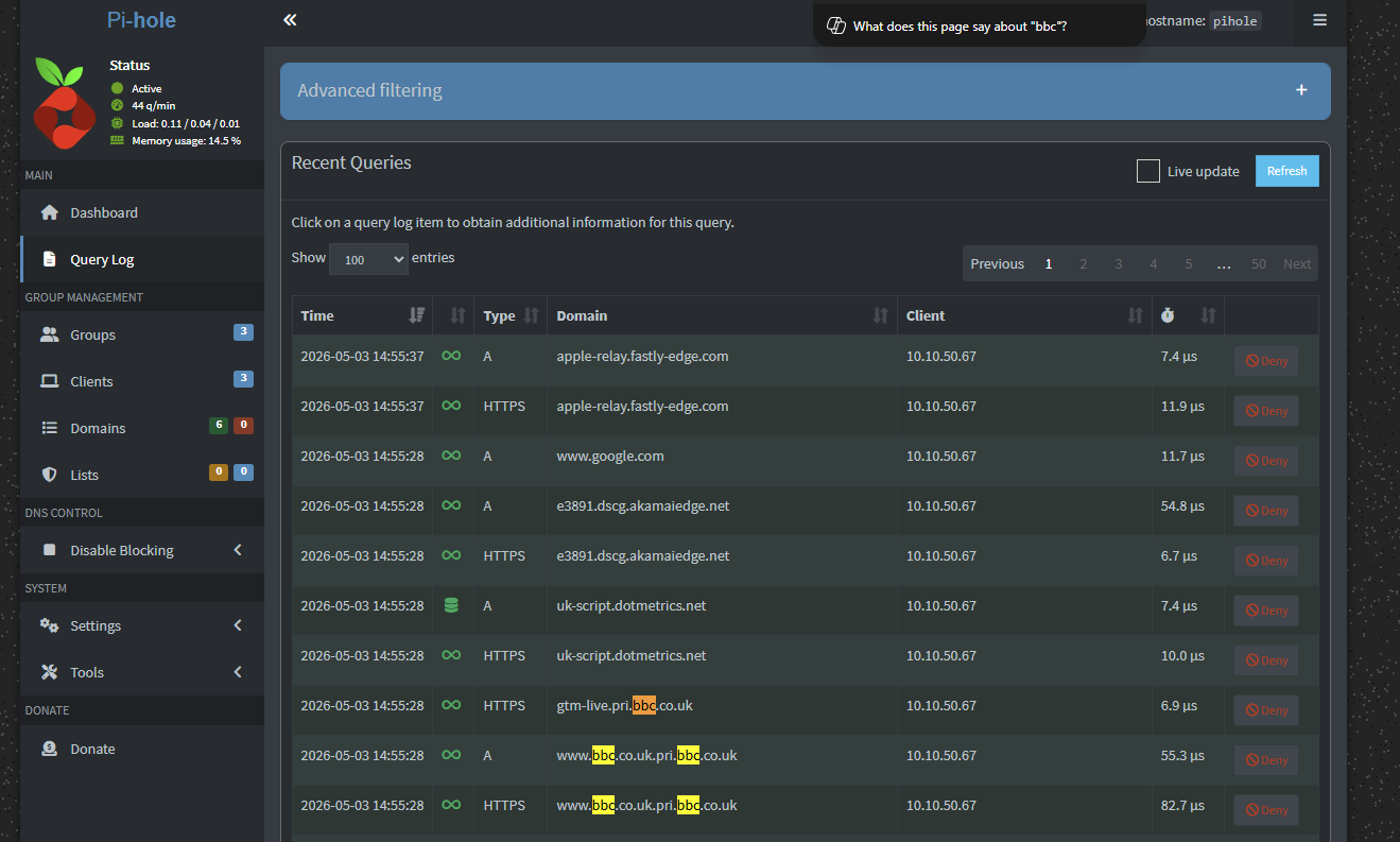

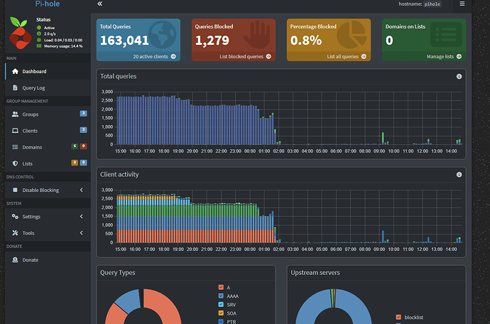

I can see all the mobile / tablet device are appearing correctly in the main pihole portal.

Your pihole.toml has a few entries that might be slowing things down:
You have both a localhost:port upstream and a remote WAN accessed upstream. That can cause issues as dnsmasq and thus FTL will use any of the upstreams, there is not primary/secondary or failover pattern. FTL will query all the listed servers and use an algorithm to determine the best upstream to use. That check happens frequently so the preferred upstream will change often.

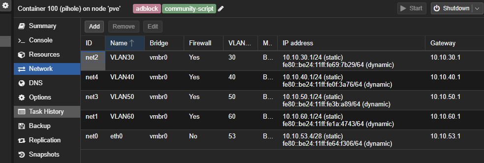

You have dns.interface set to only eth0 but your interfaces are named VLANXX. Try un-setting that interface to empty, which is the default. I'm wondering if the DNS packets are being forced through the eth0 from the VLANs coming in and going out.
Your dns.listeningMode can be LOCAL instead of ALL since LOCAL will check the subnets of each interface and allow each subnet to have access.
I see a failure on the remote IPv6 resolver test, check your IPv6 lan config and adjust or disable as you see necessary.

I checked the Custom DNS servers section within pihole and it should be default?
Am I looking in the right place?
Can you elaborate on the this part?
Are we talking about removing the VLAN name I have within the pihole cluster of proxmox?

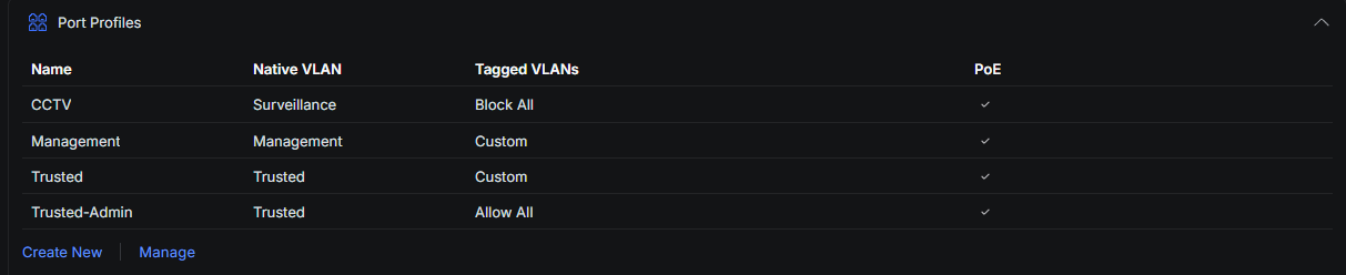

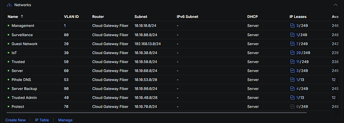

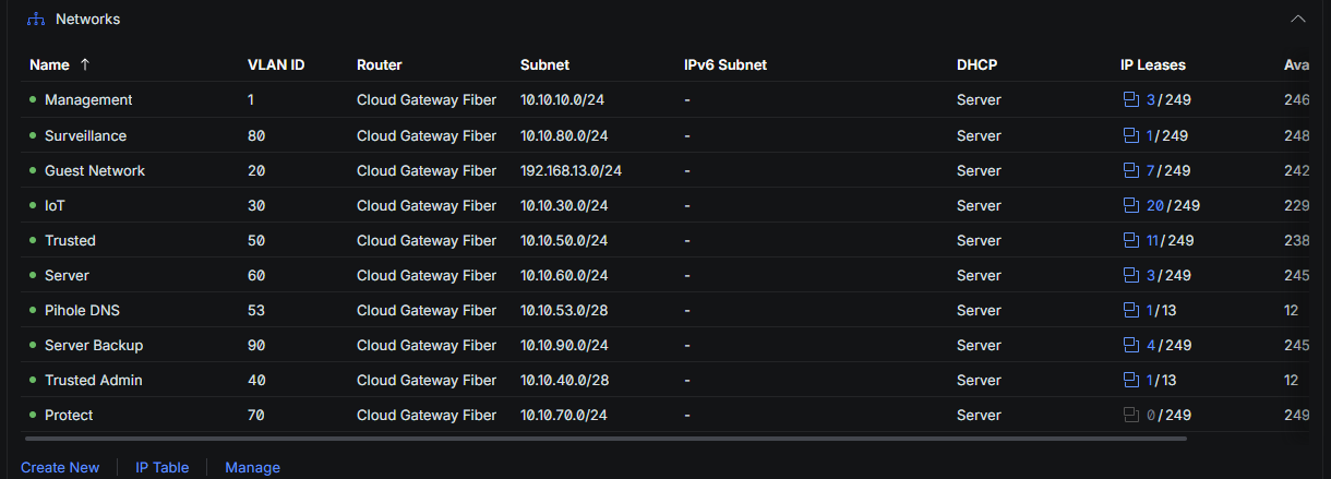

Currently my whole setup, I have everything segmented with network / firewalls on Ubiquiti.
The Proxmox lives in VLAN 60 (Server) and I have VLAN aware enabled to have pihole on VLAN 53.
The other VLANS I wish to have pihole blocking ads are added into pihole proxmox network section.

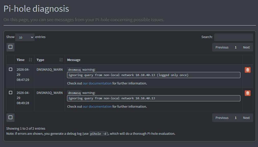

I can see the error you mentioned earlier:

I did a quick google and found an article that is talked about dns.interface DNSMASQ_WARN warning notification in Pi-Hole v6 - Help - Pi-hole Userspace
The dns.interface is a whole separate page within pihole. its located in system > settings > all settings.
I removed eth0 from dns.interfaceand rebooted proxmox and can confirm the wifi works now and I can watch stuff on youtube without any problem nor have "No internet" warning message.

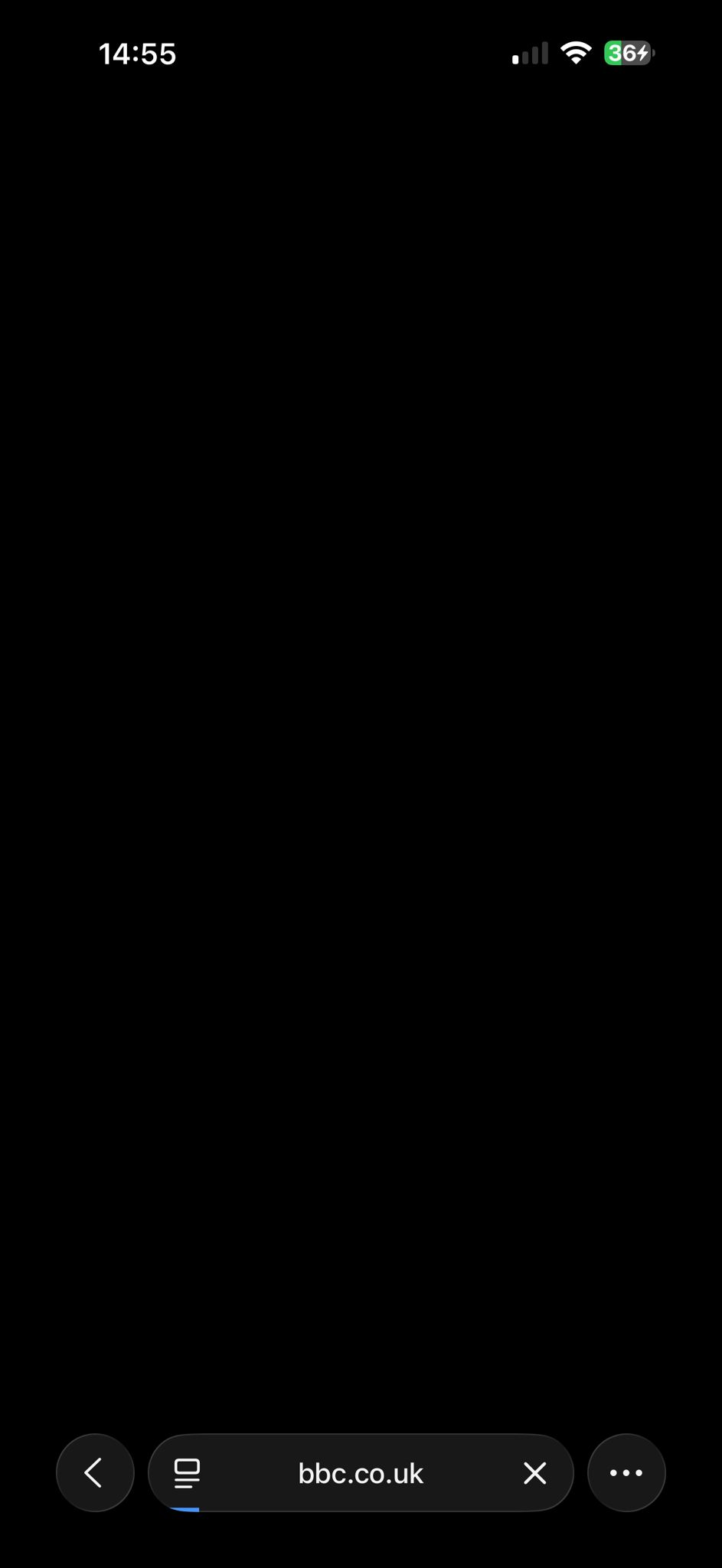

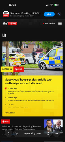

I have been using the WiFi and its still a hit and miss for YouTube. Sometime it loads the video and sometime I have to wait for connection to be established.

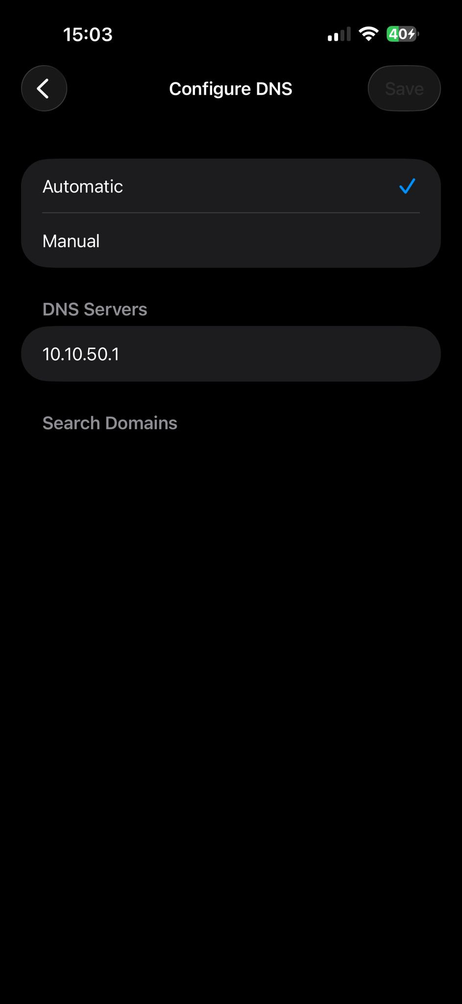

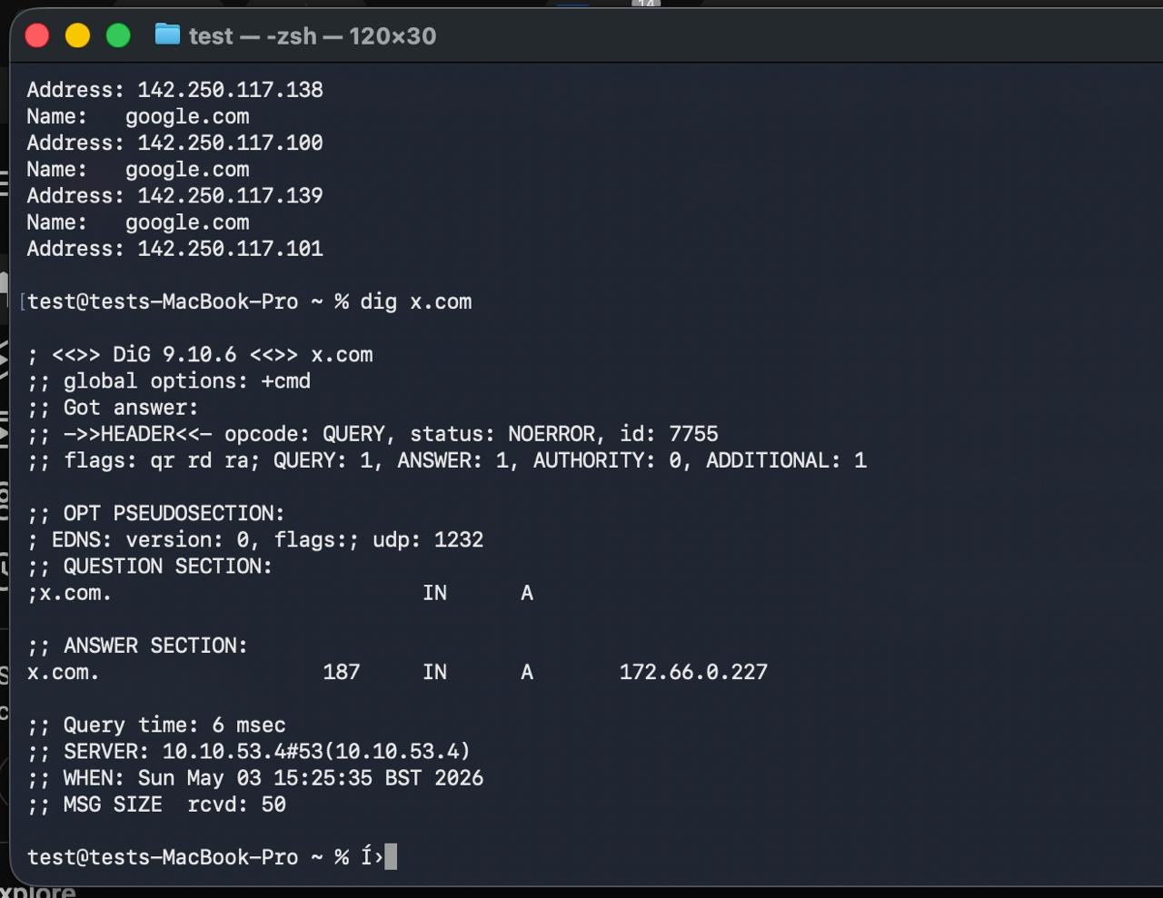

The iPhone 16 Pro Max is an example. The IP address is 10.10.50.67
Your debug token is: https://tricorder.pi-hole.net/MEanuyzo/
But does it eventually load or not ??
YouTube is horrible to test with these days because they are basically "discriminating" adblocking users and show all sorts of false notification/errors that eventually have ZERO EFFECT on your experience :facepalm:
Nope, nothing loads. Even when I use safari to search up something.

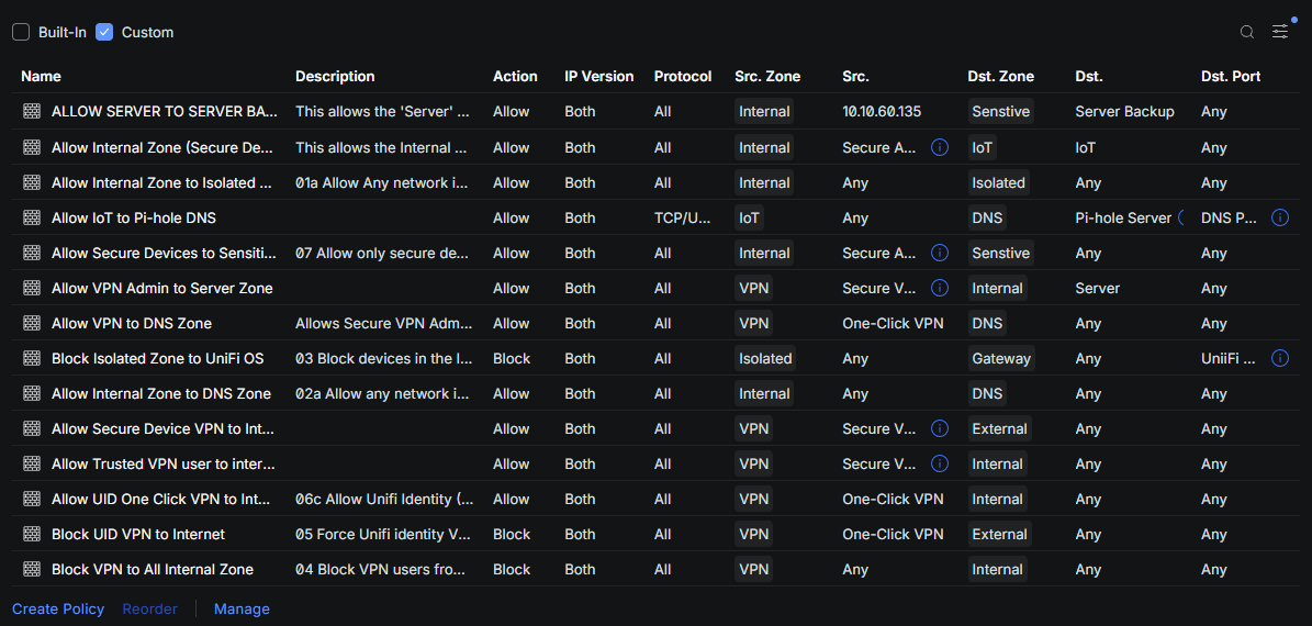

I have reverted it back and stopped Pihole on VLAN 50 and everything works again.
Okay, can you do a quick update with what is configured and what the results or lack of results you see with that configuration?
