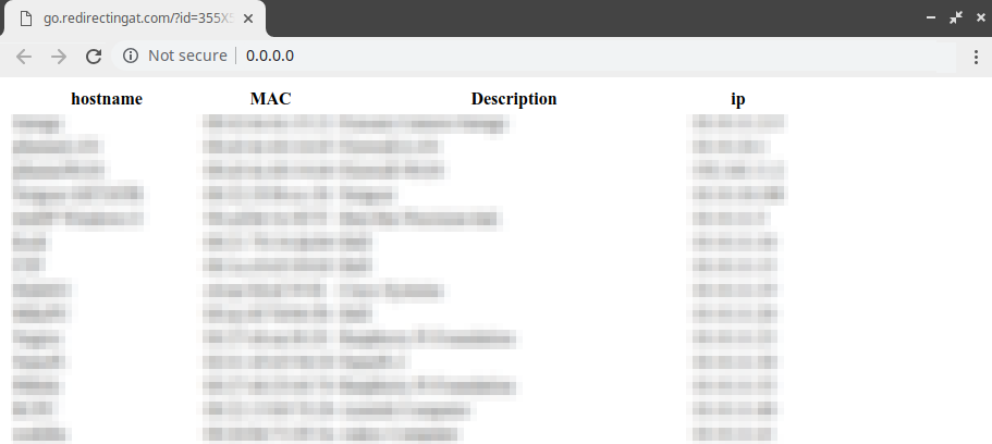

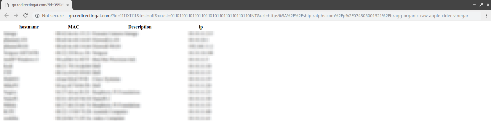

If I go to the Slickdeals website and click on a deal then the "see deal" button, I instead see a full table of all of my network hosts (hostname MAC Description ip)
This is an example of the URL in the URL field, when this happens:
http://go.redirectingat.com/?id=321X432&test=off&xcust=abcdefghi123456zyxwvutsrdINT&url=https%3A%2F%2Fship.ralphs.com%2Fp%2F074305001321%2Fbragg-organic-raw-apple-cider-vinegar

Can you provide a screenshot of what you see?
Bingo. Somehow 'go.redirectingat.com' is being sent to 0.0.0.0 - which gives me the host table.

Please post the screen snap of what you see on your browser.
Screenshot attached
That is not a Pi-hole page. Perhaps your device is interpreting 0.0.0.0 as another device, and that device happens to return that DHCP info.
That's possible, yes I suppose.
I can see the same table, if I type 0.0.0.0 so, it appears you are right - something else on my network is serving this up. I'll check out my pfSense config as I suspect that may be the culprit. You guys have been really great - I sincerely appreciate the help.
