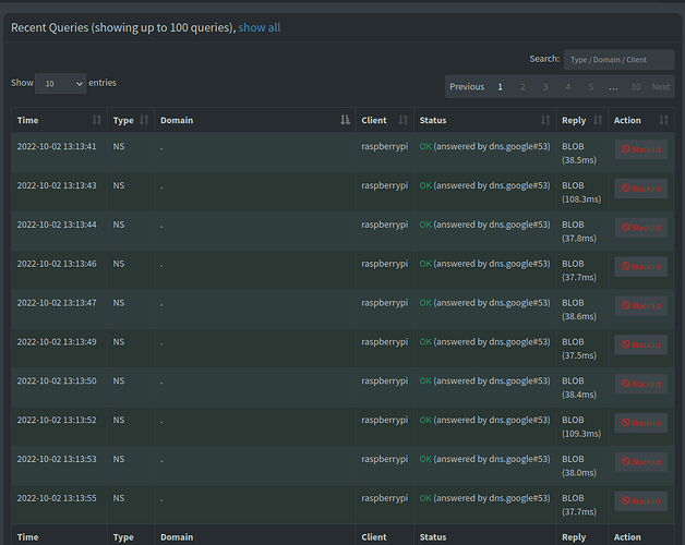

Single dot domain/DNS root zone query issue with containerized wireguard
One idea sprung to mind, maybe you can localise more closely where the truncating is happening in the chain.
You just have to query a DNS server for a record that is local to the DNS server (doenst need to be forwarded) and see if it gets truncated.

You can also try nslookup -type=NS . 1.1.1.1 and it should truncate. So issue is specific to cloudflare's DNS
Yes I get the same results as you with nslookup.
But am not sure what nslookup does under the hood.

Excessive dot queues aren't stopping even if I directly select google dns from pihole. But at least reply is now different (BLOB vs NODATA that I was getting from cloudflare).
Oct  2 13:13:28 dnsmasq[3301]: query[NS] . from 172.18.0.1
Oct  2 13:13:28 dnsmasq[3301]: forwarded . to 8.8.8.8
Oct  2 13:13:28 dnsmasq[3301]: reply . is <NS>
Oct  2 13:13:29 dnsmasq[3301]: query[NS] . from 172.18.0.1

I got it fixed by binding the DNS listening port to the pihole node local address in the docker-compose file of Pi-hole,
in my case - "192.168.50.11:53:53/udp" instead of - "53:53/udp".
I am not sure why this solution worked. Solution was linked by someone on reddit. I have also added this in my reddit post liked above.
