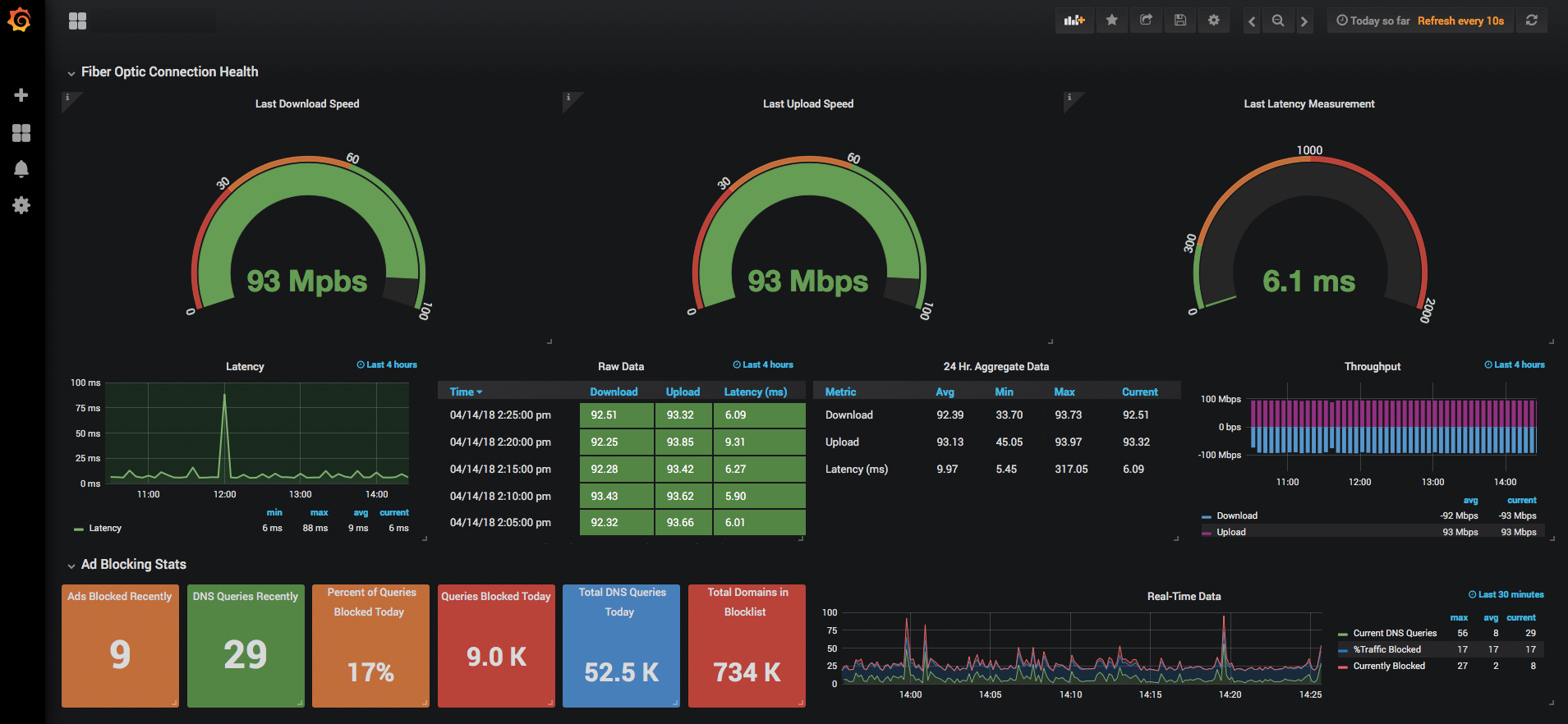

That said, I simply use my TI(C|G)K Stack env., and setup dedicated probes & dashboards for monitoring everything...
