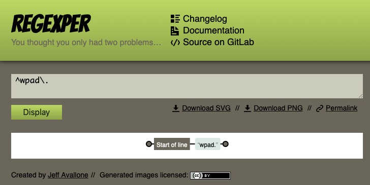

^wpad\.
(^|\.)localdomain$

Here is a handy site for diagramming your regex expressions.

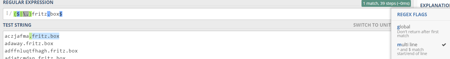

I have added ($|.)fritz.box
because i found lots of different domain names in the log ended in fritz.box
I'm not sure what you're trying to achieve. Why did you start the regex with an end of string expression ($)?
But then you should escape the period:
fritz\.box
plus this one to perform the check: https://regex101.com/

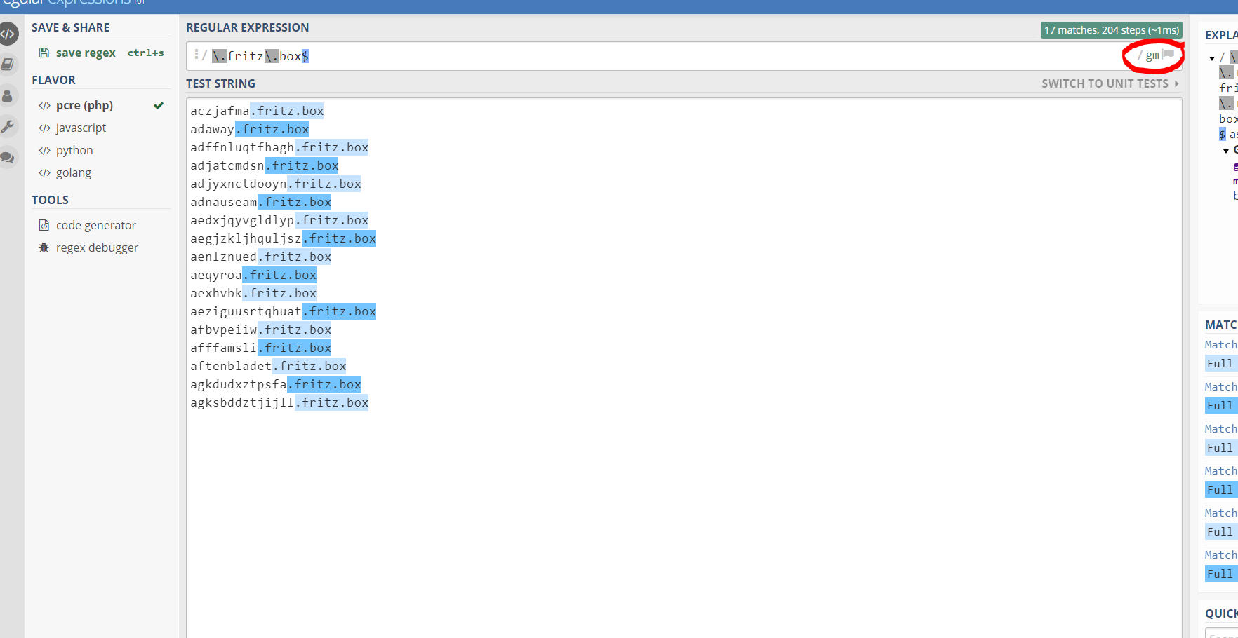

\.fritz\.box$

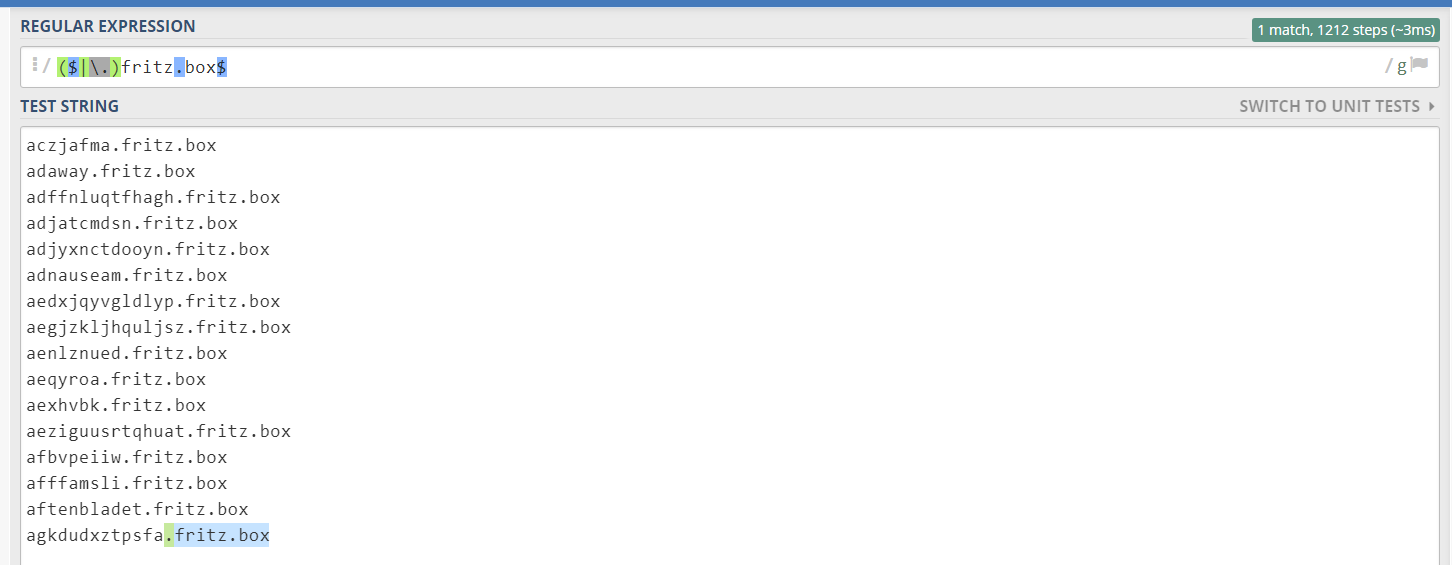

thanks, but this is the result at regex101.com

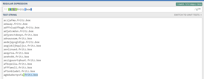

There is something with the flags on the right in the red cirkel, how to interpret these ?
Why "but"? On the right hand side you see "Full match" multiple times. Job done.
On both seperatly, 1 match, both on is the printscreen from my previous reply
If it is allmatch, does it mean that all is blocked AndrewZ ? that is what i want.
I have 1200 queriesnames to fritz.box
Once you use the right syntax - all of them should be blocked, I believe you can easily test this.
ok, that sounds good, thank you for the help !
