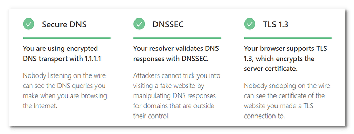

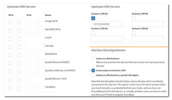

HELLO,
I want to share dnscrypt-proxy-pihole
It is a debian package for Raspberry Pi which installs dnscrypt-proxy configured for DNS over HTTPS with Cloudflare DNS servers and Pi-hole.
More info here: GitHub - mapi68/dnscrypt-proxy-pihole: Preconfigured deb package for every Raspberry Pi and Pi-hole to use only best DNSCrypt, DNS-over-HTTPS and No-Log servers
Isp can still see what domains you go to :roll_eyes:
Use VPN
@anon55913113 Why?
@anon55913113 Traditionally, DNS queries are sent in plaintext. Anyone listening on the Internet can see which websites you are connecting to. To ensure your DNS queries remain private, you should use a resolver that supports secure DNS transport such as DNS over HTTPS (DoH) or DNS over TLS (DoT).
After you get the encrypted DNS transaction completed and have the IP in hand, you immediately send that IP to your ISP in clear text and request that they connect you. It is not difficult for the ISP to figure out where you are browsing.
If you use a VPN service they see the same.
They have it to inspect.
