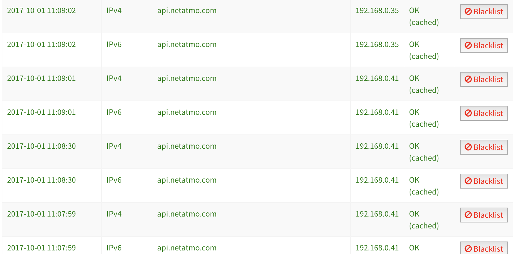

I have a lot of these api-calls, but i want to know the whole url
https://api.netatmo.com/api/setthermpoint
https://api.netatmo.com/api/getthermostatsdata
https://api.netatmo.com/api/gethomedata
https://api.netatmo.com/api/geteventsuntil
Unfortunately, this is technically impossible. Your clients do only query the host name and never tell the DNS server the full URL.
You can see this also as a security feature - why should you tell e.g. your ISP's or Google's DNS servers the full path of what you are visiting?
