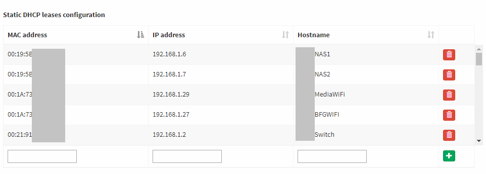

i have 33 defined static entries and they all show like this:
With a scrollbar.
that's because you just have 1 MAC address per host. When you use an extender it change the MAC address so you have 2 MAC address per wireless client and in setting/Web interface you can change remove the boxed layout

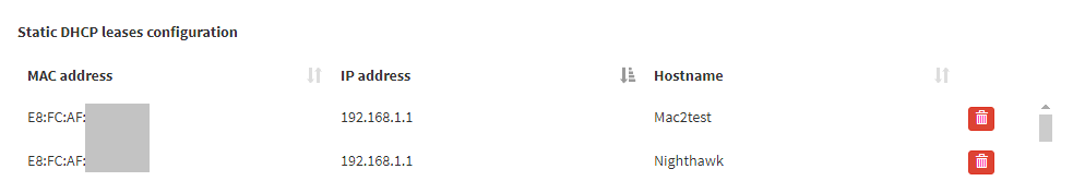

It shows like this on my side after adding a different mac for the same IP:
you can have more than 1 MAC address on the same line.

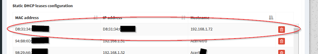

Could you improve displaying static entries with more MAC addresses in admin UI (Settings > DHCP)? For ex. this is valid 04-pihole-static-dhcp.conf file entry:
dhcp-host=00:11:22:33:44:55,66:77:88:99:aa:bb,192.168.1.12,laptop
Issue is that second MAC address is displayed in IP address field and Hostname field shows IP address. Hostname part is not shown at all. Inserting such entries through UI seems to work fine and I hope you keep it that way (not limiting to single MAC address).

I'm using pi-hole as DHCP server with all my home devices reserved IP addresses. Some devices (like Roku player for example) can be connected via Wired or Wireless connection (with different MAC addresses) however it is the same device and I would like it to get assigned the same IP.
I managed to achieve this by modifying directly
/etc/dnsmasq.d/04-pihole-static-dhcp.conf
changing the line for my Roku to
dhcp-host=D8:31:34:22:22:22,D8:31:34:22:22:23,192.168.1.72,RokuUltra
and it works great. I switch from wired and wireless on my Roku and back and i get the same IP. However on the pi-hole UI it looks like this:
I have other devices with Wired OR Wireless connection (never at the same time) and I would like to be able to manage this through UI.
